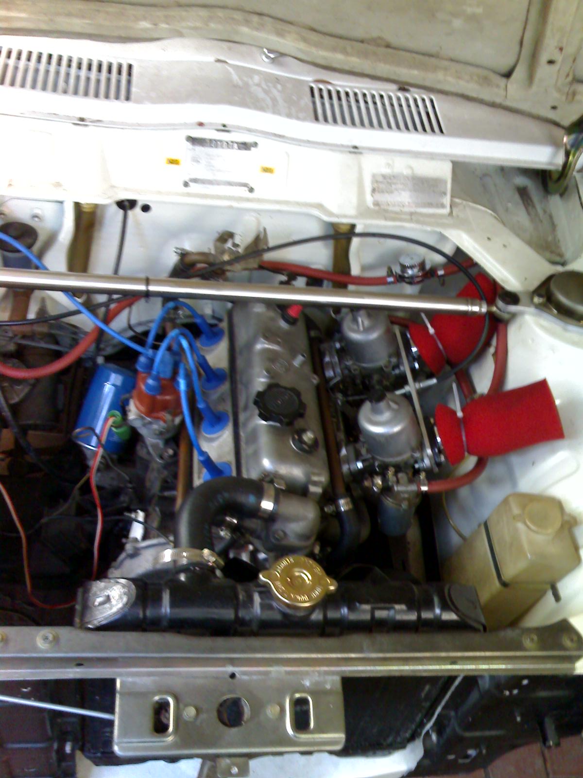

Actually i have a balancer at the moment as that is already done i think i sould be able to tune it myself with some help from mate to desifer what is exactlly going on so i should be able to tune her myself all i need is his dyno and sniffer.
I purchased all my ram tubes and filters from, and i know I'm going to get laughed at but autobarn frankston. tubes were $60 a pair and the filters were $40 i think. but the do look awesome. And a tip to people do not use oil on the filters as it made my that rich it almost didnt run carbie screwed full lean and it still smoked like a claped out diesel. I think though i may use the paper filters like corolla kids as i have some clearance issues. once again thanks for all you info guys.

Thanks for all help have her with sync, ear and pulg readings got fairly close.
also a quick question was wondering what needle and mainjets anyone uses for my type of application. Ihave no 5 neeldles and the .090" mainjet.
