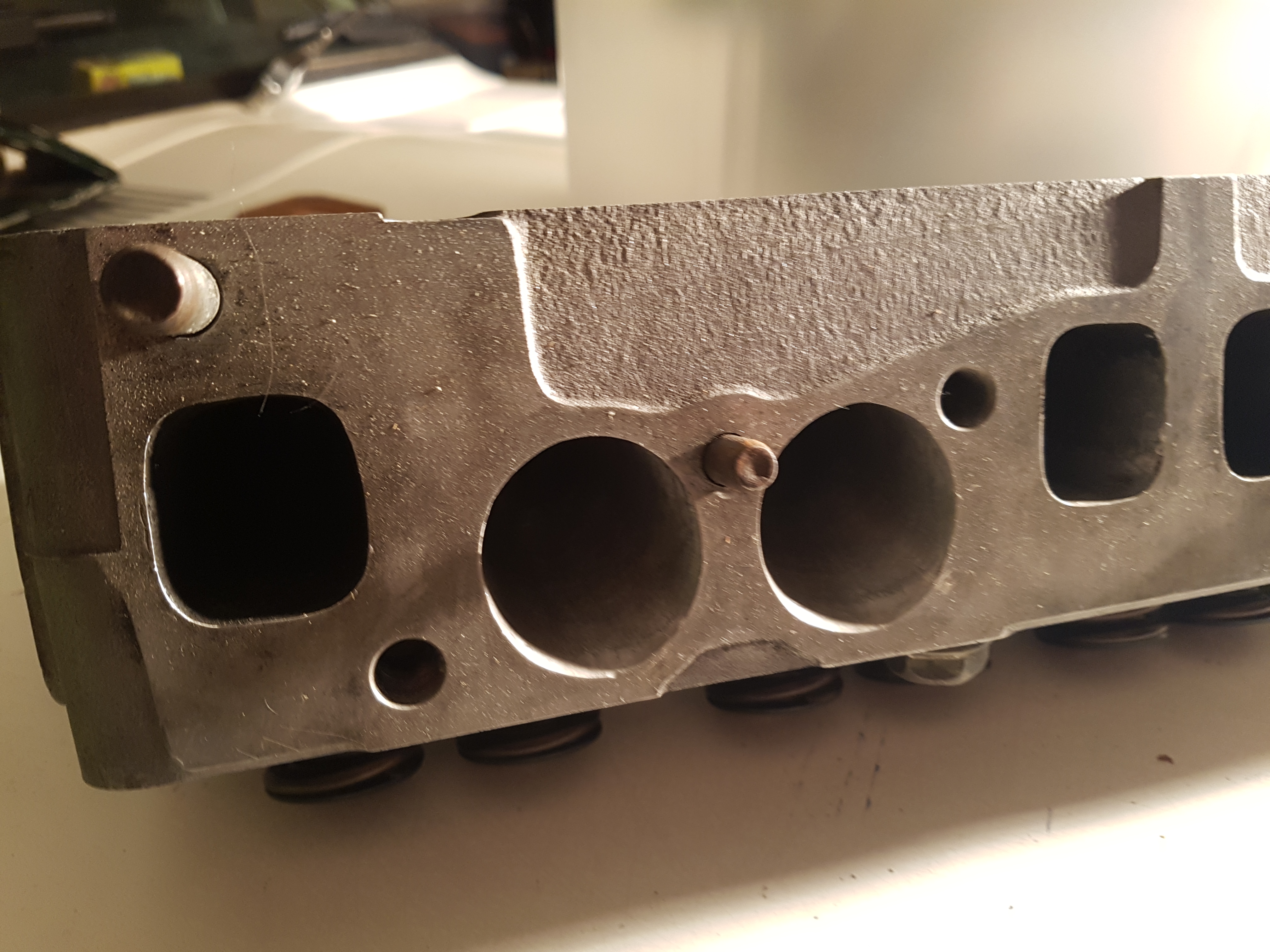

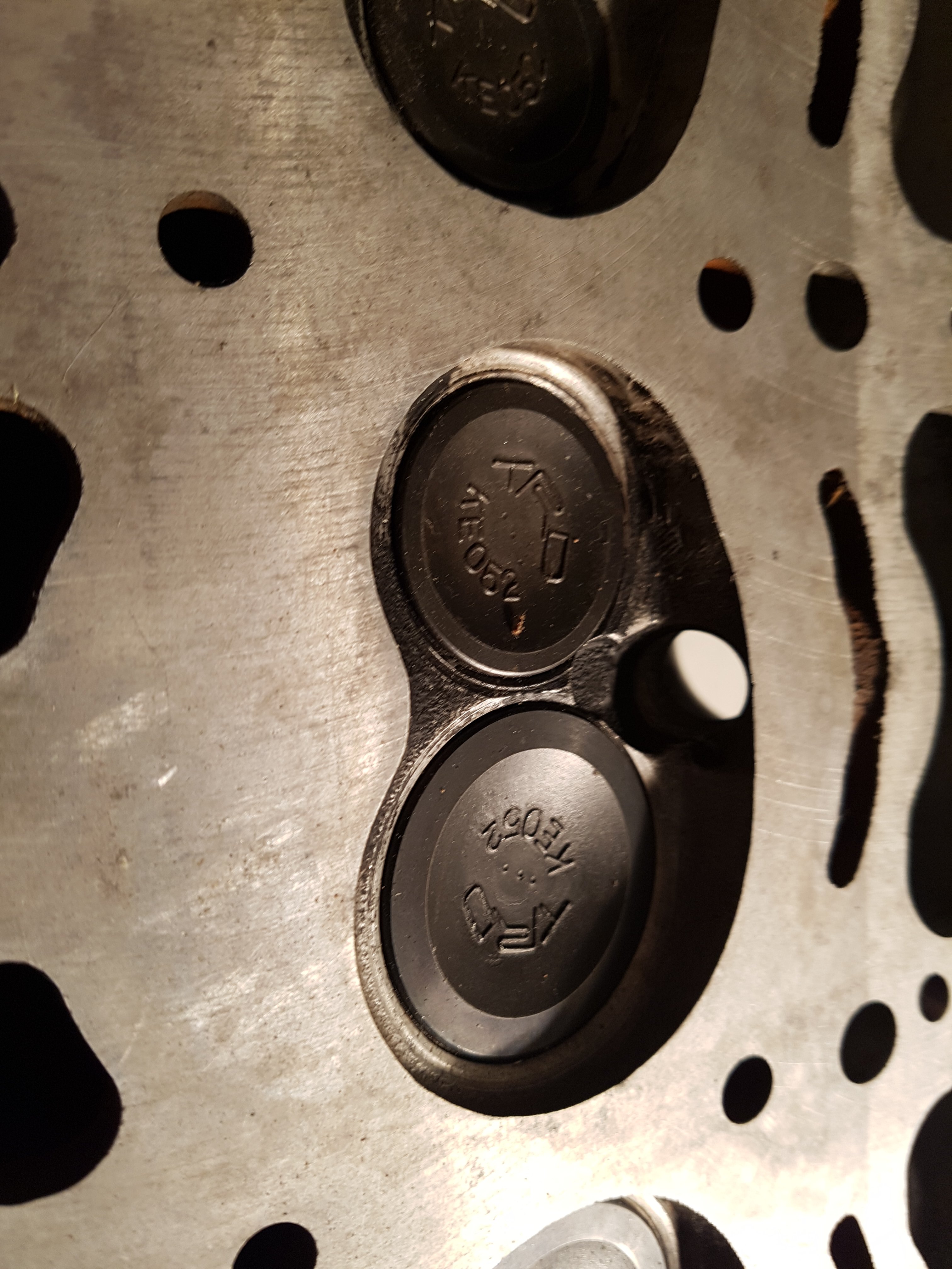

kickn5k Posted August 18, 2017 Author Report Posted August 18, 2017 Just realised I don't have any photos of the TRD head on here. Valves are 38mm and 30mm head size. Ports are 38.5mm by 36mm on inlet and 30mm by 27mm on exhaust. 1 Quote
