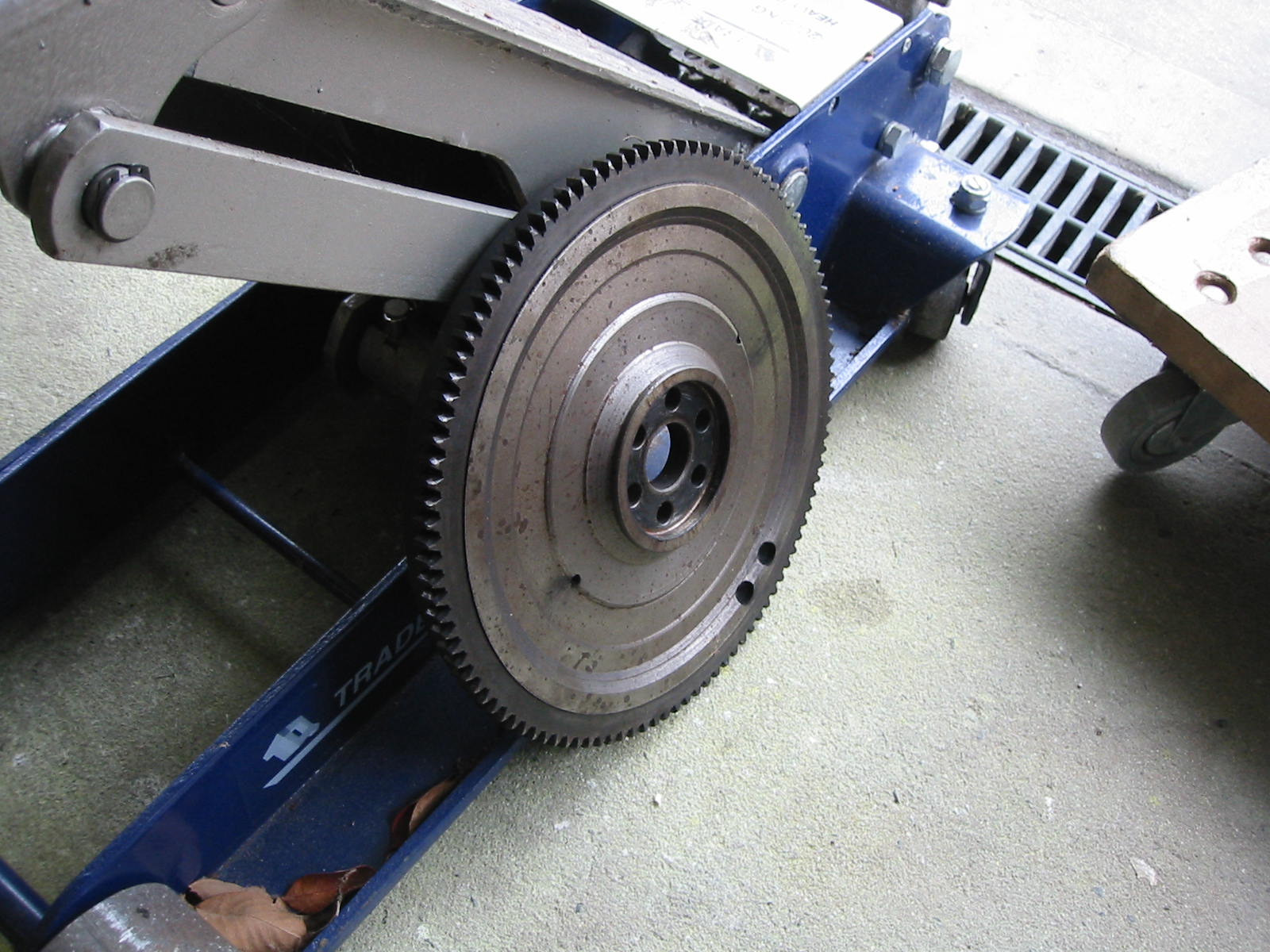

terryw Posted September 13, 2006 Author Report Posted September 13, 2006 it certainly is.....not put in yet, but I am hoping for great things from it. I thought I would get a steel flywheel as there is no protection at all for my legs if it lets go. And they rev quicker which makesa big difference in a flyweight car (400kg!) Quote
