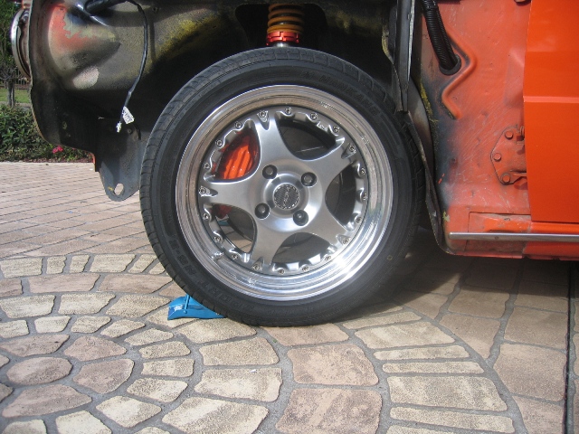

ChrisGT Posted June 21, 2007 Author Report Posted June 21, 2007 the wheels are prime, i was looking at them a while ago, can you tell me what they set you back? yeah I'm very haapy with the look of the wheels just have to drop it lower now, i bought the wheels off a guy on ae86drivingclub...they are overrated as only one little scratch, he reckons he paid $2500 for them. I got them off him for $1050 derlivered with 70% tred on front and 20% on rear. sweet job looks great keep it up :jamie: what did you have to do to the struts for the mr2 inserts to fit? the mr2 struts are rear ones, and they fit stright in, however they are shorter than a corona one so you either have to cut your struts down, use a spacer or both. I just used a 20mm spacer on the bottom of the insert and the corona gland nut. That seems to work fine, if i cut the tube down the car will end up too low. Quote

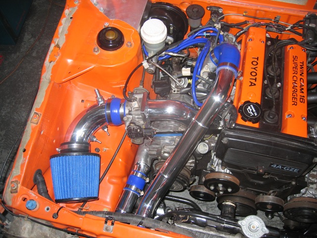

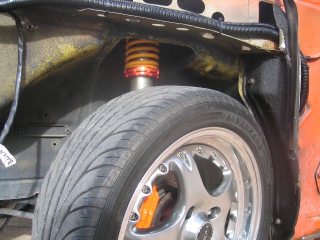

ChrisGT Posted July 1, 2007 Author Report Posted July 1, 2007 thanks for the comments. Its getting close to starting it now. I have now put the front struts in, the car sits really well and when I'm able to drive it i will lower it as much as i can: Also the car is currently in the exhaust shop getting the intercooler pipe work done, throttle body/sc inlet pipe and exhaust done. Once i get it back i will then try and start it. I'm going to get rid of the cannon and get a 3inch dump pipe. I also respryed the tail light surrounds black, and polished the chrome Quote

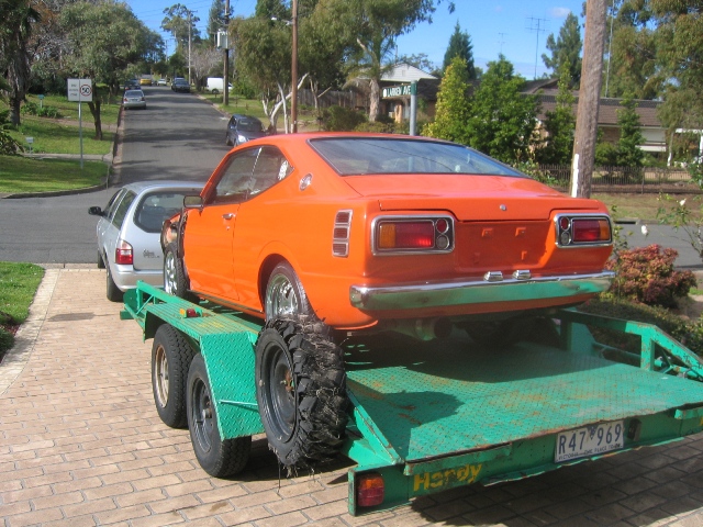

Kebin[RL] Posted July 3, 2007 Report Posted July 3, 2007 ooooo sexy wiring around the the front guards :lolcry: Damm that trailer must do crazy burnouts! :no2: Quote
LittleRedSpirit Posted July 3, 2007 Report Posted July 3, 2007 Damm that trailer must do crazy burnouts! :lolcry: lol. Just what i was thinking. This is a great build. Well done to you. Quote

ChrisGT Posted July 20, 2007 Author Report Posted July 20, 2007 The car will be finished at the exhaust shop tomorrow! Here is a pic of the SC and intercooler pipes: Its also getting a full 2.5inch mandrel bend exhaust with 3.5inch dump pipe. More pics to come when i get it back! Quote
