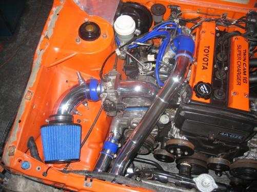

JedzWagn Posted March 10, 2013 Report Posted March 10, 2013 Hey Chris, read the whole thread buddy, Awesome work on everything.. as someone else said, good to see things being done right! Love that colour orange - what is it? Did the box over your pod filter quieten down the intake noise? I was suprised at how much whine the super charger makes in kebiin's vidz. Hoping I can get mine to run quieter than that ..maybe just sound deadener under the bonnet for a start. I'm figuring out A/C,power steer and alternator wheels on my GZE at the moment (going into AE95) If only I had kebiin down here to do my wiring! :elvis: Like the guys have said already ..get some pimpin' shots down by the beach at sunset etc.. great car! Quote
