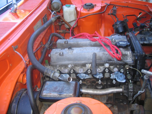

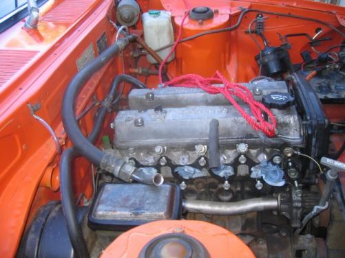

ChrisGT Posted August 20, 2006 Report Share Posted August 20, 2006 As some of you may know i bought millers ke35 coupe off him a couple of months ago. I'm gonna put a ae101 4agze with sc14 in it. I have already pulled out the 4k and started to fit the 4a, gonna make some custom engine mounts: watch this space for all the progress! Quote Link to comment Share on other sites More sharing options...

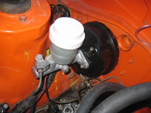

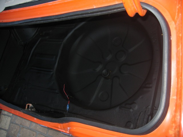

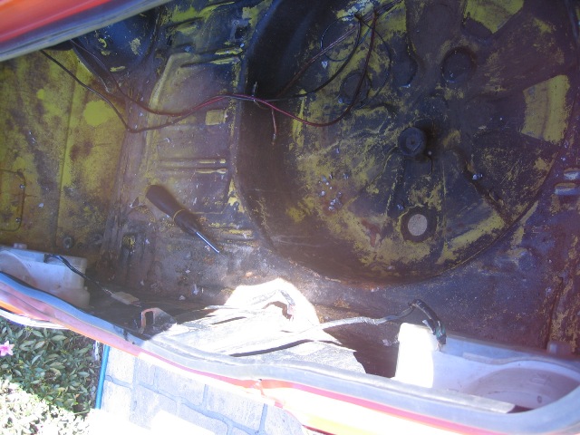

ChrisGT Posted August 20, 2006 Author Report Share Posted August 20, 2006 some of the work ive done so far: The boot had a fair amont of surface rust so i fixed it all up and painted it Before After the ke30 brake booster and pajero MC all cleaned up and ready for the hilux 4pots! Quote Link to comment Share on other sites More sharing options...

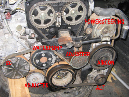

ChrisGT Posted August 21, 2006 Author Report Share Posted August 21, 2006 ok cool. well i test fitted ae71 mounts and they fit in without the rubbers. So i just designed new ones off the ae71 mounts and shortend them by the thickness of the rubbers. the only problem I'm having is that my alternator is hitting my sway bar did you have this problem? Quote Link to comment Share on other sites More sharing options...
ancullen Posted August 22, 2006 Report Share Posted August 22, 2006 I didn't do the conversion, but nothing is hitting or rubbing on mine. Quote Link to comment Share on other sites More sharing options...
irokin Posted August 22, 2006 Report Share Posted August 22, 2006 Perhaps the belt is streched? Can you adjust the altenator so it doesnt touch? Might be able to get a shorter belt or something... Quote Link to comment Share on other sites More sharing options...
Raven Posted August 22, 2006 Report Share Posted August 22, 2006 I think you can get different brackets to mount the alternator in a different position as the FWD and RWD 4AGE's mount the ancillaries in different spots due to the way the engine is situated in both layouts of the cars. Quote Link to comment Share on other sites More sharing options...
ChrisGT Posted August 22, 2006 Author Report Share Posted August 22, 2006 yeah on a 4age you can mount the alt on the drivers side but on a gze that is where the supercharger is and the alt on a gze doesn't adjust like a 4age it has a separate adjuster....if that makes sense?! Pic: I'm gonna keep aircon but of course not have power steering. ill work something out...maybe jus modify the bracket and put the alt where the power steering is Quote Link to comment Share on other sites More sharing options...

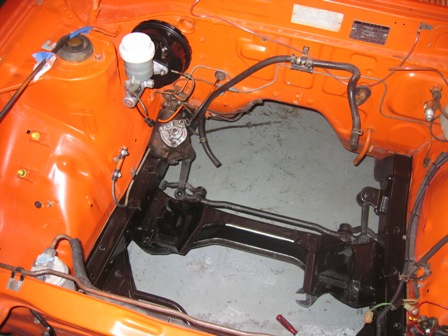

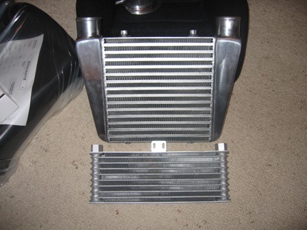

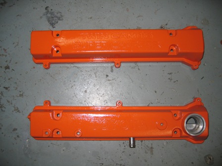

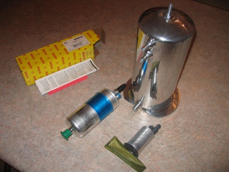

ChrisGT Posted August 31, 2006 Author Report Share Posted August 31, 2006 (edited) Got lots of new parts! for the fuel syatem ill be running a 2 litre surge tank, bosch 910 fuel pump and vl pre-pump in the tank. will hopefuly get it all in the car this weekend. also got my intercooler and oil cooler, with oil filter relocator. last weekend i did some painting...painted the cam covers and resprayed half of the engine bay cross member, sway bar and stuff. Looks so clean now, all ready for the gze to be dropped in! Edited August 31, 2006 by ChrisGT Quote Link to comment Share on other sites More sharing options...
Des Posted August 31, 2006 Report Share Posted August 31, 2006 (edited) man thats clean as :D .are going to change your gze sc or crank pulleys to boost the pressure?and what sort of prep did you do to spray the boot and what sort of paint did you use? cheers des Edited August 31, 2006 by too quick Quote Link to comment Share on other sites More sharing options...
ChrisGT Posted August 31, 2006 Author Report Share Posted August 31, 2006 Thanks...for the boot i just stripped it, degreased it all, then high pressure cleaned it, sanded it back, washed it out again, and then used a wax and grease remover. I painted it with body denitor in a spray can...so i didnt use a primer as apparently that stuff sticks to anything. As for the SC I'm going to use a SC14 instead of the SC12 to get more boost. Quote Link to comment Share on other sites More sharing options...

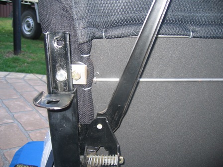

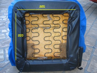

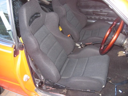

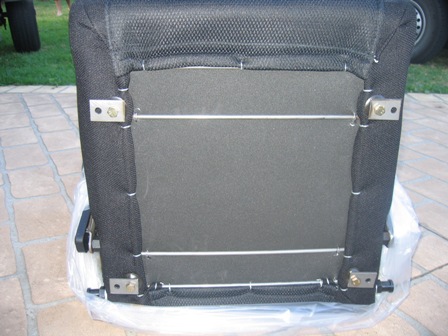

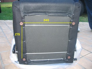

ChrisGT Posted September 2, 2006 Author Report Share Posted September 2, 2006 Got my seats in today. I bought Recaro copies off ebay, they came with universal rails but figured out it would be easier to modify the existing seat rails and make new mounting points on the new seats. These are the old and new seat mounting points: As you can see the new seats mounting points are closer together so I made some brackets to space them out horizontally and drilled new holes in the rails to fit them vertically: and the finished product: Quote Link to comment Share on other sites More sharing options...
