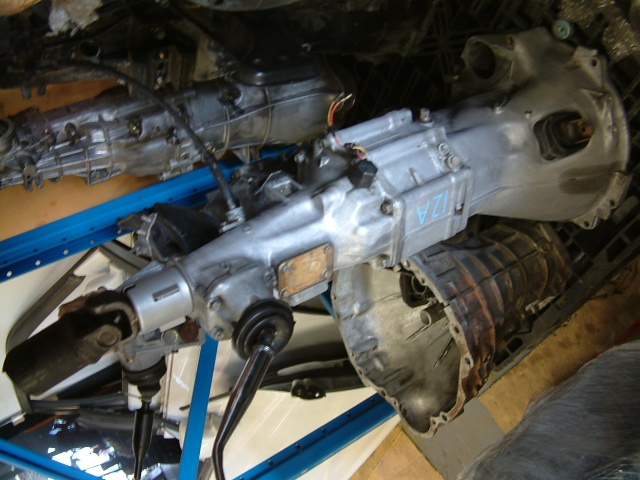

kangaroosa Posted March 14, 2010 Report Posted March 14, 2010 So i'm tipping that 626 was never engineered :jamie: To think that a simple flat piece of steel is all it takes to make a proper mount. I would hate to be a bolt on the engine side of that mount. Nice to see some good progress Mick. At least you can look at it now and build it the exact opposite way. :) Quote
Raven Posted March 14, 2010 Author Report Posted March 14, 2010 Yeah, it was a slap together job, that's for sure and no, never engineered. Not even sure if it was even on the road. Maybe Scott can shed some light on that one :jamie: The wiring is going to be the interesting bit, but shouldnt be too hard to sort out though as I kept the coils together and all the plugs :) Quote

ScottKE1X Posted March 14, 2010 Report Posted March 14, 2010 Ghetto Spec is right... Was definately never engineered, never went further than our front paddock and driveway with the 12a in it. don't worry, my brother has copped shit for that "engine mount" for years... Did you get through everything Mick? Get any cash for the shell? Scott. Quote
Raven Posted March 14, 2010 Author Report Posted March 14, 2010 Nah just dumped the shell at U-Pull-It. Nothing was usable on it and we were busting our arses to get the trailer back on time. Quote

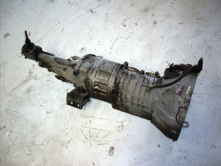

kangaroosa Posted March 15, 2010 Report Posted March 15, 2010 (edited) Taz_Rx said: haha sounds familiar! Should just search your old PM's mate. >| Yeah Dejavu :lolcry: Mick- I wanted to go overkill from day dot, so i went with a S5T box. I didnt even bother with the earlier boxes as I heard so many bad and not so good stories about they're strength. I shortened the shifter location on my box like the majority of guys do when they slot them into the earlier RX's. In hindsight I didnt need to as I was reaching for it when shifting. So I recently replaced the gearbox with a std position shifter and its perfect. Moral of the story is.....don't shorten the shifter. I guess you can say that S1 shifter location may be further forward than you'd hope too. Edited March 15, 2010 by kangaroosa Quote
Raven Posted March 15, 2010 Author Report Posted March 15, 2010 Hmm, decisions decisions. Do you or Taz have any pics of the differences in these gearboxes? Quote
kangaroosa Posted March 15, 2010 Report Posted March 15, 2010 (edited) Theres a Gearbox Guide in the tech section on Ausrotary with pics and info. There is a massive physical size difference between the two. You can fit a S1 box into your car with little or no mods. You've seen what had to be done to my tunnel to squeeze it in. EDIT - Heres the link Gearboxes - Tech Reference Early Gearbox S5 Gearbox Edited March 15, 2010 by kangaroosa Quote
Raven Posted March 15, 2010 Author Report Posted March 15, 2010 Going by that guide, I have the late RX-4 twin dizzy box with the low mount starter capable of 300hp! >| Think I might have to stick with it! :lolcry: Quote
