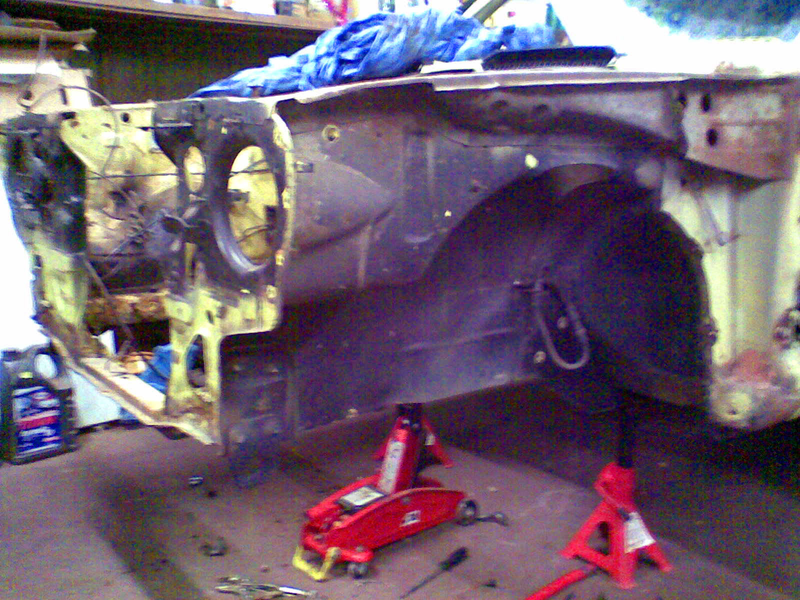

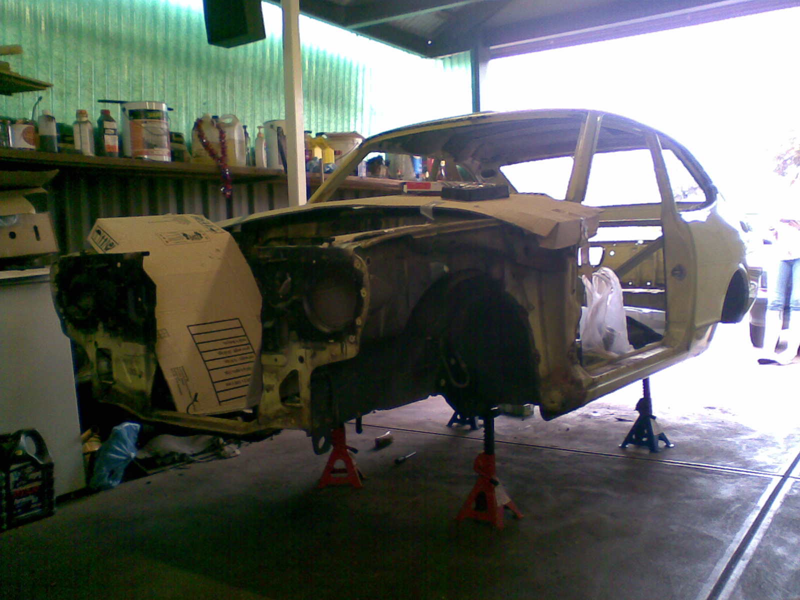

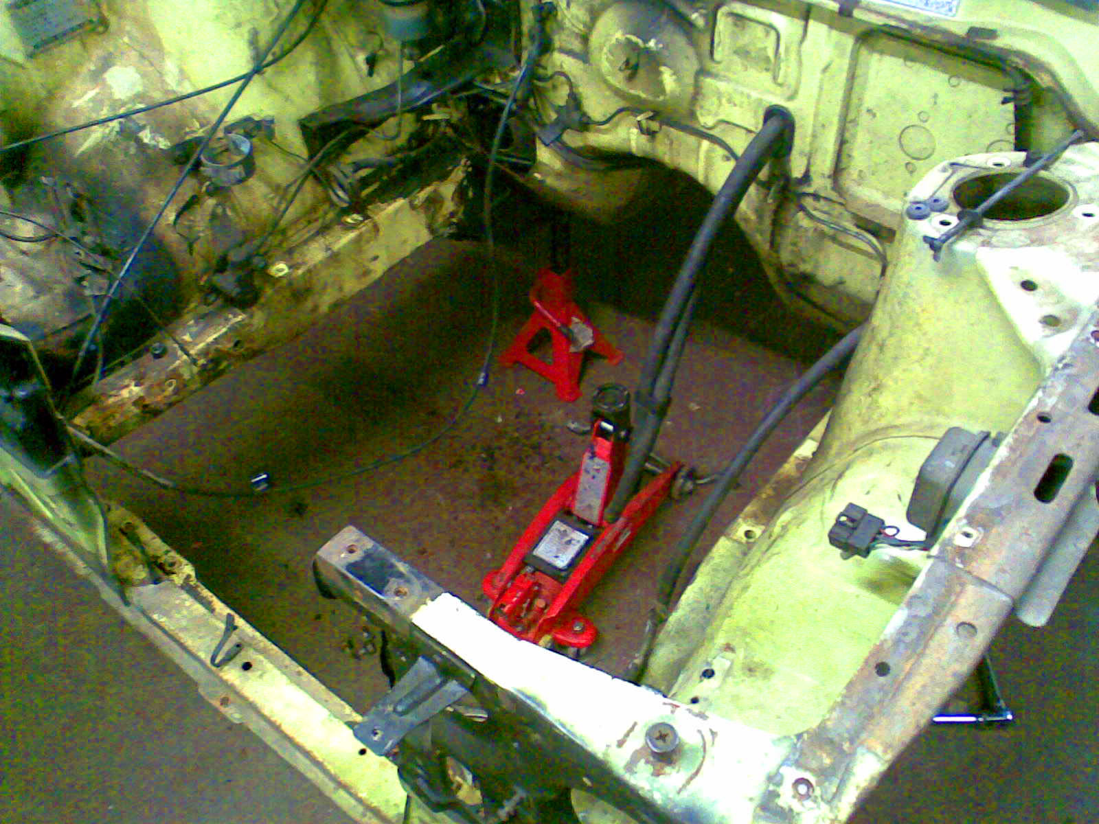

Raven Posted May 9, 2009 Author Report Posted May 9, 2009 (edited) And the slow progress continues.... Finally found a pair of ratchet axle stands today for $50 from Autobarn, so got the back end up off the ground. I then proceeded to remove the steering column, steering box, castor rods and sway bar and lastly, the engine cross-member. This was the final pic of the day. Not much to show really except that the front end is more or less completely stripped and the pic is blurry :P Next Saturday though, the diff is coming out and if I have some time, I may remove the brake and fuel lines that run from the front to back of the car. Edited May 9, 2009 by Raven Quote

Tally Posted May 9, 2009 Report Posted May 9, 2009 (edited) good thinking.. your engine bay looks nearly as bad as mine :P thought about powder coating the front end steering/susp components? thats what I'm doing... Edited May 9, 2009 by Tally Quote

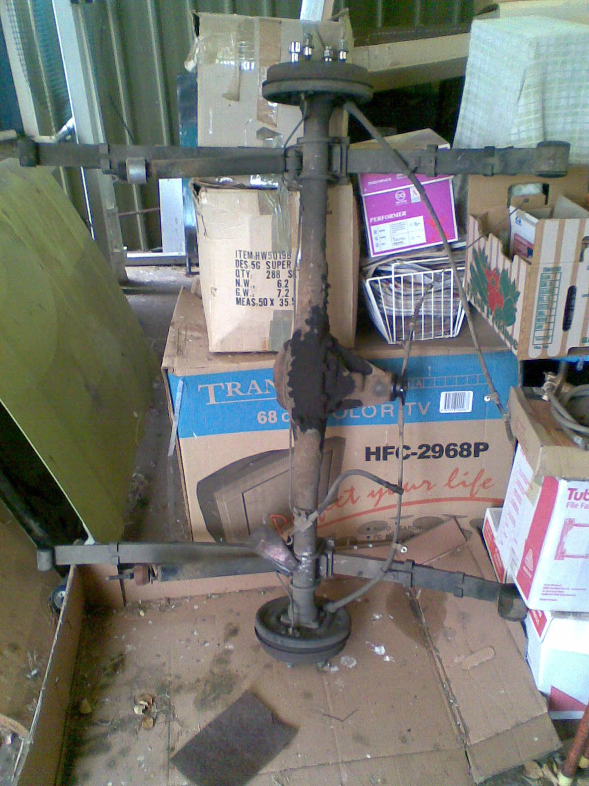

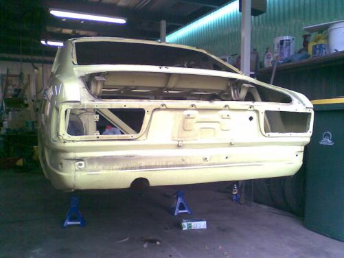

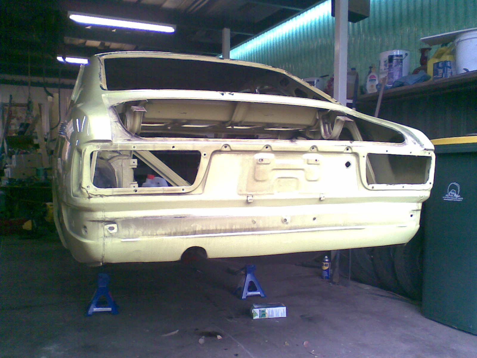

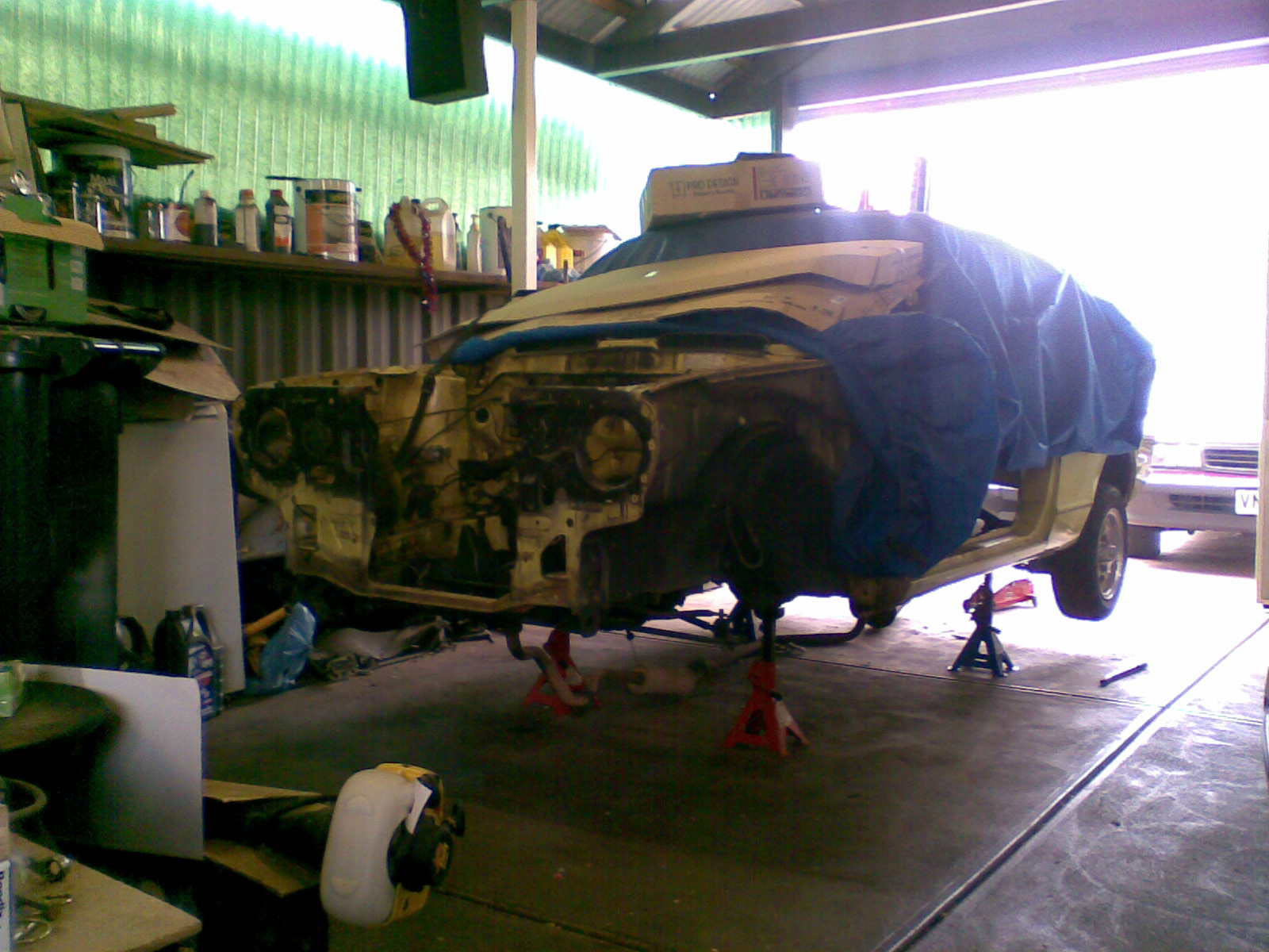

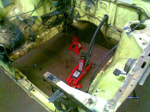

Raven Posted May 17, 2009 Author Report Posted May 17, 2009 Matt: If I need a hand, I'll be sure to sing out, but everything seems to be going rather smoothly at the moment, which is a good thing. Spent 4 hours today pulling out the diff and rear suspension, removing a few more bits and pieces and discovering where it was that the car leaked water into. So this was whipped out at a leisurely pace today. Which lead to it looking something like this.... And this..... I also had the old man heat up and pop out the dent in the floor just under the passenger seat from the previous owner and we also removed the front vents, and then removed the sound deadening behind them to discover more rust holes inside the cowling (which I now know where my water leaks were coming from when the car was on the road). Nothing bigger than a fifty cent piece, but that means I may as well pull out the complete heater assembly inside the car as well so this can be welded up properly. So next weekend I'll tackle the dash and we'll hammer and chisel out the sound deadening inside the car. Happy happy fun times! Quote
