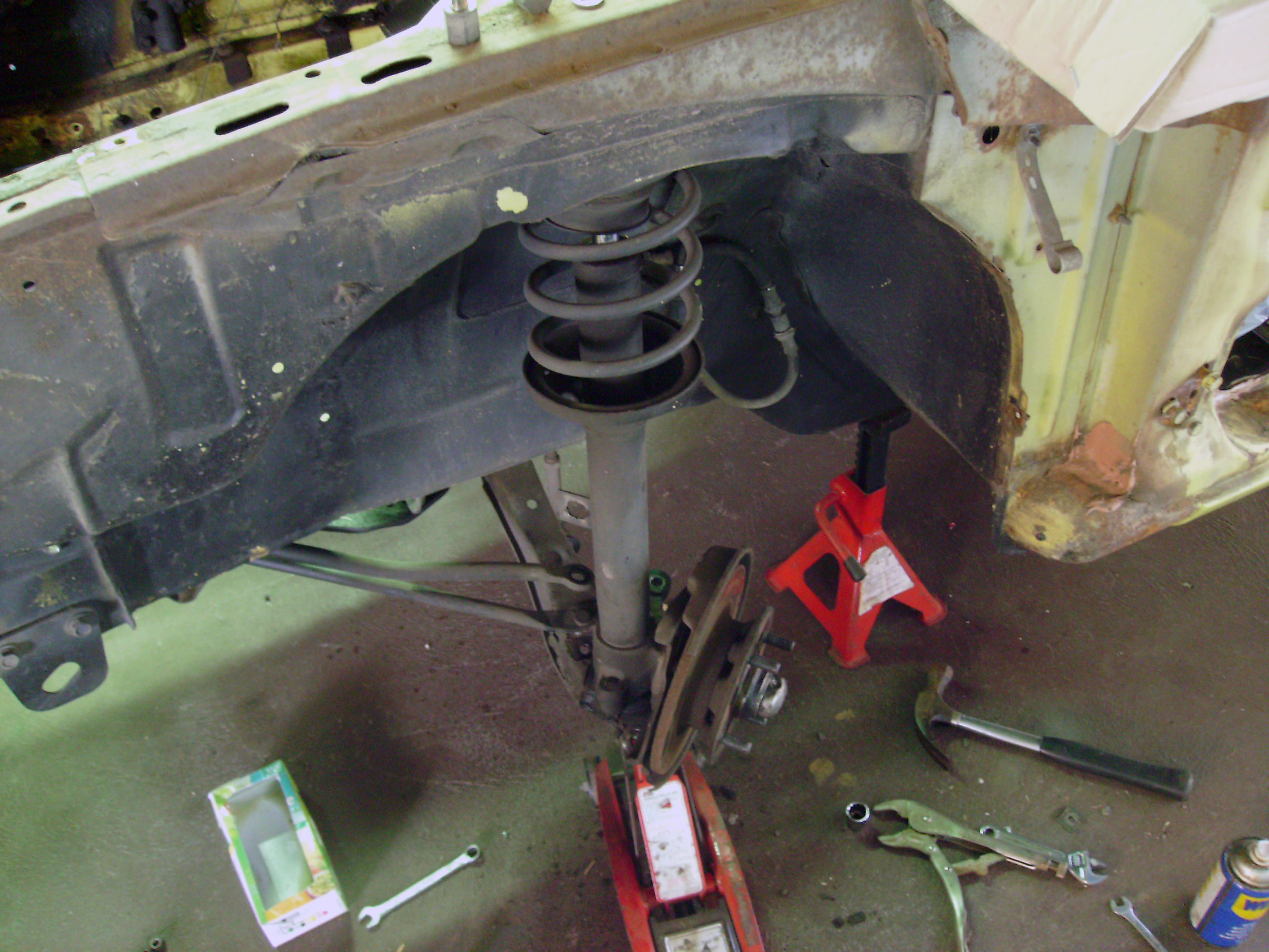

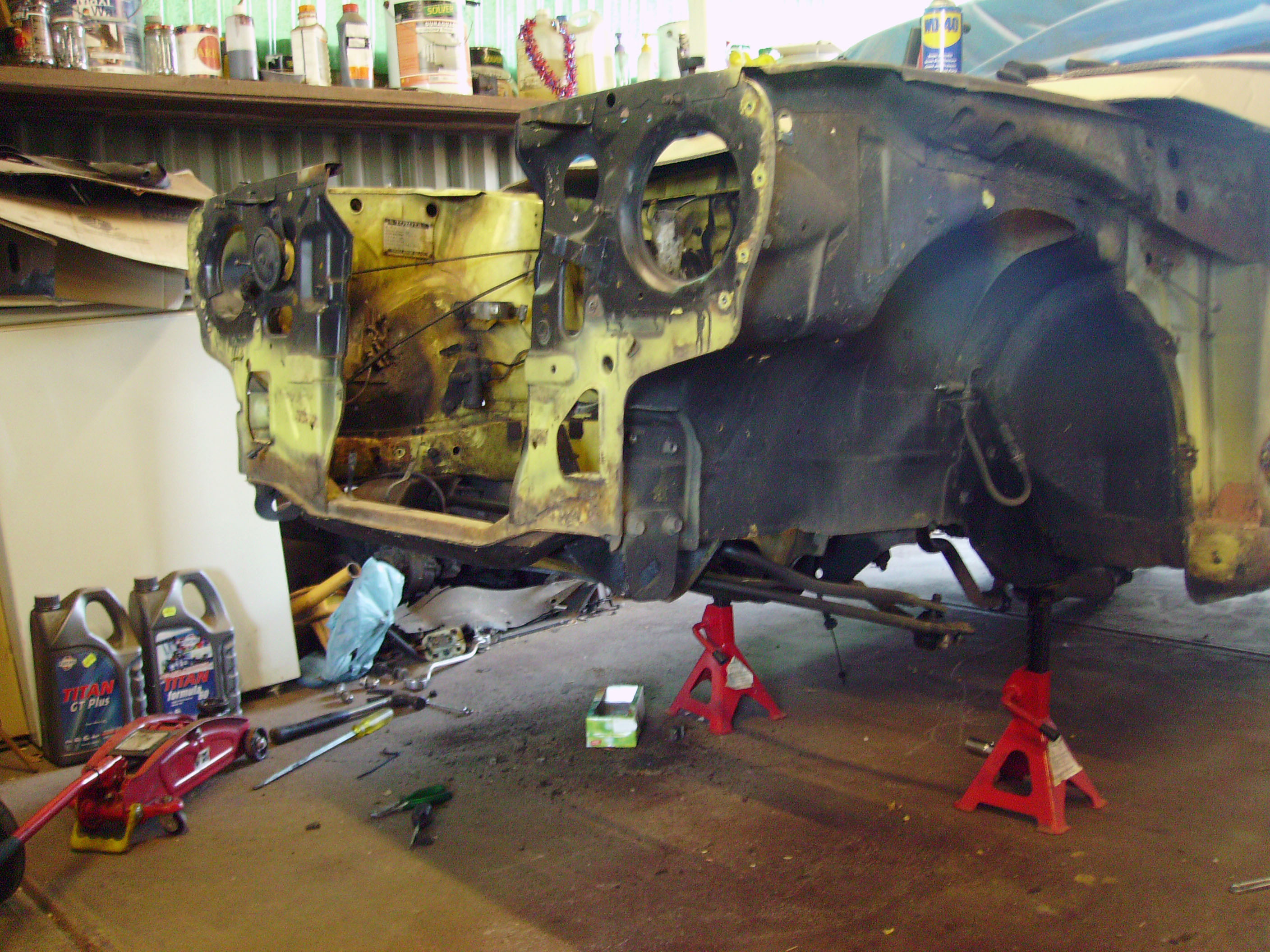

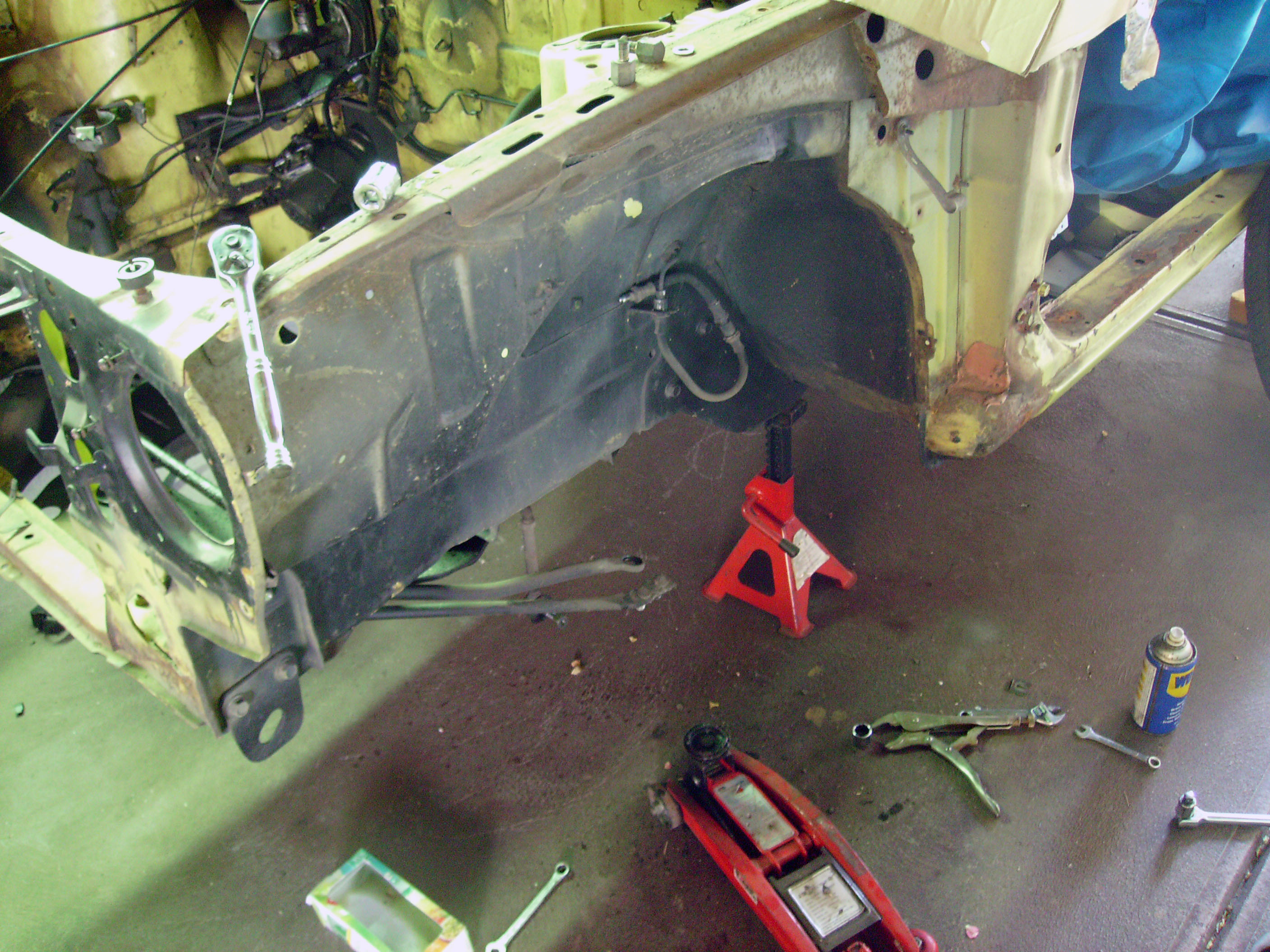

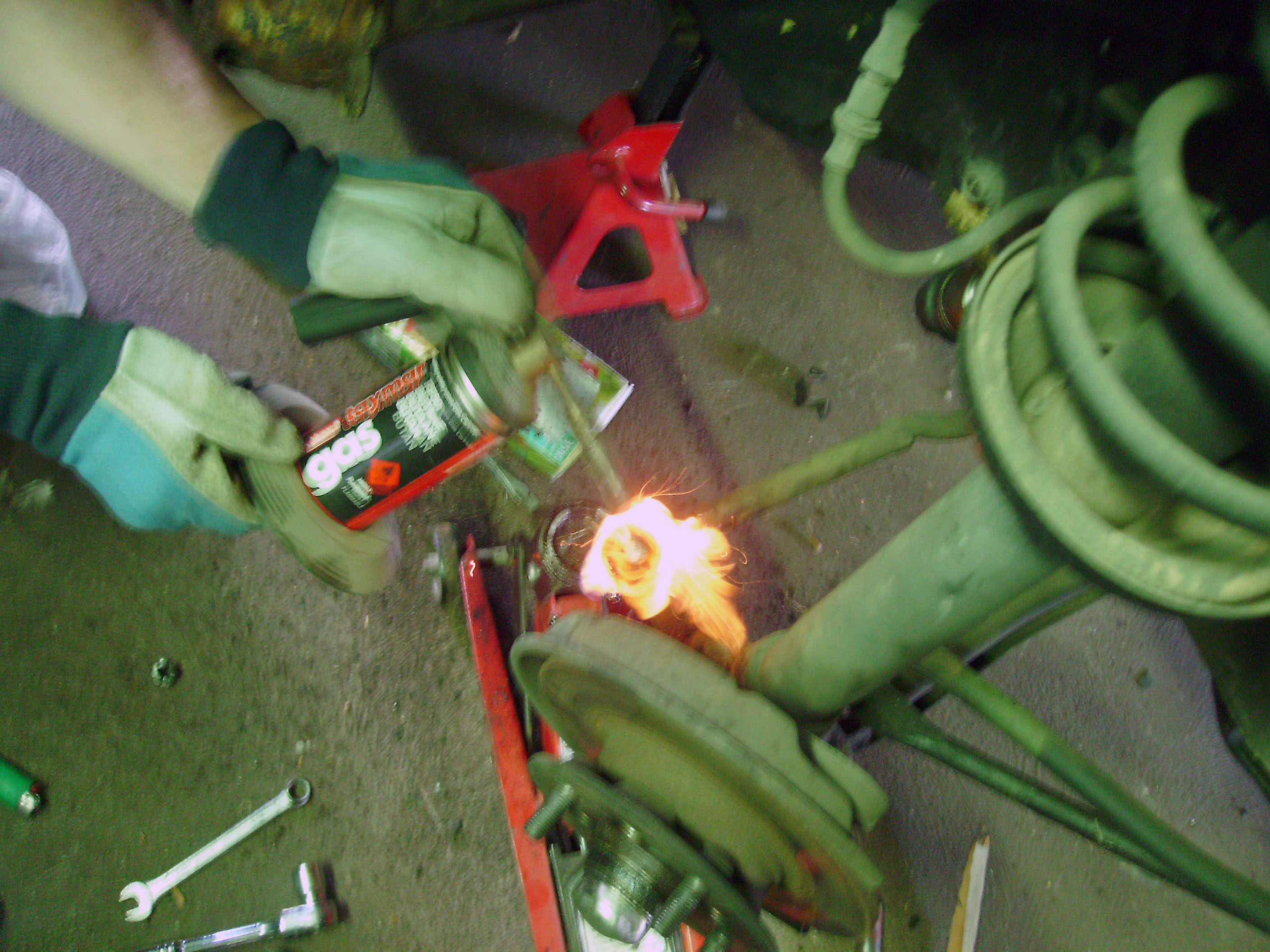

Raven Posted May 2, 2009 Author Report Posted May 2, 2009 (edited) Not yet. Waiting on my K.Rudd payment, not to mention I have to have it stripped down first. Started on that today actually, here's my progress so far.... Firstly, I started with removing the front left strut assembly, which came out relatively easy. As you can see here, this one took me about 20-30 minutes to remove at a snails pace. The front right on the other hand was a complete bitch to get out. I tried heating it, bashing it with a hammer and nothing. In the end, it got so badly damaged (it was a rooted original tie rod end anyway) I had to go and purchase a ball joint/tie rod seperator and seperate it from the main drag link, which worked a treat. So progress today after about 4 hours was both front struts removed and placed in the back shed. Edited May 2, 2009 by Raven Quote

greenmac80 Posted May 3, 2009 Report Posted May 3, 2009 good work.. gotta hate old steering parts i had heaps of trouble with mine as well. did you consider dropping the struts steering and x member all in one? then working on em? might have been easier. Quote
Raven Posted May 3, 2009 Author Report Posted May 3, 2009 (edited) Unfortunately, I didnt have the room to do that, so I had to persist with pulling it all out pice by piece. Edited May 3, 2009 by Raven Quote
greenmac80 Posted May 3, 2009 Report Posted May 3, 2009 hmmm spewin. bearing puller work well for getting tierods out. jst a thought for future if you had one i mean. are you going to get your steering box recoed? Quote
Raven Posted May 3, 2009 Author Report Posted May 3, 2009 hmmm spewin. bearing puller work well for getting tierods out. jst a thought for future if you had one i mean.are you going to get your steering box recoed? I bought a ball joint/tie rod seperator in the end which works similar to a pulley remover, except it pushes, not pulls, and that got it out. Definitely going to get the steering box recoed and will see if i can up the ratio in it as well :) Quote
