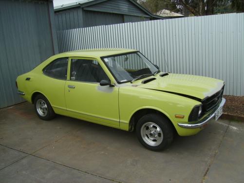

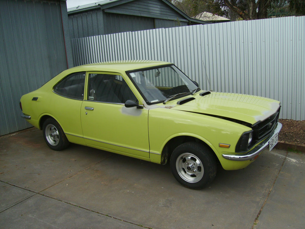

Raven Posted July 14, 2007 Author Report Posted July 14, 2007 Thought I'd put up a pic of how it stands at the moment since I finally got it started and moved it today after fiddling around swapping over linkages etc to suit the KE25 accelerator cable. Quote
