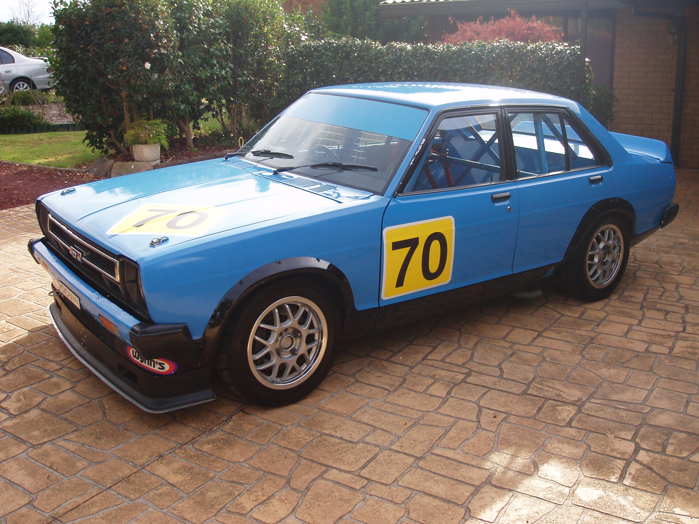

TOMsGPTurbo Posted July 27, 2006 Report Posted July 27, 2006 (edited) Gav I completely agree with your point of view and I can even give an example using my car and situation, a FWD toyota corolla ii gp turbo, I paid for an engine conversion, as well as many other things and I estimate the engine conversion costs would be approx 4000.00 total, now that money put into modifying the bigger orginal engine (1.5ltr 3ETE) would first of all ensure the car would still be on the to this day, and have more perfomance then a starlet GT who's engine I used for the conversion (1.3ltr 4EFTE). I'm not very mechanicaly minded so I'm slowly learning as I go, I'm never going to trust anyone touching my cars again, I was really burnt by my last experiance with the engine conversion so I envy all of you who work on your own cars. P.S: I'm in love with that blue race car ... damn that's fine! from what I can see the driver sits in the middle of the car!??!?! seriously cool! Edited July 27, 2006 by TOMsGPTurbo Quote
