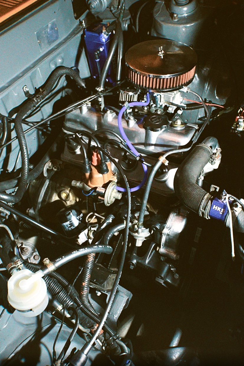

Thanks for the reply Banjo! I don't really know how to upload the video here, by any chance is there any other way for me to contact you? My instagram’s @/juoone btw! The engine have 1 off 5K carby. Original distributor ( non electrical, but i just ordered the electrical distributor last night hehe ). Idle is fantastic, sounds good for me. The problem occur whenever i start to pick up some speed. It jerks all the time. The plug’s insulator color is yellowish burnt. I’m planning on getting someone to come and check it for me tho! Still don’t have the time since I'm quite busy with school still hahaha! I’m from Brunei Darussalam btw, a tiny country based in south east asia šŸ‡§šŸ‡³
ps: don't mind the messy engine bay haha

I've read your post through again today, & I must say, that the engine bay looks very clean & neat.
I hear you say it idles perfectly, but when you increase revs, it "jerks", under load.
I'm going to have a stab at this; based on a similar problem, I came across, a few years ago.
As soon as you increase revs, & load; with your foot hard on the accelerator pedal, the fuel consumption increases, & the carby bulb lowers, & the valve opens to input more fuel. If the fuel pump is not up to it, then you could easily obtain the "jerky" engine response.
Did you fit a new fuel pump, of is it the original ?  The mechanical fuel pumps on the K series engines, are usually very reliable. When olde, they are known to suffer deterioration of the  main rubber diaphragm.  The tiny spring loaded valves, can sometimes get dirt in then, or break.   However, there are two things that can prevent the fuel pump not being able to produce output.  The first one, is if the fuel pump, is attached to the block, without the "fiber" spacer, between the pump & block mounting flange.  This is rare, but I have come across it on one or two occasions; although it usually destroys the pump pretty quickly.  The second problem with low fuel throughput, is the pump being mechanical, has to be mounted on the engine.  However, that results in the suction path from the fuel tank, to the pump inlet being long.  I have found that even if the pump is working perfectly, that they don't work very well, if there is the tiniest leak in the long inlet line, & it sucks air in. On many olde Corollas, there is a rubber joiner in the fuel pump inlet line, under the floor pan, & this goes hard & brittle, & can cause, the issue you describe.  Ideally, the fuel pump can be electrical, & sited close to the tank, so that the suction section of pipe to the electric pump inlet is short; & the line to the carby is always under pressure.  Only real issue with electric pumps, is that You must include a "safety cut-out", for the electric pump, if the vehicle is ever in an accident.
