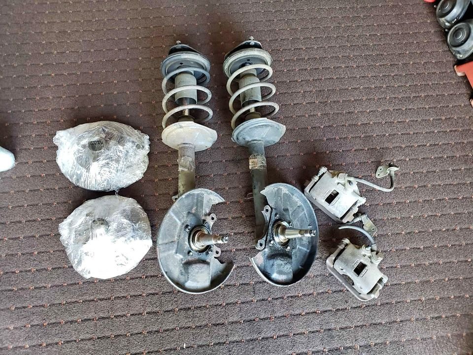

cheers for the reply Banjo ~ I had had a search to no avail. I knew about replacing the whole strut, but my question was really about wether the ST141 corona brakes - backing plate, rotor and caliper ~ would actually just bolt to the existing strut.st141.jpg.8b9637c25d52b590f52d1e5471b5e6e2.jpg
Others may correct me; but I thing the simple answer is no.  It's over a decade ago now, since I did mine; but At least, I think I had to replace the top pivots, & they had to be adjustable to get the camber right. I know it was a good learning experience, & there was a lot of measurements taken, with the wheels & weight on a flat concrete floor.  Steering linkage lengths also came into play.  I'll have a read through my original thread tonight, & see if it brings back other memories of this exercise to light.  I do remember, I also fitted a much thicker anti-sway bar, which really helped, & some really good Koni shockers in the Corona strut tubes.
I seem to remember, there was a very popular conversion, called the "PUG" conversion, which used an early model Peugeot disc caliper off memory.
I do remember, that you had to weld the lower spring support & retainer on, so that when the wheel was hanging free, that there was still some compression on the spring, at all times.
Cheers Banjo
