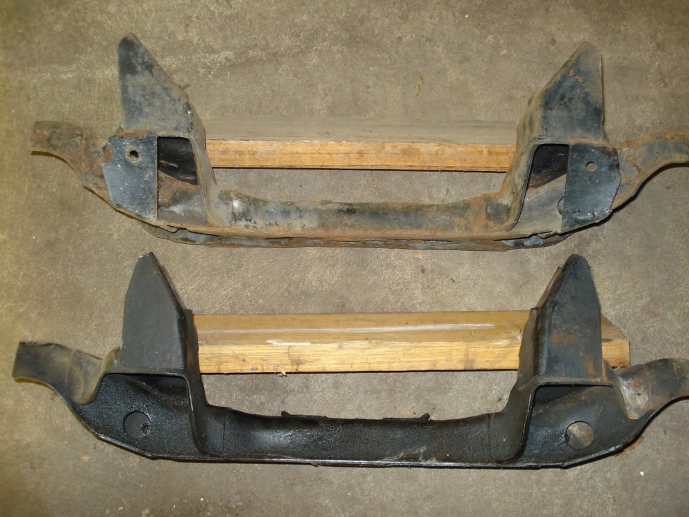

The main engine mounts are welded to the crossmember, then there are engine mounts bolted to the engine block.
The mounts welded to the crossmember are spaced quite differently between a K engine and a T engine.  There is a difference between fitting the engine into the engine bay, and fitting it correctly.
It's very likely that the original crossmember to suit a K engine is still in the car, and they have worked around it at the engine block end.  That is always going to be a compromise.  You need to find out what they did to fit the engine in.
If it is a K crossmember, have they cut and rewelded the mounts?  Your options are to redo that properly, or source a T crossmember for this car from either Japan or the USA as we never had T engines in these cars in Australia (edit: I see you are from Philippines).  I would source the correct crossmember.  Not as expensive as it might seem, and probably cheaper than trying to work around using a K crossmember.
It probably had a different sway bar with T engine also, so you may need to work around that or the sump may sit on the swaybar.  It's been done lots of time so isn't rocket science.  Look through the build threads as there is likely the very same issue outlined there.

This is a picture comparing crossmembers for a KE25 and a TE27.  Basically the same car with either a K engine or a T engine.
Gives some idea of the differences between the two
