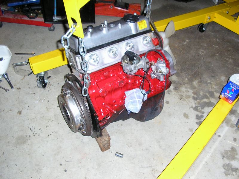

finished bolting together the 4k that is to go into the '16.
finished decoking the ports, and scraped the head clean of old gasket. was a bit of a mission as i use gasket goo on all my headgaskets (not going to leak in a hurry ;) ). i wire wheeled all the carbon buildup off all the valves, and reground them. reassembled the head, overhead valvespring compressors are good.
when it came time to bolt the head to the block i was stressing, as there were no headbolts in the boxes i put all the parts in when i partially disassembled the motor (about 2 years and 3 moves ago). must have used them for my 5k. anyway i found a box with three sets amongst all my crap, and used a set of the earlier 3k non elastic type headbolts.
just need to bolt the water pump, thermostat housing and other ancillaries from the motor in the car to it now. total expenditure on this project is a can of degreaser, and some gaskets and seals from a full gasket set i bought at the markets a few years ago for $15. otherwise it is just parts recycling. :jamie:

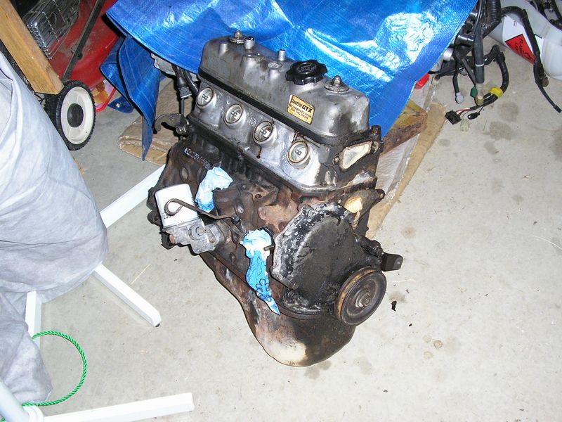

pulled the motor out of the ke16 this arv. took about an hour and a half doing most of it myself with handtools, the missus helped for some things. i SOOO want a bigger compressor and an air ratchet.
i'm loving the engine crane, and load leveller. the load leveller makes it easy to tilt the engine/box to the angle you want. made life so much easier considering the car has 4into1 extractors which are welded in, GRRR! :dance: had to remove both engine mounts so i had clearance to manouver it out. it was set up that way by the previous owner, anyone who adds extractors without an easily removable flange should be bitch slapped!
now just need to clean things up and transfer some bits over between the two engines, before putting the new one in.

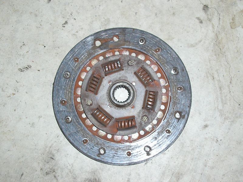

was wondering why the old clutch made some odd noises, until i saw the friction plate. :dance: she's slightly fnackered. bits of rivet fell out when i separated the box from the old motor.

woohoo! disconnected the coil, cranked it over until the oil light went out. reconnected the coil and she started first go. :dance:
still haven't got the radiator in it, so i didn't run it for long. sounds way tougher then the old motor. :D i'll finish it off and time it properly tomorrow.
probably put my 32/32DGV weber on it later in the week. it could do with a bigger carb now.

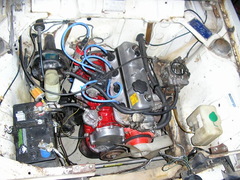

that engine looks great in there, what is the booster and mastercylinder off and what kind of swaybar is it, will a ke20 one fit the front of a ke10???? good luck with it,
cheers james
thanks. the booster and master cylinder are from a subaru (leone wagon?). it will be going shortly and be replaced with a non boosted dual circuit m/cyl from a galant. i much prefer the non boosted pedal feel. i'll also be upgrading the discs on the wagon from the ke2x ones on it now to ke30 ones.
the swaybar is a whiteline 22mm item. i have them on both my cars.
