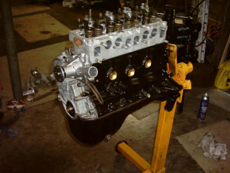

Felix Posted June 28, 2006 Report Posted June 28, 2006 (edited) that first pic is my current motor. ultimately you shouldn't expect much more power from a 5k than what you would from a 4k. they both are pretty much airflow limited by the same sized valves and a non-xflow head design. i have experienced this myself from running similarly built 4k and 5k engines. the 5k will make more torque and be quicker (more area under the curve). in a lightweight ke1x it will be fairly quick. even my missus has been known to pull out and overtake a line of 5 cars in country driving. ;) if you can set up a 5k cheap, then go for it. other wise the money spent would be maybe best put towards a conversion. Edited June 28, 2006 by Felix Quote

Xany Posted June 28, 2006 Report Posted June 28, 2006 Second Pic is my engine that was fully rebuilt about 2 years ago....still going strong ;). The head you see on it is a 3K bigport head, you wont get much bigger ports than that in a K engine head....those are just about the limit. I found that building my own engine, gave me alot more insight into what goes where and how to make more power....When i joined the club (just before i started the rebuild) i didnt know much about k engines.....now that i've rebuilt and worked on one many times, i can honestly tell you i don't regret any bit of spending money on a K engine (i'm still doing it lol). Felix is right, you wont really feel much difference between the 4K and 5K....torque and a bit more get up and go. And anyone that says you can't get a 5K to rev cause they are a "van engine" needs to have a look at some of the 5Ks on here....lol Quote
