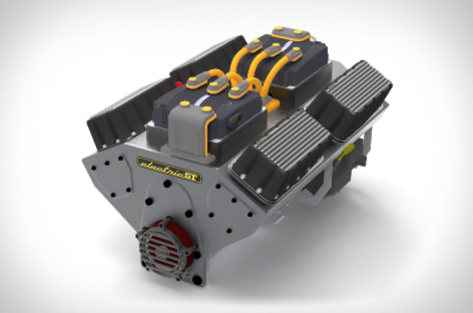

wenisman Posted January 17, 2023 Report Posted January 17, 2023 There are a number of people who make parts for the rwd conversion of the duratec engine as they are pretty common in caterhams and Westfield's. I am seeing if I can get an electric gt ev crate motor in aus. If it is closer to a direct drop in then it may be a costly but convenient option. Quote
Banjo Posted January 18, 2023 Author Report Posted January 18, 2023 (edited) Oh I love it ! The love affair continues. You lift the bonnet, of your EV powered car, but still has all the appearances of a worked V8. I think it is call "holding on"; to what we stiil love & are so used to. https://www.sparesbox.com.au/blog/electric-gt-ecrate-motor Cheers Banjo Edited January 18, 2023 by Banjo Quote
wenisman Posted January 20, 2023 Report Posted January 20, 2023 (edited) Yeah, I'm looking at getting the egt213. A casual 150hp should suffice https://electricgt.com/shop/213-e-crate-conversion-system/ I am drawn to this system because it's the easiest system to install, will without going down the rabbit home of sourcing parts yourself and designing in ev system. But the costs are very high, $49k usd for the v6 equiv crate motor (313 system) is a turn off. Edited January 20, 2023 by wenisman Quote
