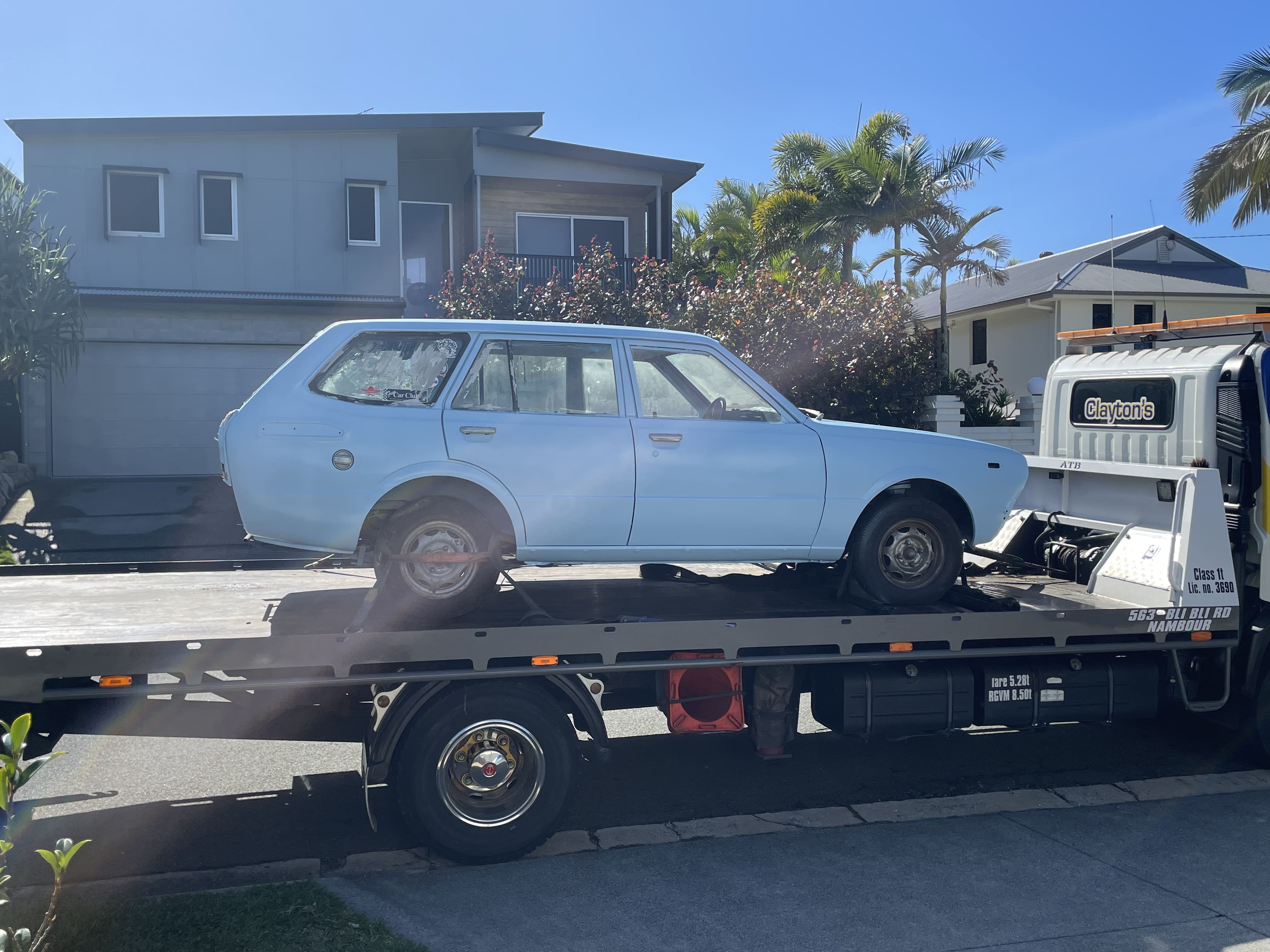

As the title suggests, I am looking to engine swap my current 4k K40  in my ke38 with a 4age T50.

P.S. Pic of corolla with some fresh paint for size.
