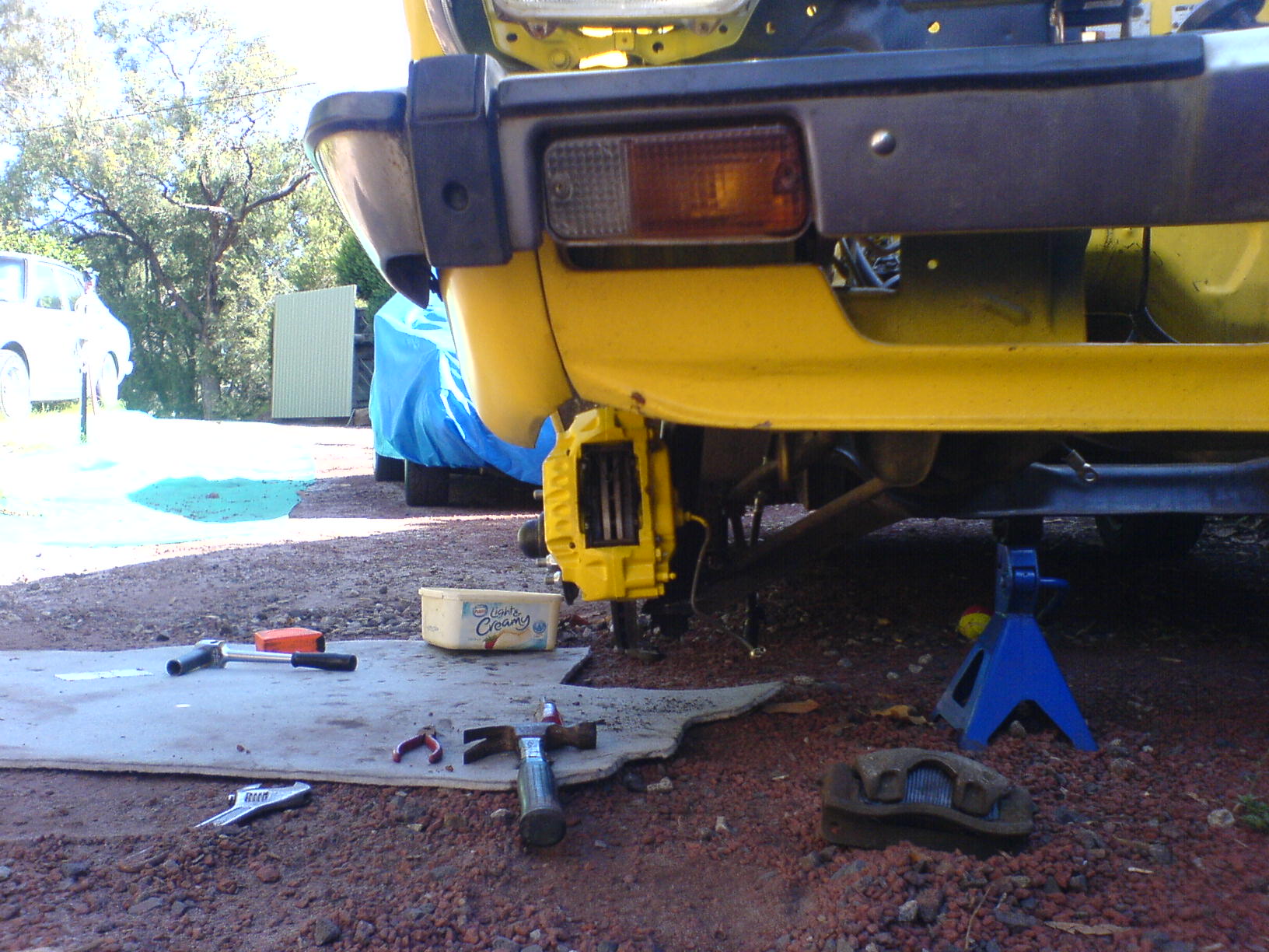

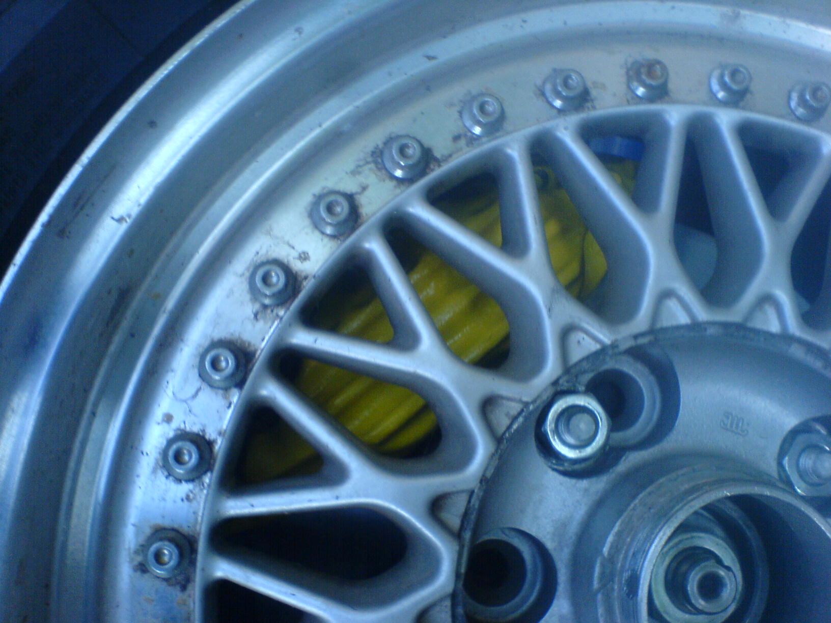

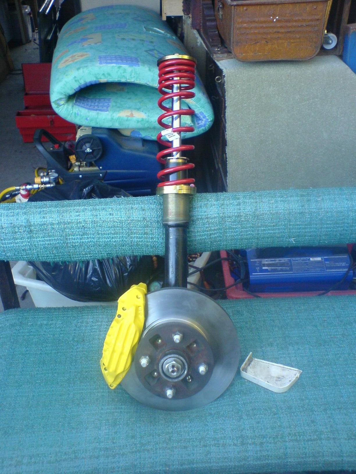

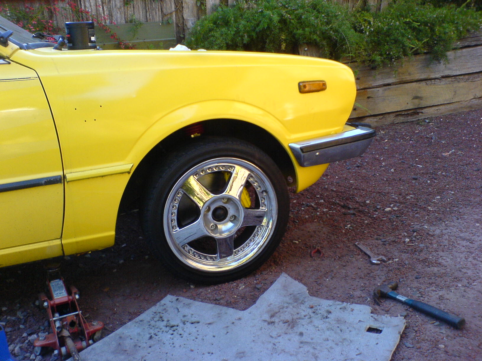

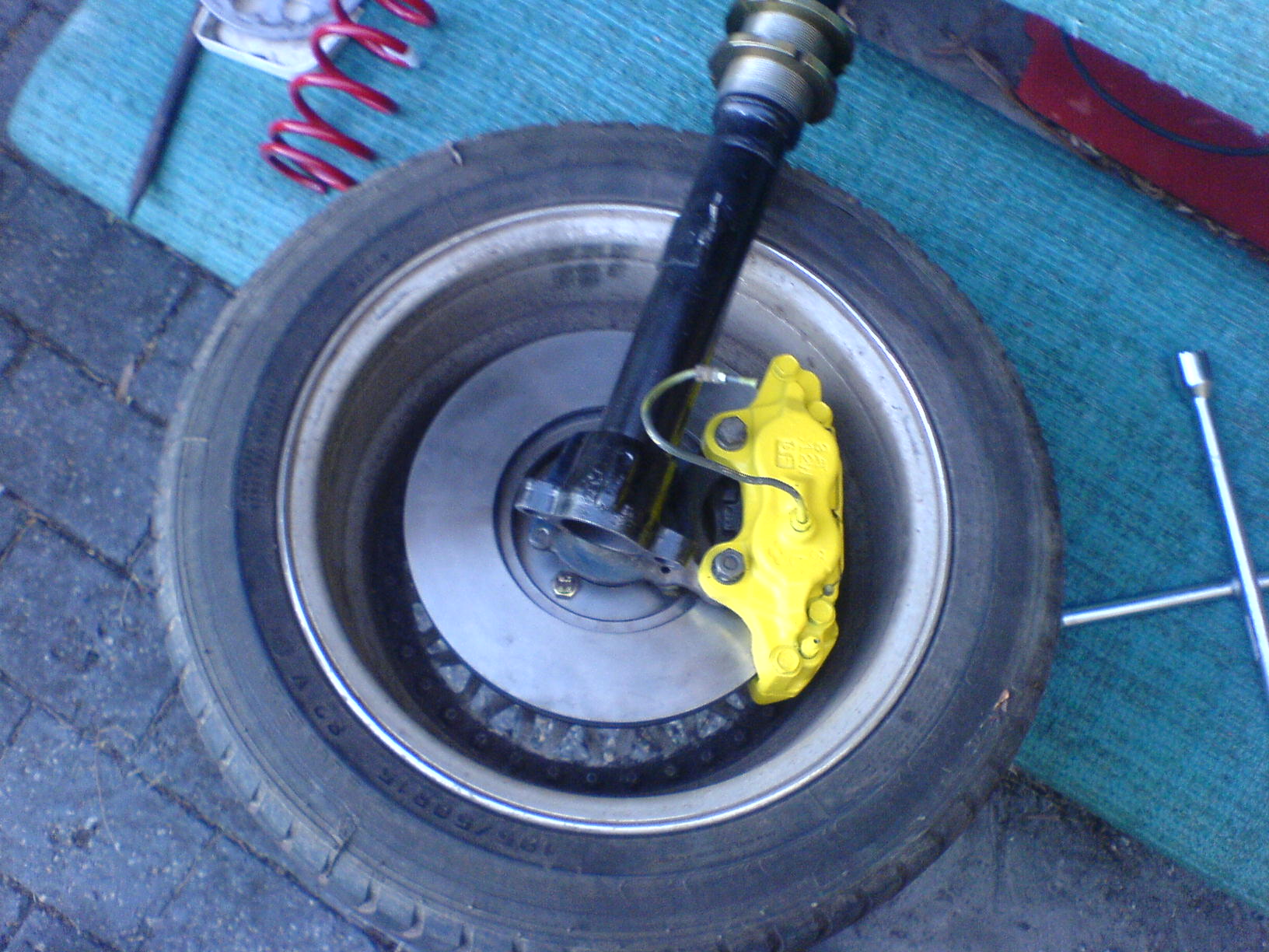

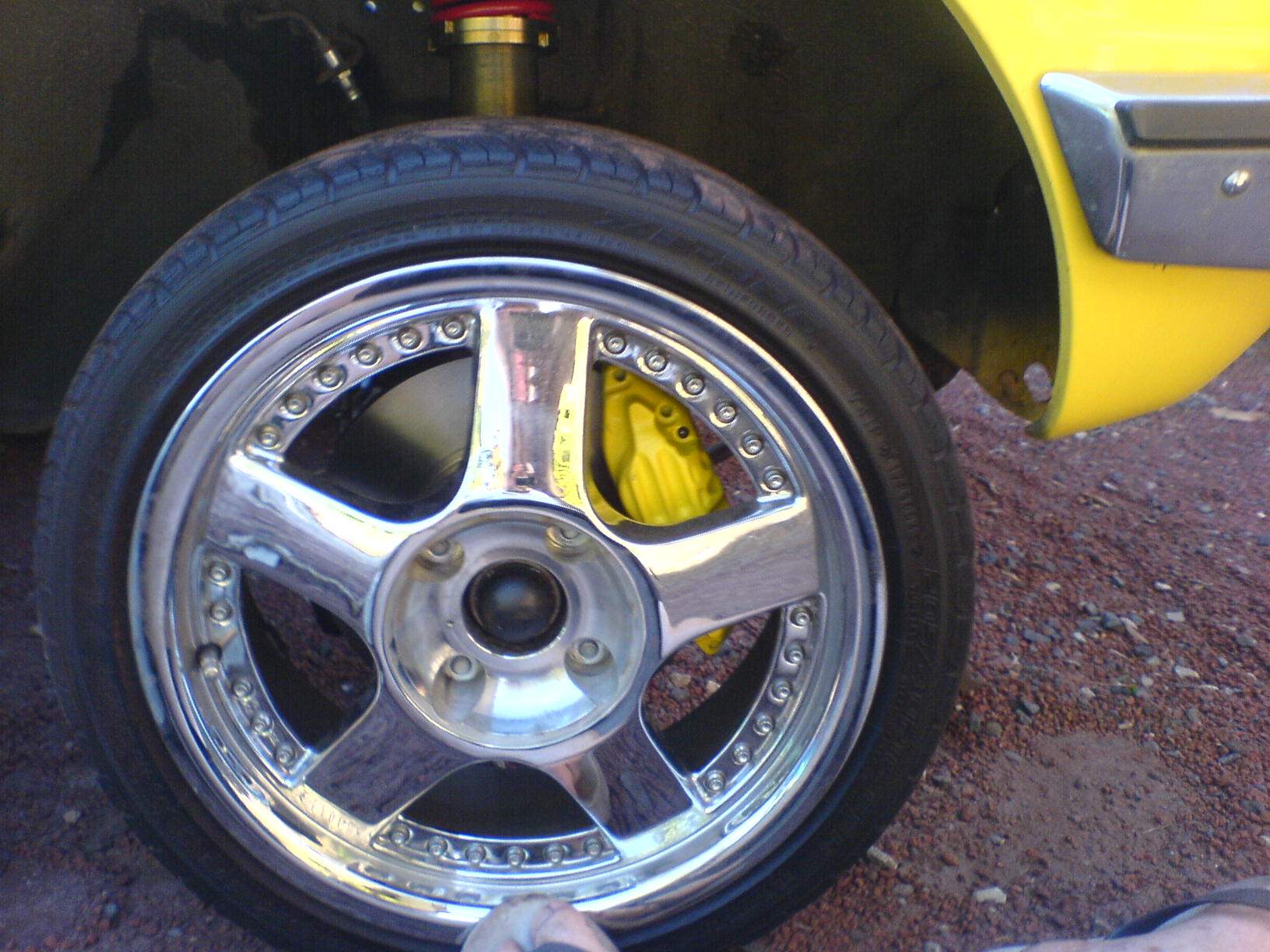

pozman Posted February 5, 2007 Author Report Posted February 5, 2007 (edited) got one of the sturts in today, had to make a quick trip to the wreckers tho, its really hard to bolt the xt130 struts to the corolla stearing arms, :P actully it can't be done! any way when i got them it went in fine, i think I'm going to have to sorten the springs that ive got, as the struts are wund all the way down and it still sits quite high, probly the same height as the old ones but these springs are harder so it wont lower as much when the motor goes back in. plus who wants adjustable ride height struts that are at the bottom of the adjustment. got a few pics. the set up the caliper thru my 15s thats the 15 aswell, there not much room looking at the caliper from the front thats with the spring wound up, love those lift kits (looking at it now, it seems to high, so it might be on the jack a bit) thats it wound down, not to bad but they are a very hard spring Edited February 5, 2007 by pozman Quote
