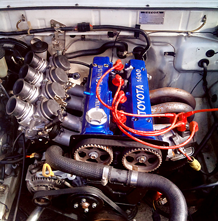

Josho Posted May 21, 2010 Author Report Posted May 21, 2010 Well, nearly a year has passed and not much else has happened to this poor thing, currently in the process of fitting some R1 carbs to the 4AG, I will update this thread with some pictures next week. Manifold is about 90% complete, needs a couple of vacuum fittings. Started work on the plenum and ram air intake. Interested to see how it performs compared to my mate's 20 valve sprinter, even before I fit new cams. Quote

Josho Posted September 3, 2010 Author Report Posted September 3, 2010 Cheers dude! I've modified the accel cable to fit the carbs. Really wish I could get a bigger wheel on the throttle linkage. As it is I'll have 25mm of cable between zero and full throttle. The pedal has 75mm worth of travel in it. Has anyone changed the pivot point of the pedal in a KE before? I'm thinking I might adjust the cable so the pedal is as close to the wall at w.o.t as possible, maybe add a stop under the pedal to avoid stretching the accel cable. After picking up a few bolts to bolt the manifold on I'll give it a run. I might even try and post a video. It will be interesting to see how this Hyperpak module goes as well! Quote

Josho Posted September 3, 2010 Author Report Posted September 3, 2010 Thanks mate, the credit for the manifold goes to my old man, I should really post a picture on how it looks inside the runners before I bolt it up to the motor. It was a big task getting it onto the bigport head while keeping the flow smooth. Can't wait to get back onto the track. It has been close to 2 years now. Quote
