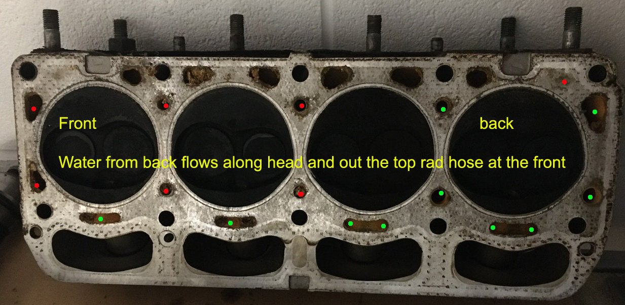

parrot Posted October 22, 2020 Report Posted October 22, 2020 (edited) I’ve recently stripped down two K motors. The amount of crud in the water galleries is astonishing. Intriguing how the water jackets in block and head are often separated by the head gasket. I was looking closely at this the other day and assume this is to ensure coolant remains in the head, as the simple water pump impeller would struggle to maintain sufficient pressure if coolant could simply drop down into the block. Not sure about that. But otherwise, numerous head gasket passages were completely, or nearly so blocked. I have removed quite a lot by this point Edited October 22, 2020 by parrot Spelling Quote

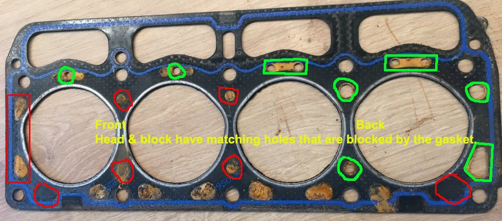

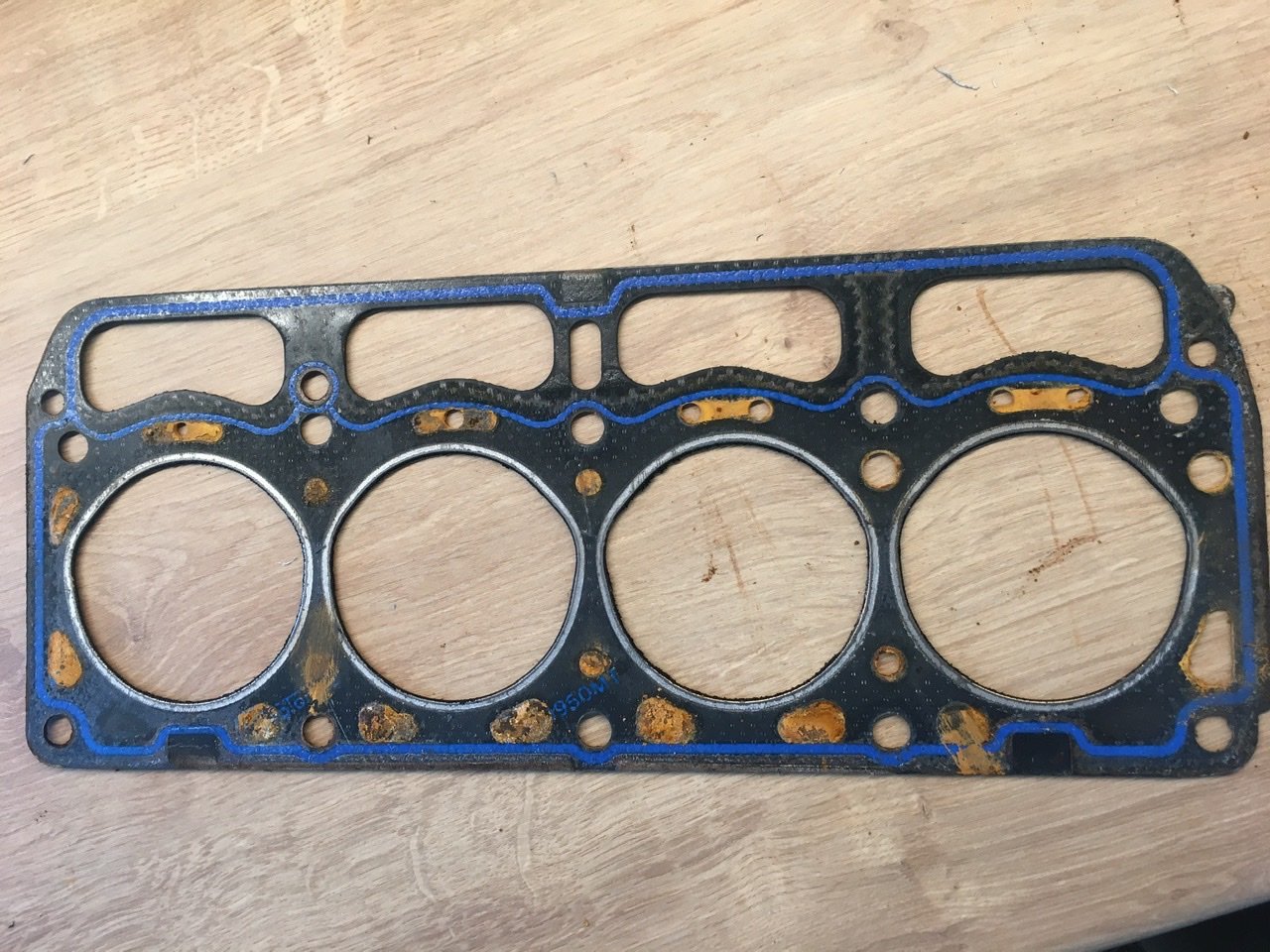

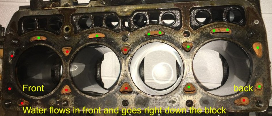

Banjo Posted October 23, 2020 Report Posted October 23, 2020 (edited) Oh yeah ! They can get extremely blocked, particularly towards the rear of the block & head, where flow rates drop. Very early head gaskets for the K series engines, had coolant holes that perfectly matched the flow-thro matching coolant holes in the block & head. Later head gaskets, from several manufacturers, blocked flow-thro holes in the head gasket around cylinders 1 & 2, to force the flow from block to head, to only occur at the rear two cylinders. This was an attempt to assist the issues with higher temps at the back of the engine & head. In Misael's case, if the coolant system, hasn't had a lot of attention for a long time, and there isn't the opportunity to do a complete strip down, I would suggest. 1. Remove the radiator. 2. Remove top & bottom radiator hoses. 3. Turn off the heater water cock. It wouldn't be needed in Arizona, me thinks. 4. Remove thermostat. 5. With a hose, with as much pressure as possible, flush the system out. First in one direction, & then in the other. 6. Like wise flush out the radiator, by it self; again, in both directions. 7. When all signs of colour & debri in the water disappear, reassemble the complete coolant system. 8. Fill the system with clean water, & make sure there are no air locks left in the system. 9. Get hold a good coolant passage "cleaner additive" & add to the coolant, & drive car for a week or upto 1000 klms. 10. Remove hoses & drain & flush again. 11. If the coolant system corrosion is very bad, then you might have to repeat 4-10 again for another week. 12. When the system is nice & clean, add a high performance, high temperature coolant liquid, & it should be good for a number of years. After doing this exercise, be aware there is always the possibility of welch plugs breaking through, where heavy rust on the rear (where you can't see it) has been diminished by the chemical cleaning process. It is important, when doing this exercise, that hoses are removed, The regular drain holes in the bottom of the radiator, & the front of the block, are too small to allow all the larger bits of crud that get released, to pass out of the system. P.S. If the system is very badly corroded, then remove water pump & have a look inside. If it is very bad, or there is noticeable movement or noise from its bearing, then replace water pump. Sounds like a lot of mucking around, but if done properly, your engine will love you. Cheers Banjo Edited October 23, 2020 by Banjo Quote
altezzaclub Posted October 24, 2020 Report Posted October 24, 2020 Yes, the gasket blocks front holes that are matching in the block & head, letting a very small flow through until it reaches the back cylinders. I have wondered if Toyota made a design mistake with the casting and covered the overheating rear cyls with the gasket. There are so many tings in a car that make we wonder 'why did they do this?'.... but sadly no-one to ask! Quote
