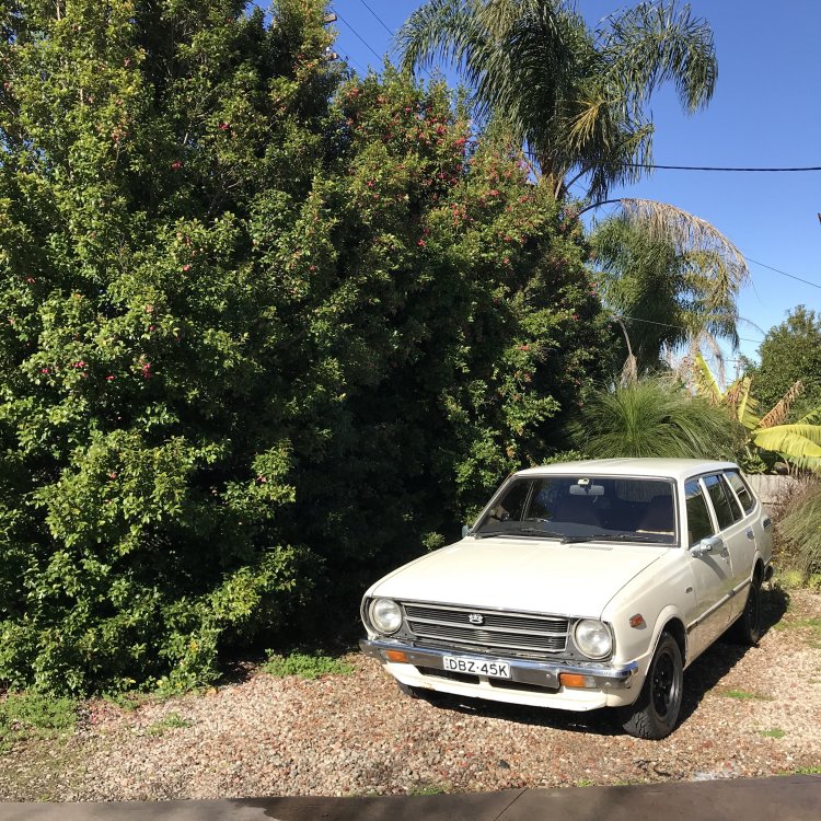

For the passed 5 years I have dailyd my 36 wags. Was long overdue for some love but between living out of home and working full time it never quite got the love it deserved. Thanks to COVID I didn’t have to worry about either of those things. So, here’s a pretty comprehensive list of all the work I’ve done over the passed couple of months. Only a couple things left to do to the rear springs then I’m sorted. Note I’m not a mechanic at all, just a hobby. Had to pop her in for a rust quote the other day. Hopefully it doesn’t stop my heart. Thanks! :)

Nice one Mason that will keep her going for a bunch more years to come. Great to get something good out of a bad situation.
Happy Rolla-ing

Hi Mason,
                   Thanks for the pics !  You really have been busy on your KE36 recently.   What  region of NSW are you located ?
I actually had  a KE36, exactly the same as yours, years ago.  It actually was white also.   Went to Rolla heaven years ago.  Died of the dreaded "cancer".
Has yours really only got  73K klms on the clock ?  Definitely, worth looking after.
