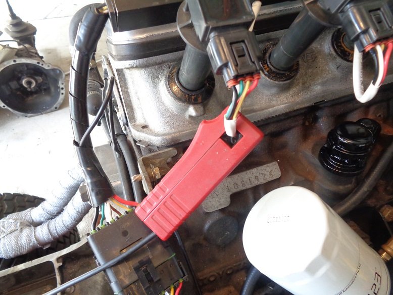

Banjo Posted November 30, 2020 Author Report Posted November 30, 2020 (edited) Been a couple of months, but it's been a slow & different year for everyone I guess. The Speeduino ECU underwent all the bench tests, & has finally migrated to the garage, & got hooked up to the 5K engine on the stand, controlling the ignition initially, in full sequential COP mode. After setting up the initial tooth wheel settings, the engine fired up, first time, & was rock steady, on the strobe timing light. The trigger clamp on the timing light, designed to go around a spark plug lead, would not go around the exposed COP tube. I used a work around, as pictured above, but discovered that the sensor would trigger the timing light, if it was placed close to the head of the COP. It worked perfectly. The removal of the distributor, requires it being replaced by a dummy drive shaft, to allow the camshaft to continue to drive the all important oil pump. An old 3K Denso dizzy cut down, with a 35mm cup type welch plug as a cover, provided a perfect dummy drive shaft. The synch pulse from the camshaft is provided by a Hall effect sensor that is mounted on the timing chain cover, detecting a single rare earth magnet, fitted to the camshaft sprocket. So a week or so, playing around with all the Speeduino settings, & then it will be onto the next stage, of fitting my 7K EFI throttle box & inlet manifold, & hooking up all the fueling requirements. P.S. For those of us, familiar with rotating the dizzy to set initial timing, & watching the timing marks jump backwards & forwards, at idle, due to the slop & take up in chain & drive to the dizzy; the first thing you notice about crank toothed trigger wheel triggering; is how rock steady & accurate it is. Cheers Banjo Edited November 30, 2020 by Banjo Quote
