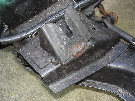

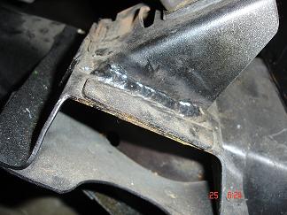

I d pull old motor out, lower the new one in and see how it is going to sit and then work out if anything will hit anywhere i.e sump, exhaust manifold etc and then bolt up gearbox and see what you then need to do with your engine mount brackets (x/memeber brackets). Probably need to make up a little custom gearbox cross member too but that should be pretty straight forward i just used some 30x30 box section on mine and some piecs of flat bar. here is my brackets rewelded and in new postion after being relocated to suit my ca18det.
I d pull old motor out, lower the new one in and see how it is going to sit and then work out if anything will hit anywhere i.e sump, exhaust manifold etc and then bolt up gearbox and see what you then need to do with your engine mount brackets (x/memeber brackets). Probably need to make up a little custom gearbox cross member too but that should be pretty straight forward i just used some 30x30 box section on mine and some pieces of flat bar. here is my brackets rewelded and in new postion after being relocated to suit my ca18det.
