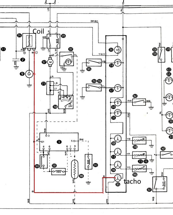

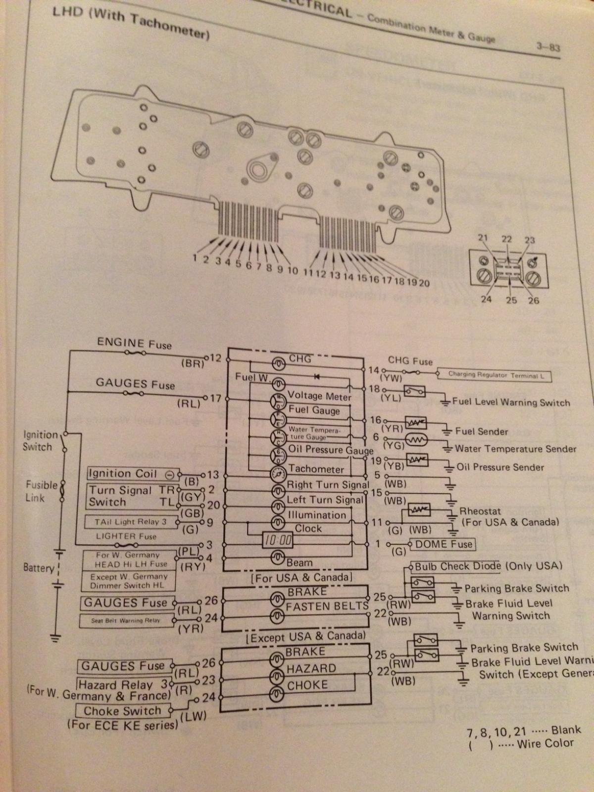

Hi guys can anyone help me my tachometer don't work do not kbow witch plug its co nected to there is 3 pkugs behind the cluster and strugling to find it can anyone help me please
Got a $10 multimeter??  It starts at the coil -ve terminal, a black wire, and ends up at the tacho.
Check and see that you have continuity from the coil to the tacho plug, and if that is fine then it must be in the tacho itself.
The pins are 13 and 5, black in and white/black earth out, although this is an American diagram.
