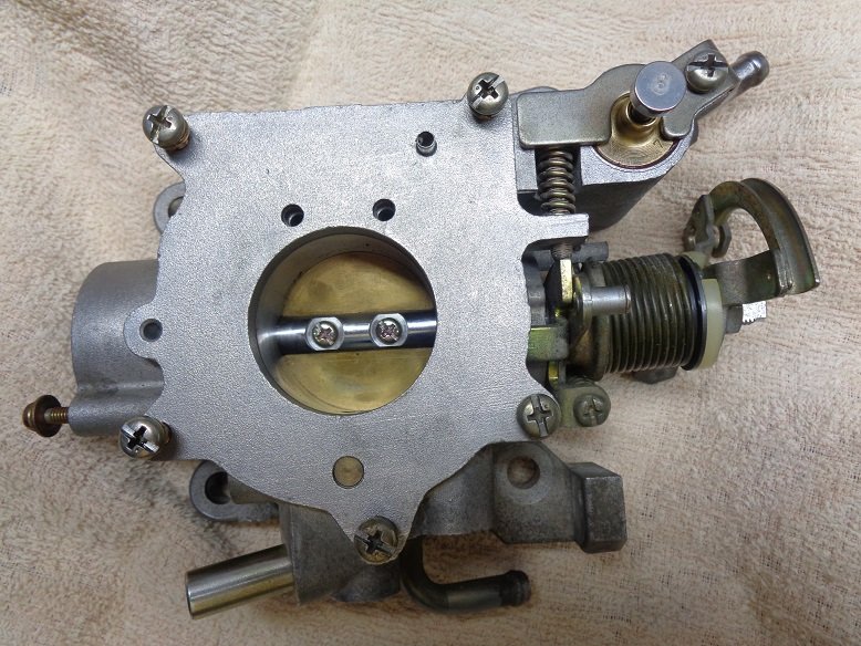

Top view of the throttle body.  The thermostatic idle control for cold engine is seen in the top RH corner of picture.

This is the cold engine idle control, which is disengaged, once the coolant reaches temp. Have measured it compressed length at room temp, then dropped it in a saucepan of hot water, withdrew it, & measured it again, to ensure it had expanded.  Works well.
One trick I found worked well, last night, while tracing the passage ways in the body, was to shine an LED pencil light into a hole, in a dark room, & then pier into the other holes, to see which ones were joined. There was enough reflection from the passageway walls, that you could see the light around bends & corners.
