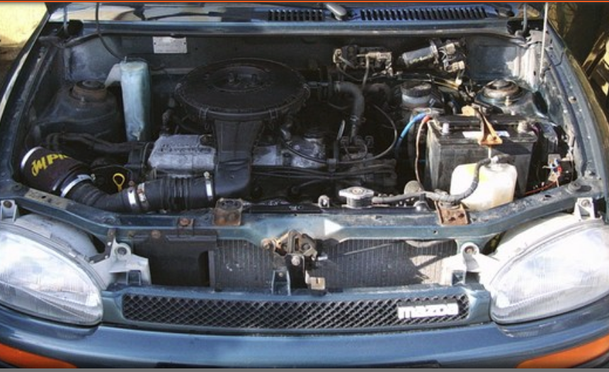

Banjo Posted January 1, 2019 Report Posted January 1, 2019 (edited) Lots of people seem to have troubles with the aging Aisin carbies, we were provided with on our early Rollas. I know there are other carbies been taken up over the years, both upright & side draught, but many are expensive. Query came to me over the weekend, that I thought someone may have already tried. A mate, which I haven't seen for 12 months called by, & drove his daughters Mazda 121, which he had been working on. I had not seen it previously, & when he lifted the bonnet, I commented that it was naturally aspirated, as a carby was what I would have expected to find under an air filter housing looking like that depicted below. However, the answer was no, & when the filter was removed, what was in view looked like a carby, but was in fact a single injector EFI throttle body, that looked like a carby. The injector is in the throttle body proper, under that dome in the venturi. The Mazda 121 engine it was fitted to is a 1.3 litre, like our 4Ks. Now this looked a lot simpler than the single injector EFI setup on the Starlets, & I wondered whether anyone on here had ever investigated trying the Mazda one out, on a 4K Rolla engine ? Cheers Banjo Edited October 31, 2020 by Banjo Quote
parrot Posted January 1, 2019 Report Posted January 1, 2019 How does it determine fuelling? Is there some sort of rudimentary ecu? Quote
Banjo Posted January 1, 2019 Author Report Posted January 1, 2019 (edited) Yep ! Just like the rudimentary one, I guess, came on the Starlets. I believe it has a TPS incorporated, & a MAP sensor. Will do a bit more research today. Edited January 1, 2019 by Banjo Quote

Banjo Posted January 4, 2019 Author Report Posted January 4, 2019 I think the Chaser SX80 was like a Japanese version of our Cressida ? Think they had a 1.8 liter engine, so maybe the throttle body would be a mite big for a 4K engine. The Mazda 121 appealed, as it, like the 4K, is 1.3 liters, so could work well, despite the 121 having crossflow head & 16 valves (we wish). All that could possibly be needed, may be a simple adaptor plate to mate it, to the 4K inlet manifold ? I might chase up my mate with the Mazda 121, next weekend, & have a very close look at the setup. Maybe the little ECU, that I assume drives the injector on the 121, would work, just as it is. Once I finish this distributorless 5K, I might get a 121 throttle body/carby thingo, & have a play. It might ultimately keep a lot more 4Ks rollin along a lot more efficiently, & smoothly, for a few more years. Cheers Banjo Quote
