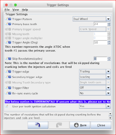

However, the Speeduino system does cater for what I am envisaging, with a trigger system call Dual Wheel, as described below, in the extract from their manual. This allows the Speeduino to simply continuously count the full complement of teeth of the flywheel, & reset it with an external signal from the camshaft line somewhere.
  Quote
38 CHAPTER 3. SUPPORTED DECODERS
3.3 Dual Wheel
3.3.1 Overview
A dual wheel trigger is one where there is a primary multi-tooth wheel combined with a secondary single pulse to
provide location information. The primary input should contain no missing teeth. Both pulses can run at either cam
or crank speed, but sequential operations requires that the secondary pulse is located on the cam. The design of the
secondary trigger can vary (Eg a single short tooth, half-moon wheel etc), provided it only provides a single pulse per
revolution.
Tooth #1 is defined to be the first tooth on the primary wheel AFTER the pulse on the secondary wheel.
3.3.2 Applications
Dual wheel triggers are standard fitment on a number of Euro make cars, particularly those from VW and Audi. They
are also a popular aftermarket fitment due to their simplicity and ease of fitment.
Expand
  Quote
Fields:
Primary base teeth: This is the number of teeth on the primary input wheel. If the primary wheel is located
on the cam (or is otherwise running at cam speed), divide it’s teeth by two for this setting
Trigger Angle: This is the angle in crank degrees AFTER TDC (ATDC) of the first tooth on the primary
input, following the single pulse on the secondary input.
Trigger edge: Whether the trigger will be taken from the leading (rising) or trailing (falling) edge of the primary
input
Secondary trigger edge: As above, but for the secondary input
Expand

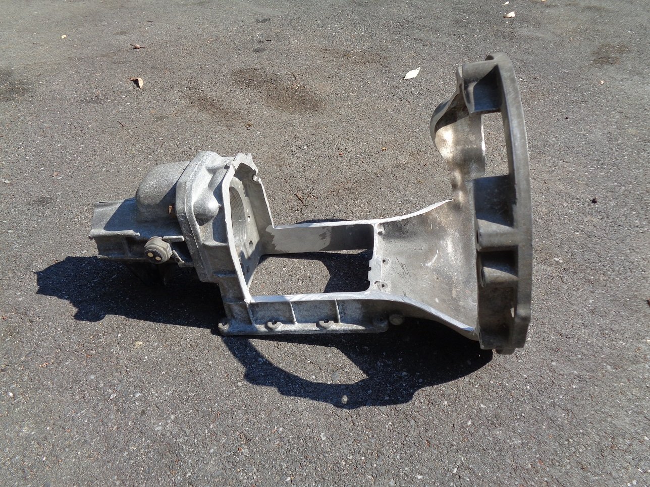

Currently, just building a "convertible open top K40 gutted gearbox", so I can run the engine on the test rig, at 3K - 4K rpm, and have a look at the pulses on the CRO again, & be able to strobe the degree wheel on the flywheel.
An hours work with a hand held grinder, with a metal cutting disc & grinder !

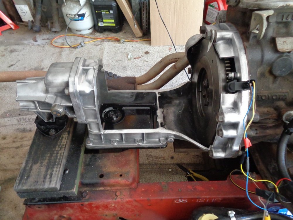

I got around to fitting the gutted K40 gearbox, & attaching the flywheel ring gear Honda crank Hall Effect sensor in its final position.
Was able to run the engine up to 3K - 4K rpm, & view the output of the Honda crank sensor switching perfectly off the flywheel teeth.

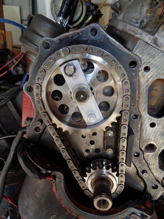

Well it's the weekend, & I've some time to work on programming the crankshaft positional sensors, I've installed, to create a sequential ignition system, which is totally independent from the ecu, which does all the engine performance "timing calculations".  So far, the results are exceeding my expectations, & electronically, it is not that difficult.
I'm seriously thinking of implementing another form of "synchronisation sensor", rather than the Hall Effect sensor, I've detailed above, that is fitted to the camshaft timing chain sprocket.
Don't get me wrong, the timing chain sprocket sensor works very well, but is time consuming & a bit difficult to implement.  Because the synch signal has to produce a pulse once every two revolutions of the crankshaft, it must be produced from the camshaft timing. The easiest way is to simply use the existing dizzy points, or with an optical/Hall Effect sensor fitted therein.   However, this project is about getting rid of the dizzy totally, so that's not my option. The other point on the camshaft, where a signal could be obtained is the fuel pump's eccentric "operating lobe", on the camshaft.
This could be a very easy modification, if it works. Remove fuel pump.  Make little plate to cover hole in the block. Drill hole in plate. Fit Hall Effect sensor that will detect the tip of the eccentric lobe.  Hey presto !  Now I haven't got a fuel pump, so my idea is to just fit an electric one, so I can see on the road, in real-time, how reliable a signal would be from this source.
