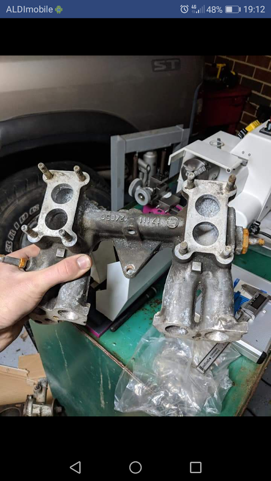

To complement the gearbox it looks like I've got a few other things lined up, too. I've decided to go traditional with a Sprinter twin-carb intake and individual Aisan carbies, plus a valve-spring upgrade and new camshaft. The specs on the cam look like about .425" lift and 225 degrees duration @ .050" lift. So, a nice peppy fast road type cam. Should be fun!
Now I just need to bolt all this stuff in and see how we go from there.
Yeah bought the Aussie one. Not a fan of water-heated manifolds though, they get enough exhaust heat in this sort of setup to solve most problems after about 3 minutes of driving time. Couldn't see if it was broken in the picture, may have been a different manifold you were referring to?
