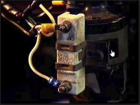

Banjo Posted June 28, 2018 Report Posted June 28, 2018 (edited) Can you take me some close up pictures of the ignition coil. Is it a sports or high performance coil ? Are you using points in the distributor ? I'm a bit concerned about the ballast resistor mounted next to the coil, which is tucked in between coil & mounting point. Your photos of the engine bay, blown up, do not provide me with enough resolution, but I can only see one terminal on the ballast resistor. Cheers Banjo Edited June 28, 2018 by Banjo Quote
Rolln666KE20 Posted June 28, 2018 Author Report Posted June 28, 2018 Its just a standard coil with a fanta can wrapped around it hahaha. I'll send you some pics of that area after work,if the ballast resistor. Also its running points yes Quote

Rolln666KE20 Posted June 29, 2018 Author Report Posted June 29, 2018 These pics should be better, the resistor is not touching the coil at all Quote
Rolln666KE20 Posted June 29, 2018 Author Report Posted June 29, 2018 Found the problem this must have blown, I'll get one bigger then 100A its running from the battery to the starter Quote
Banjo Posted June 29, 2018 Report Posted June 29, 2018 (edited) You shouldn't have one of those 100A fuses between the battery & starter. The big heavy cable between the battery +ve terminal & the starter motor should have nothing else in between. The starter motor current draw, is the highest current drawn by any part of your car. In Winter, it can easily be over 100 Amperes, whilst cranking. Your battery is probably rated at least, for 330 CCA (Cold Cranking Amps). The only high rated fuses needed in your car, are the two (2) fusible links, between battery positive terminal, & alternator, & the other one for everything else in the car. Those "MEGA" fuses are really there for things like fridges, big sound systems, dual battery systems etc. Lets know if it will start now. Cheers Banjo Edited June 29, 2018 by Banjo Quote
Banjo Posted June 29, 2018 Report Posted June 29, 2018 (edited) That ballast resistor behind the ignition coil should be mounted on the front of the bracket holding the coil, on those two little "wings" with the holes on them. Those ballast resistors get pretty hot, so they need air flow over them, so that's why they are usually mounted up in a free flow air area. Cheers Banjo Edited June 29, 2018 by Banjo Quote
