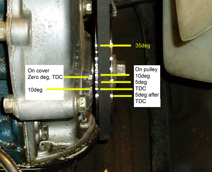

Can you take a photo or two??  Did the weights rotate the shaft when you pulled them out??
At idle the timing mark should start at 10deg to the left (anti-clockwise) of the zero deg, TDC, on the timing cover.
As you rev it the timing mark should move further anti-clockwise, out past 20deg.
This photo is set up with timing at 10deg BTDC, it will have the pulley marks move downwards (anti-clockwise) as it is revved. I had the daughter watch the tacho and hold the revs at every 500revs while I held the timing light on it.
All this timing is done with the vac hose off & blocked, as Rebuilder said, we are just measuring the effect of the weights.
