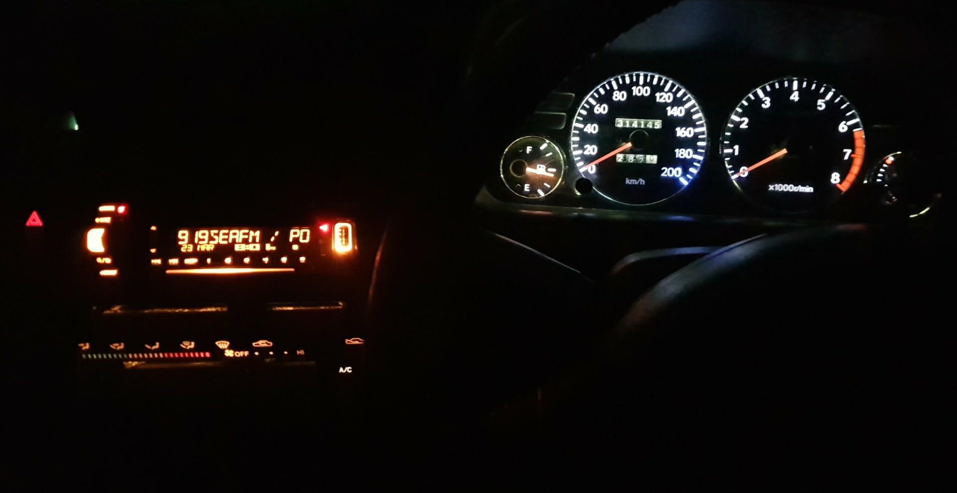

And some orange LEDs to match the dash to the  center console and head unit.
