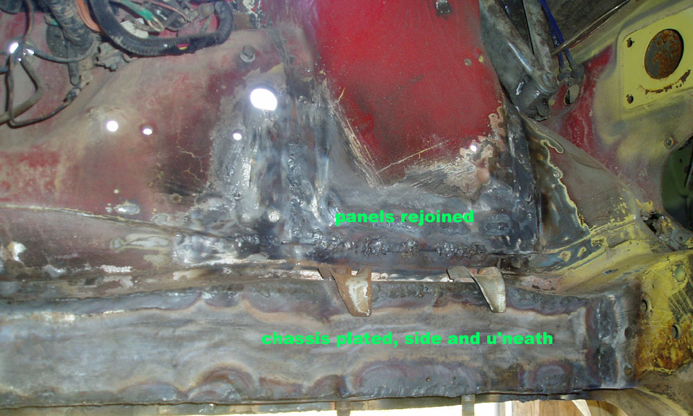

Depends how well you knew the panelbeater..  he'll want it up on stands with no crossmember or suspension, and all the paint stripped back to bare steel.
That makes transporting it difficult, so its easiest to get a panelbeater to drop in one weekend with a MIG.  Even Bruce at On The Spot mobile welding could come and do it. they'll all be $100+ an hour unless you can talk them down.
Then again, if you can find  a MIG or even a stick welder we can do it ourselves, same as the Celcia rally car.  When the race car is out of the shed put the wagon in and strip it, and we will see what steel we need to buy. The guy I built the verandah for bought a new stick welder for that job, we could borrow that.
