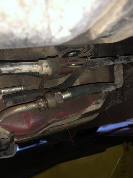

BoostBoy Posted February 4, 2018 Author Report Posted February 4, 2018 Okay so after a bit of digging around, I discovered I do in fact have to drop the tank. After looking at some youtube videos, it doesn't seem too hard. There are 3 fuel lines to disconnect, then the fuel intake hose and then the straps that hold the tank to the car. There is one fuel line I can't disconnect because I'm not sure which nut to unscrew. In my pic there is the nut with the blue arrow and the other larger nut with the red arrow. Which is the one I should be unscrewing? What are these fittings called so maybe I can search online? They are high pressure fittings as far as I can tell. I've attempted to undo both, but without knowing which way to unscrew them or which nut, I'll just damage the line, so I stopped. Quote
parrot Posted February 4, 2018 Report Posted February 4, 2018 That’s the pressure line. The small nut as you call it is like a large brake line fitting, and screws into the body of the larger ‘nut’. To undo it, hold the larger ‘nut’ with a spanner and undo the smaller ‘nut’ 1 Quote
parrot Posted February 4, 2018 Report Posted February 4, 2018 Ideally empty the tank as it can be surprisingly heavy when manoevering around under the car 1 Quote
BoostBoy Posted February 6, 2018 Author Report Posted February 6, 2018 Thanks for the info. I had already emptied the tank, so this was my next challenge. It’s a tough nut to crack (pun intended) I only had a shift spanner so when I was trying to loosen the nut it slipped and I think I twisted the whole thing. Pretty sure I damaged the pipe inside as now the body of the nut spins somewhat freely and a little bit of fuel dripped out. Both nuts are like they’re welded together, so tough! Tried lots of WD40. Just so I’m sure, which way should I be turning the smaller nut? Looking at it from the left in the pic I’ve been turning it anti-clockwise. Is that correct? I'm going to buy some open end spanners at the end of the week and try again. Quote
ke70dave Posted February 6, 2018 Report Posted February 6, 2018 (edited) They will be tight. you need proper spanners. Shifting spanners will round those nuts very fast. Edited February 7, 2018 by ke70dave Quote
BoostBoy Posted February 9, 2018 Author Report Posted February 9, 2018 I have proper spanners now and still no luck. I guess I keep trying until they crack Quote
parrot Posted February 9, 2018 Report Posted February 9, 2018 (edited) They are meant to be a tight fit, but once it gives they should separate easily. Be super careful not to round them off...... Edit, or twist the hard pipe! Edited February 9, 2018 by parrot Quote
