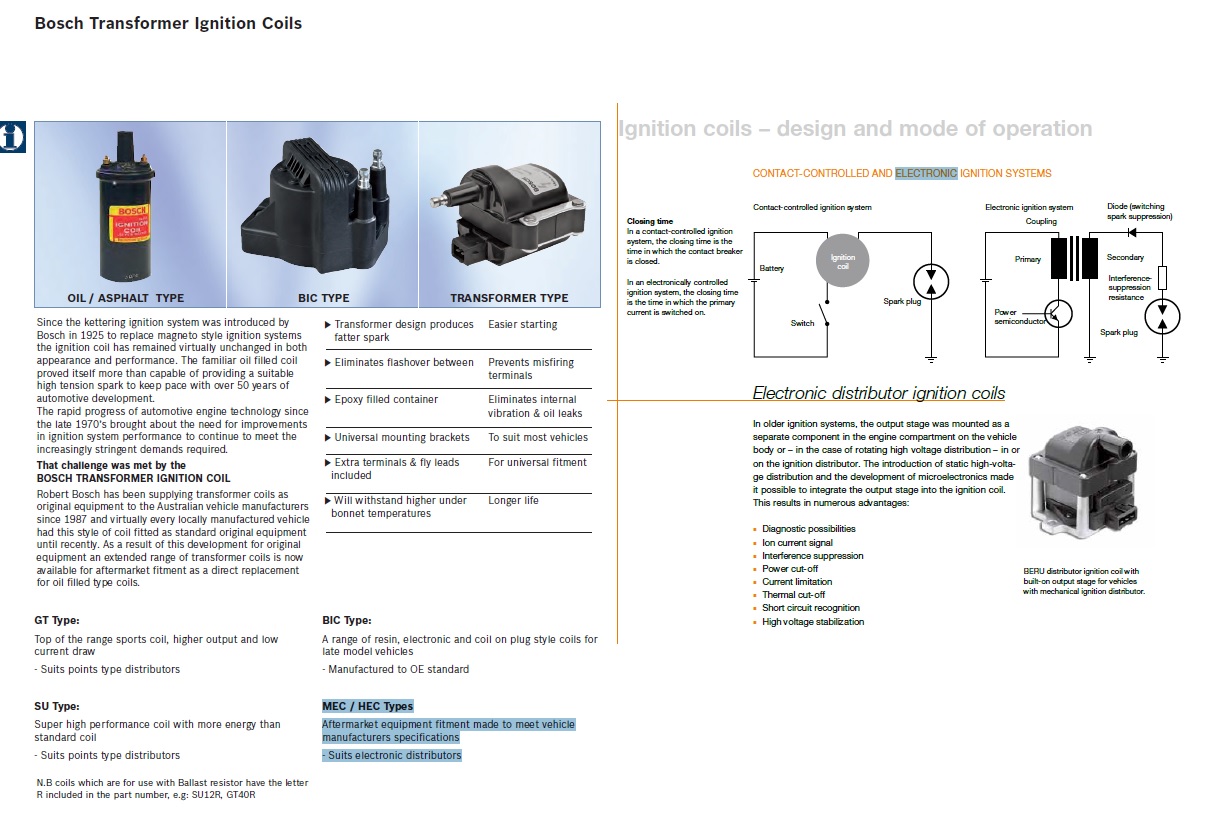

rebuilder86 Posted December 15, 2017 Report Posted December 15, 2017 (edited) i have been emailing hotspark about the 3 ohm thing and they (perhaps just a salesperson) assured me that their technology is superior in terms of spark quality but must be used with correct coils. according to bosch the coils that power most factory electronic distributors are HEI type, at less than 1 ohms and are usually (perhaps always) transformer coils.. this suggests to me that they can handle much more current. I'm quite certain of that finding. Bosch refer to electronic distributors as described in this screenshot and talk about the HEC suitablitiy their appropriate coils as HEC or MEC. These are always low resistance coils. And then this from the product specs (see bold ohms ratings) Part Number Outputs Type [ohms] [ohms] Connector Terminal Comments GT40R 1 Oil Filled 1.2 8 - 10 K M4/M5 Standard Canister type GT40RT 1 Transformer 1.5 8.6 K M4/M5 Standard Type “A” HEC 715 1 Transformer 0.41 7.8 K M4/M5 Standard Type “A” HEC 716 1 Transformer 0.41 7.8 K M4/M5 DIN type Type “B” MEC 717 1 Transformer 0.45 6.6 K M4/M5 Standard Type “A” MEC 718 1 Transformer 0.45 6.6 K M4/M5 DIN Type Type “B” 9 220 061 710 1 Transformer 0.4 7.8 K M4/M5 DIN Type Type “B” 0 221 503 407 2 x 2 Epoxy Filled 0.5 13.3 K 1 237 000 039 Standard Double ended coils 0 221 503 002 3 x 2 Epoxy Filled 0.5 13.3 K 1 287 013 900 Standard Double ended coils Edited December 15, 2017 by rebuilder86 Quote
rebuilder86 Posted December 15, 2017 Report Posted December 15, 2017 sorry i should say HIGH CURRENT FLWO TO THE HALL EFFECT SENSOR, but there is a constant flow. as opposed to none with a reluctor type. Saying that, the overheating issue is with the switching on and off side, not the powered side(dependant on the current coming from the coil) so perhaps i shouldnt have mentioned it at al as it will just create confusion. Quote

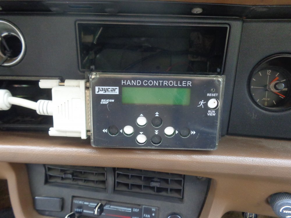

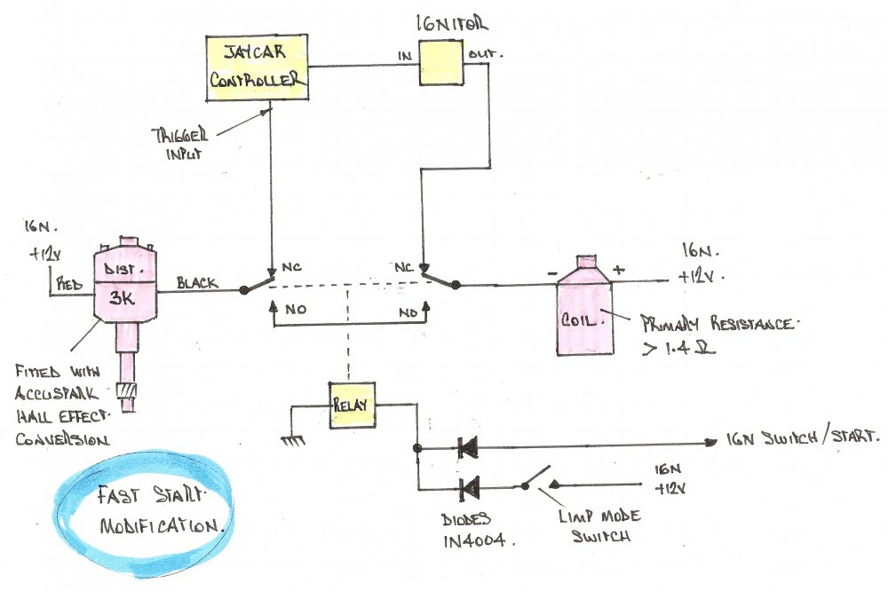

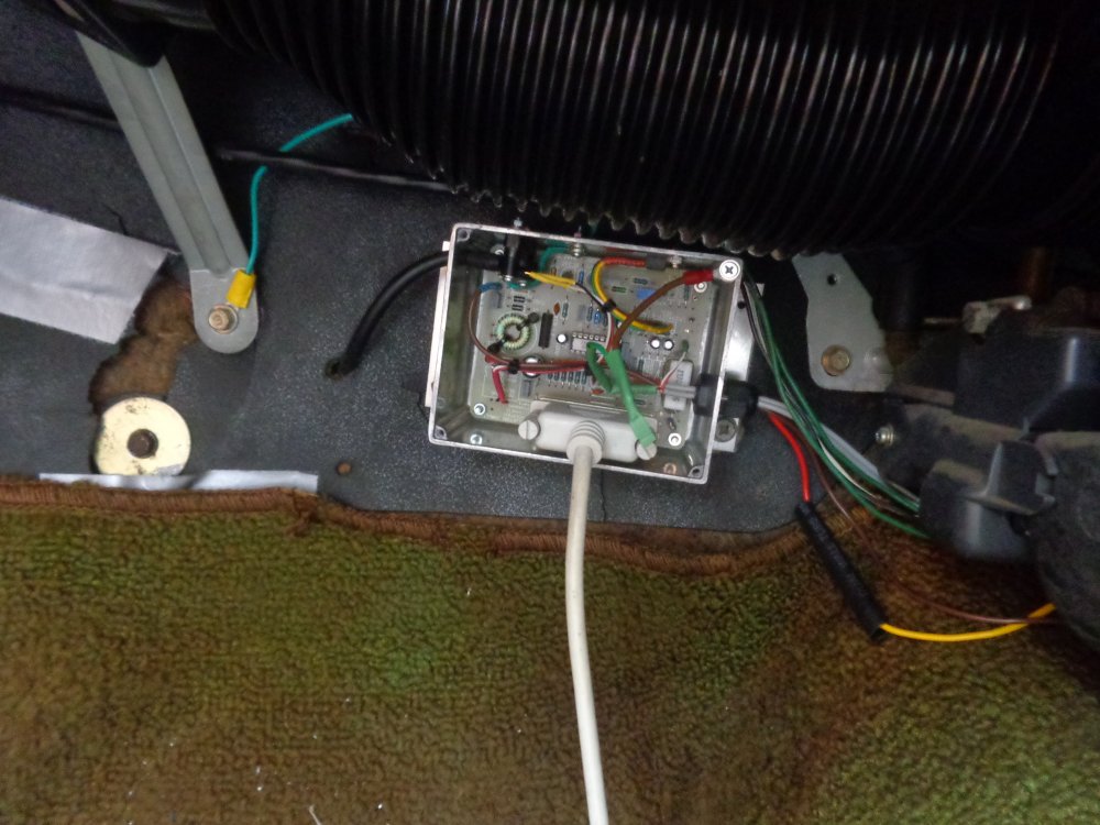

Banjo Posted December 20, 2017 Report Posted December 20, 2017 (edited) Early in this thread, I mentioned the Jaycar programmable ignition system, which I have had in my KE30 2 door for a number of years. These modules can be triggered by various means, including points, if you so desire. Quote I should declare, that although I use the Accuspark, I don't use it to charge & switch the coil, as intended. Instead of the coil, I have a 100 ohm resistor tied to +12V, and this produces a lovely square waveform, which I use to trigger the input of a Jaycar programmable ignition system, where you can set the advance curve easily to anything you want or need. My dear olde Denso 3K dizzy (smallest one ever fitted to Rollas) has been gutted, & the bob weights removed & the two ends of the shaft locked together with tie wire & Araldite, so there is no movement at all. Absolutely perfect result, which once I got the curve right, has never been touched since. Expand This kit from Jaycar was released in 2007, so it is 10 years olde. It was one of Silicon Chips most successful kits. I notice Jaycar are selling them out at present. Originally, they sold for nearly $ 100.00. At the moment they are $ 22.92 ea. https://www.jaycar.com.au/programmable-high-energy-ignition-system/p/KC5442 If you want to get into programmable ignition at a basement bargain price, then now is the time. Jaycar are out of stock, for on-line sales, but various Jaycar stores around Australia have them in stock. Just click on the store check, in the link above, & pop in your postcode, to find the nearest store. Most stores in Brisbane have them. I happened to be in Canberra at the moment, & picked up their last two kits at Jaycar's Fyshwick store this morning. The Programmable Ignition System kit comes with comprehensive instructions. Not normally available on-line, but found a website where someone has posted it, if anyone wants to have a read of it's capabilities. http://www.vespalabs.org/@api/deki/files/479/=kc5442_Programmable_High_Energy_Ignition_System.pdf Cheers Banjo Edited December 21, 2017 by Banjo Quote
