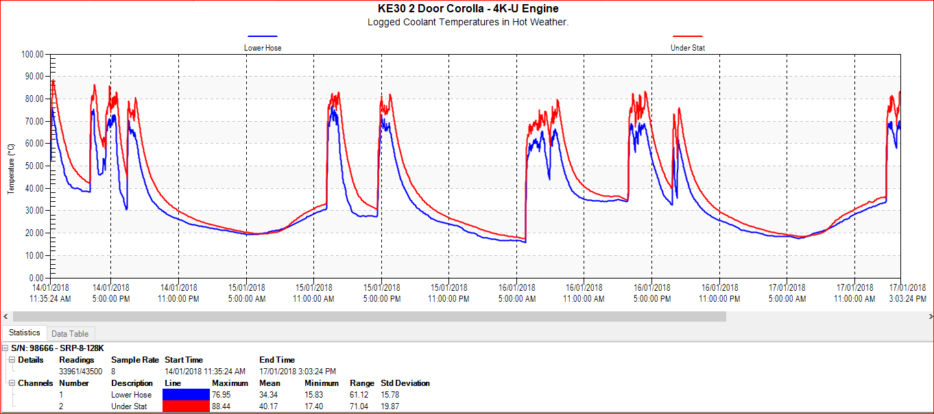

Banjo Posted January 18, 2018 Report Posted January 18, 2018 (edited) We've had a spot of very hot weather in the past week or so, so I thought it might be a good idea to check the health of the cooling system. I have two (2) coolant temperature sensors fitted to the engine. One is in a spare spot, in the thermostat housing, directly under the thermostat, which is the point in the engine, where the coolant is hottest, & controls the thermostat opening. The other is in the lower hose, where the coolant should be at lowest temperature after passing down through the radiator. The difference between these temperatures, indicates the efficiency of the radiator. By logging both temperatures, you can see everything changing. You can see the max temp is about 88 deg, which is when the thermostat opens, & the temperature drops. The difference between the readings, is the cooling effect of the radiator. These were short runs, so the wiggly bits at the top of the graph, could well be stopping at traffic lights. When you do a long run in the country, the wiggly bits are the thermostat opening & closing. Look how long it takes the block to cool down, even over night. I forgot to hook up an ambient temperature sensor, so you can relate these temperatures to the prevailing O/S air temps at the time. Next time ! Here is a shorter/zoomed section of the above graph, depicting just one early morning trip to the city, to drop my daughter off to work. Note that the coolant temp, only once reached 80 deg C, so it it is probable that the thermostat never really opened, because it was just after dawn. The lower temperature (blue), is a result of the ram effect of the air through the radiator. This is where a thermofan can assist, as the fan would be off, unless the temperature exceeded say 90 deg C. I am considering fitting a thermofan, as the engine is then not driving the fan constantly, and sucking a couple of HP, that could be better spent, going to the wheels. Cheers Banjo Edited January 18, 2018 by Banjo Quote

rebuilder86 Posted January 18, 2018 Report Posted January 18, 2018 these graphs are so damn awesome, thank u banjo for taking the time to post them. this is the kind of data i trawl the net looking for to learn about efficiencies and just how things realy work in practice. i don't quite follow ur point about the thermostat not even opening in the 2nd chart. is 88 degrees (as marked on tstat) the beginning opening temp? surely if the tstat didnt open at all over an hour of driving it would just get hotter and hotter?? Quote
Banjo Posted January 19, 2018 Report Posted January 19, 2018 (edited) Quote surely if the tstat didnt open at all over an hour of driving it would just get hotter and hotter?? Hi Jeremy, I know you live a bit closer to the equator that we do, and it is probably on average hotter where you are, than what we experience, here in Australia. However, it is quite possible for the thermostat to not open at all, if the temperature of the coolant, doesn't reach the cracking open preset temperature of the thermostat. Generally, thermostats made by all the major manufactures, start to open somewhere between 80-84 deg C, & are fully open by about 95 deg C. Over this temperature range, the thermostat opens usually 8-10mm. You can pop a thermostat in one of your lady's saucepans, on a gas stove, (a practise my wife always frowns on) & watch this clearly. A thermostat is not an on/off device. It will open proportionally, dependent, on the temperature. So if it starts to open at 80 deg C, & is fully open at 95 deg C, (15 deg C spread) if you held the temperature at 87.5 deg C, then theoretically, it should hold at half open. Thermostats do not usually fully cut off all water flow. Most engines, including your 4K, have thermostat bypass circuits, where a nominal amount of flow occurs all the time. Toyota Yellow Workshop K Series "Bible" Page 5-2 Even the thermostat you use, will have a little hole in it, to allow water to flow a little, & stabilise pressure across the thermostat itself. There is no rubber sealing point on a thermostat. It is a simple metal to metal immersed thermostic controlled water flow valve. There are other ways of cooling the engine coolant, besides the radiator. Airflow over the block, despite it having just removed some heat from the radiator fins, is still much cooler than the coolant & block temperature. In very cold climates, where it is difficult to get engine & coolant temperature up to ideal operating temperatures, they block off the radiators all together, during winter, so that the thermostat can open up, & water flow increase. Many big diesel tracks, have grills in front of the radiator, that are actually louvres/shutters, that open & close, manually, or under thermostatic control, to reduce airflow. In winter in some very cold countries, it is common, to add electrical heaters inside the car, as turning on the heater, & "pinching" some of the engines heat, to heat the cabin up, is very detrimental to the engines performance. Most cabin heater water, never passes through the thermostat, because the take off point is behind the thermostat. The first 15-20 minutes of driving a car, is the period when it is most inefficient. Most wear in your car's engine, occurs in the first 2 minutes of driving, after starting the car from a cold start. That's why taxis used on shift work, which barely stop all day, get such extremely high kilometers out of their engines. Sorry to be so verbose, but to answer your query, the engine will not get "hotter & hotter", because as soon as it reaches 80-84 deg C, the thermostat will open, more water will flow through the radiator, & the coolant temperature will stabilise, or ideally maintain a temperature below boiling point of the coolant. Cheers Banjo Edited January 19, 2018 by Banjo Quote

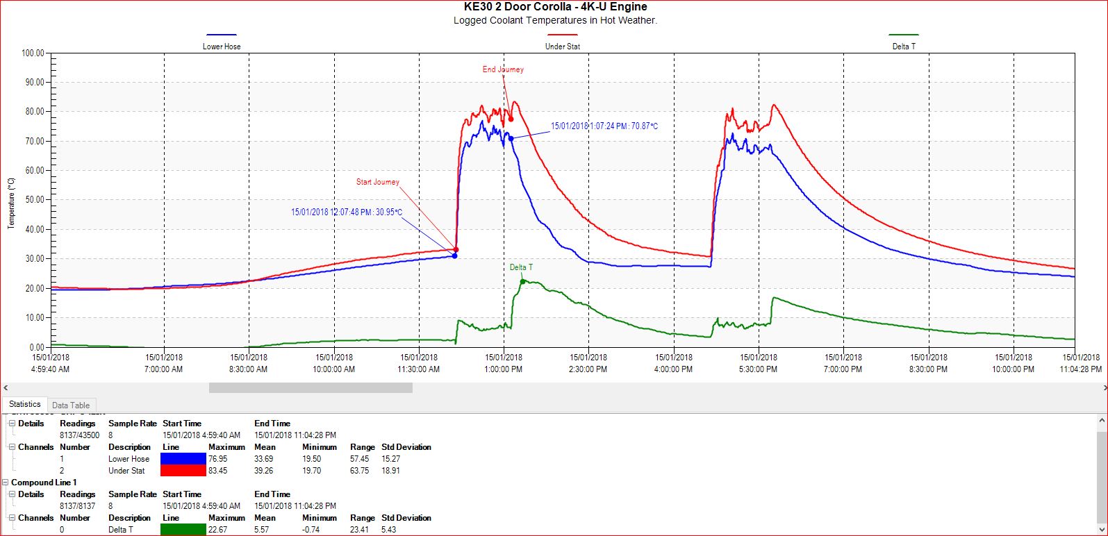

ke70dave Posted January 19, 2018 Report Posted January 19, 2018 look at all this science! how exciting. Love the pre-post temperatures above. I always wanted to do a pre-post temperature across an intercooler. Be very nerdy and interesting to watch the delta T change in different conditions. Quote
Banjo Posted January 19, 2018 Report Posted January 19, 2018 (edited) Hi Dave, Any decent data logging software these days, allows you to create additional graphing lines, that are parameters, not directly measured, but are functions of the parameters that are measured. DeltaT = T1 - T2, or common arithmetic ones like Power = Amps x Volts Here is a section of the graph above, showing Delta T, for the temperatures at each extreme of the coolant system. They say, "what gets measured, gets managed", or "without data, it's just a matter of opinion". Once you see data graphically, you see all little things that actually do happen, but are unseen generally. eg: Where the journey ends, on the red trace of top engine coolant temperature, the temperature actually rises, after you turn the engine off, whereas, the bottom radiator hose water temperature just falls away, immediately. Logical, when you think about it, but that is why cars with turbos & thermostatic coolant fans, "run on" after the engine is switched off. You walk through a shopping centre car park, on a hot day, and you can tell the cars that have recently been vacated; all sitting there, with electric fans purring away. Cheers Banjo Edited January 19, 2018 by Banjo Quote
