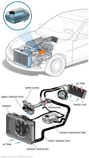

rebuilder86 Posted November 9, 2017 Report Posted November 9, 2017 yes but those were as u mentioned, screw on caps. that makes them similar to the current day expannsion tank system, where the expansion tank is connected to the radiator and they are reinforced and look like this. layout what they look like. https://www.google.com.ph/search?client=ms-android-oppo&biw=360&bih=266&tbm=isch&sa=1&ei=xsYDWou4B4HQ0ASM87bQAQ&sjs=3&q=radiator+expansion+tank+design+holden&oq=radiator+expansion+tank+design+holden&gs_l=mobile-gws-img.3...37445.38508.0.39043.8.4.0.0.0.0.309.728.0j1j1j1.3.0....0...1.1j4.64.mobile-gws-img..5.0.0....260.cZZTWxlUkss#imgrc=QYMEbmuHLqUBzM: we don't have this, we have a pressurised system, and it must have little to no air. Quote
