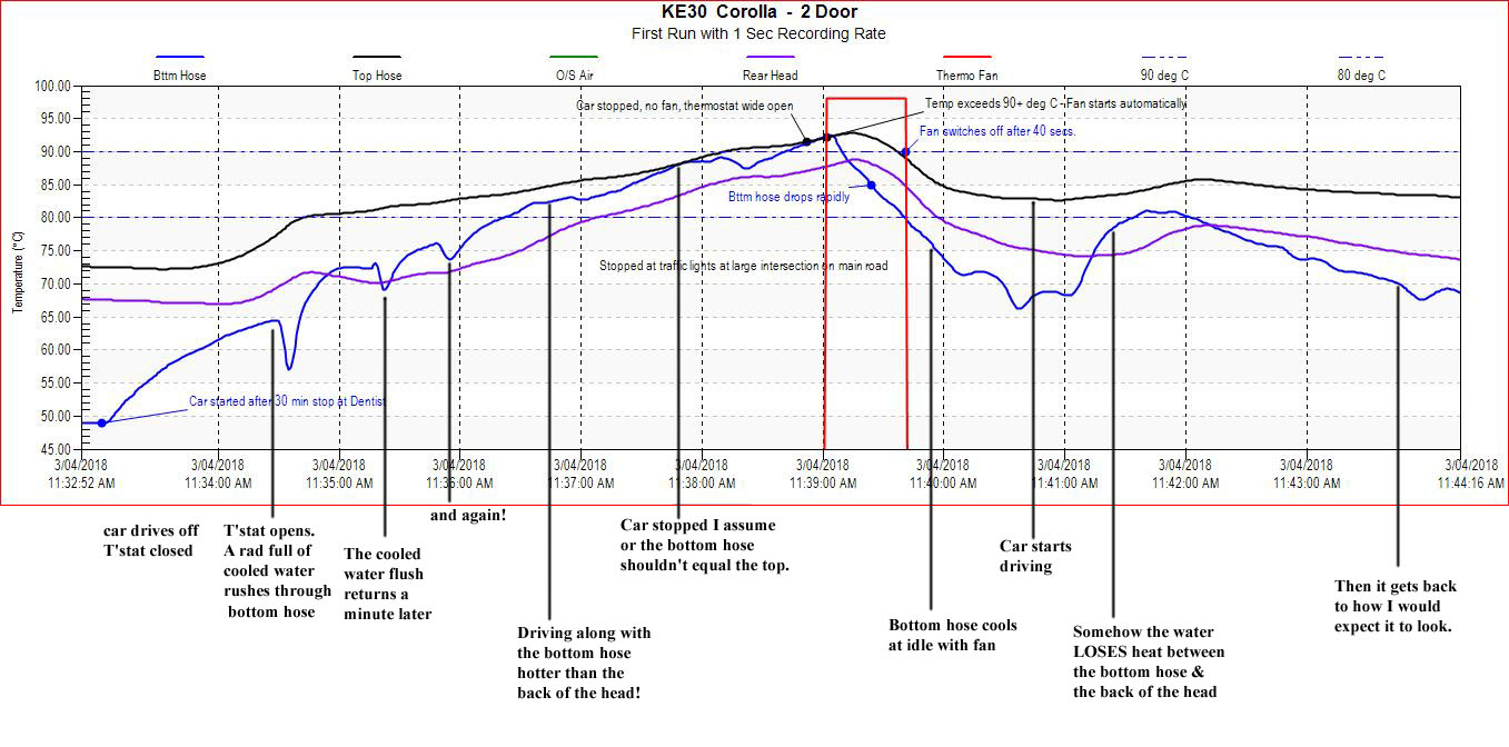

OK, so went to the Dentist & back, & recorded the trip at 1 second intervals.
Here is the complete trip.
This following graph is the trip home.
The differential between the front & rear of the head is still around 9 deg C.
However, despite that, the thermostat is working perfectly, maintaining the coolant temperature between 80 & 90 deg C.   The graph below shows that clearly, and the thermofan kicking in, whenever the car physically stops, & the temperature shoots up over 90 deg C.
Next step will be to reinstate the radiator 15mm bypass  hose, & see what transpires, after a run with that.
P.S.  Still can't believe the lower radiator hose temperature drops so quickly to around 50 deg C, after stopping the car.
Cheers Banjo
Edited by Banjo
Well, the back of the head gets cooler than the bottom hose...!!  That sudden rush of flow when the t'stat opens every 5min means very little cooling gets done and the bottom hose temp gets hotter than the back of the head. Then it cools for 4 minutes or so until the next pulse. I thought the t'stat would have a more even flow, but all three measuring points show the same cycle of up and down..
.. and both bottom and top hose have a max temp of 93deg, so no cooling w/o the fan when stopped.

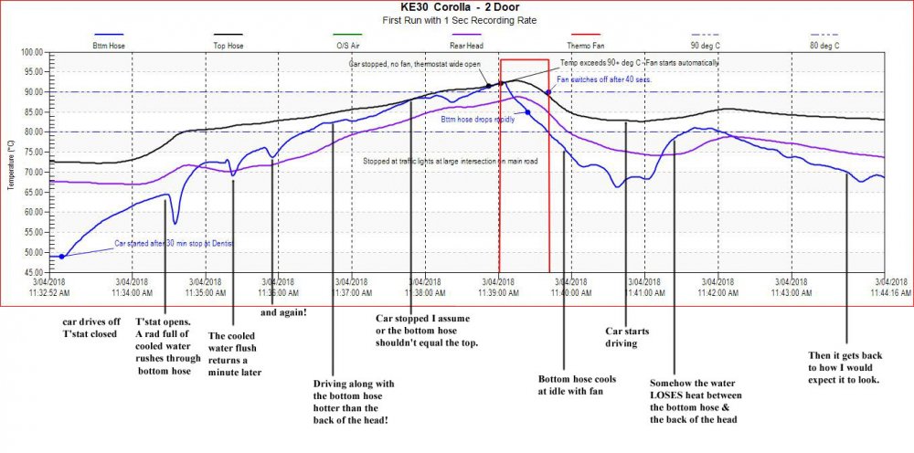

Hi Keith,
Although initially it sounds strange, that top & bottom of the radiator could be at the same temperature.  When you think about what is happening, it is not so strange at all.
Here is a graph of that small period of the previous graph.
The Rolla had only been stopped at the Dentist for about 30 minutes, after the trip there, so the coolant was still at an elevated temperature above ambient, at around 48 deg C, when the car is started.
The fan is not running at all, but the water pump is. However, by the time the temperature reaches say 87 deg C, the thermostat is fully open, & as water pump is running, so coolant flow through the radiator is constant, & therefore top & bottom radiator coolant temps are at the same temperature.  However, as soon as the temperature of coolant at the thermostat area reaches 92+ deg C, the electric thermofan switch automatically kicks in. The radiator then does it's thing, & the bottom hose temp instantly drops rapidly.  That cooled water then feeds through the engine block/head, and within 30 secs. the top hose temp starts to drop off also, to then be controlled by the thermostat, & held at between 80 & 90 deg C.  All good, as should be. Note the fan ran for only 40 seconds, before it dropped the top hose temp; to the point where the fan was not required any longer. Your earlier point about the fan hardly ever required, is proving very, very true.  What a waste of power driving that old plastic fan all the time.

Quote
only if the car is not moving. 3 or 4 minutes stopped? 11.37.30 to 11.40.30??
Are all three at the same temp before you start the car in the morning??
I can't get my head around the bottom hose being hotter than the back of the head! Something is not right...  Swap those two sensors over! The back of the head and the top rad hose  follow each other well, but the bottom hose..
