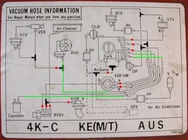

rebuilder86 Posted October 6, 2017 Author Report Posted October 6, 2017 interesting about sulphamic acid, never heard of it, and ill probably be shit outa luck ever getting it on my carb. No hardware stores here in philippines would even know what anything about the subject other than the word acid and would have no idea there are different types. Toilets here are cleaned with chlorine., so everyone's toilets smell like a public swimming pool haah And I'm sure airlines would be super happy about seeing it in my baggage, so flying it over is out of the question. for all those out there with the idle problem, my experience shows thus. The kp61 and KM20 series carb by asian, that is the one with a vacuum diaphragm operated secondary throat, and all the complicated vacuum hoses everywhere, come with a 0.45 or 0.48 mm slow idle jet. this is simply too small and is a cock up and no engine with a functioning stock PCV valve will idle in this configuration at anything less than 900 rpm, by opeing the base idle screw. The other carb, as illustrated in your scan, of the one where the secondary throat is governed (allowed to be operated) by a mass air flow valve inside the throat, comes in slow jet sizes: 0.45, 0.47, 0.5 and 0.53 mm with the latter being the jet size for the 4K-C. This 0.53mm is getting close, but to idle at 800 rpm the pcv will need to be almost blocked and your hot idle compensator valve must be in pristine working order and not leaking at all. For me it had to be ground open to about 0.6mm and then regulated by the mixture screw. To repair the hot idle compensator, just take the cover off, pull the valve assembly out, and spin the little rubber seal block around and it should be good for another life. interesting also to note that the factory manual states, for this mass air flow valve carby, as illustrated in your pic, the mixture screw setting ranges from: 1-1.5 turns from seat \ (4k-C) 2-2.5 turns from seat \ (2k and 4k) 3 turns from seat \ 3k-c and 3k-H The 3 turns is because of the smaller displacement of the 3k motor, which at idle, is not enough suction to suck out the fuel from a 0.47mm jet. But then again, the larger 4k motors require more total fuel at idle, hence the larger slow jet and smaller mix screw opening. This setup is the best, as more fuel is allowed to the point of atomisation where it is restricted only for the purpose of atomisation. The smaller jets restrict the flow with no benefits of aiding in atomisation. they in fact decrease the atomisation because less fuel is allowed to flow through the opening. In short, reveres the idle circuit setup, because the engineers cocked up. the biggest restriction should be at the exit point, the idle port. Quote
