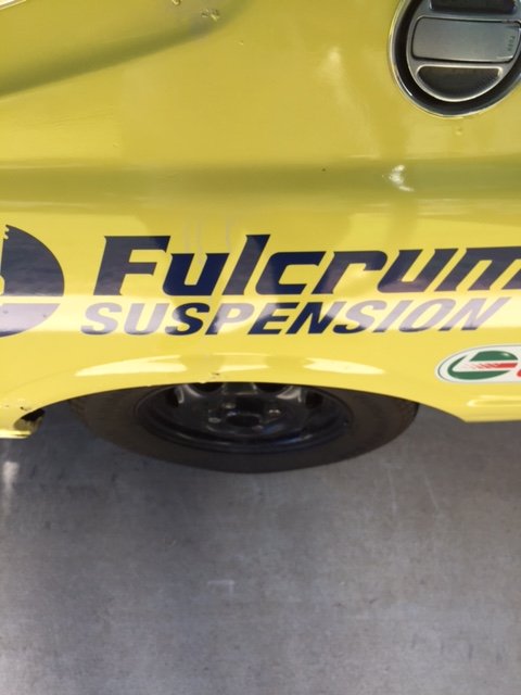

I have a bunch of cars, but i really want to talk about the ke35 hardtop ive recently purchased
This car is a gorgeous little thing
Running orig 3k drive train, with minor mods (extractors, side pipe)
Car has been set up for comp with half cage, seats and harnesses, oil surge protect, electric fans, electric fuel pump, adjustable front suspension, rear stripped & floors stripped.
No rust, no dings, never an accident. (not bragging i swear)
Blank canvass
Also incredibly its recently road registered and will be again Vsoon with just the side pipe to change (for about an hour for inspection till it goes straight back out the side again)

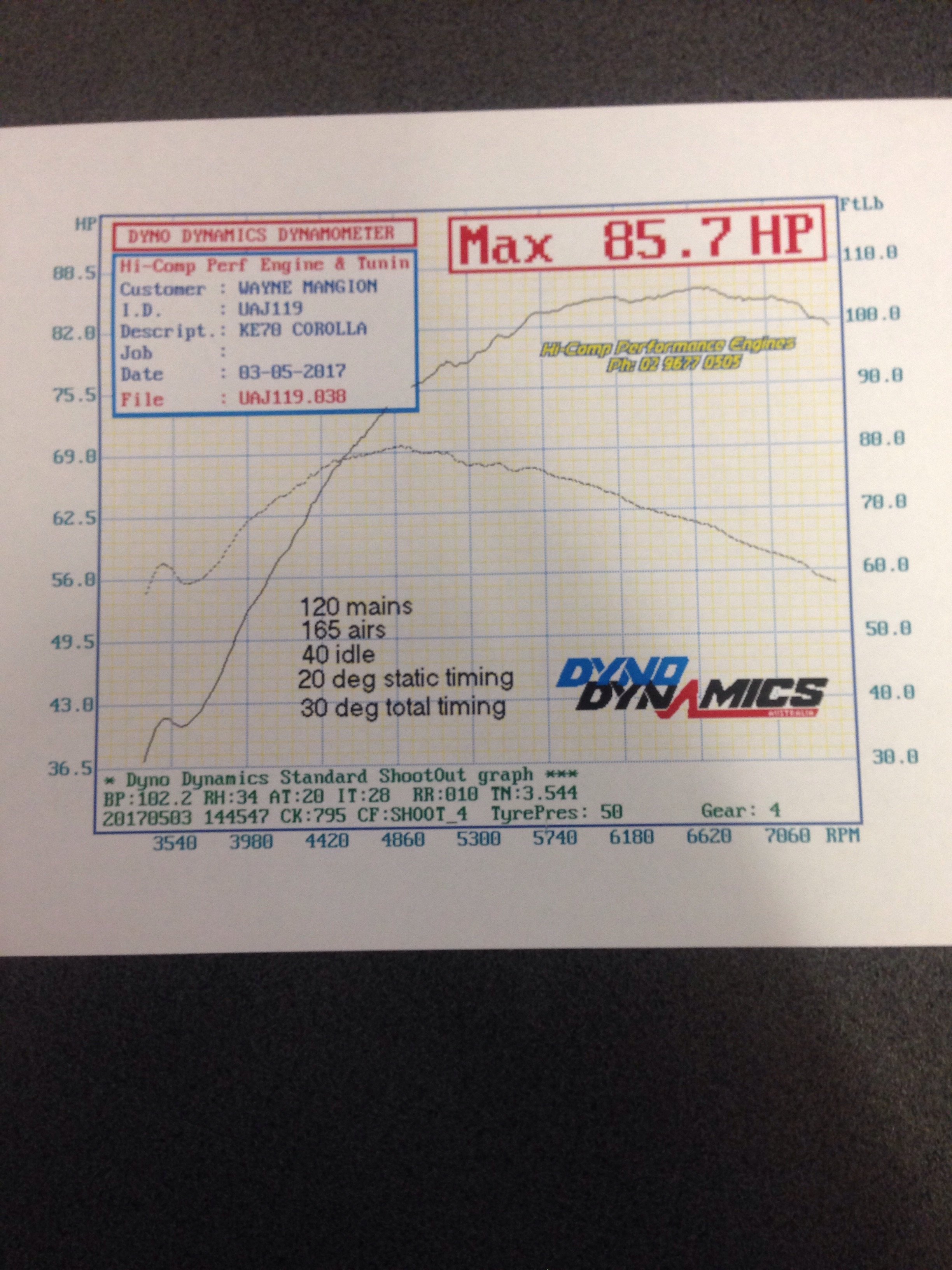

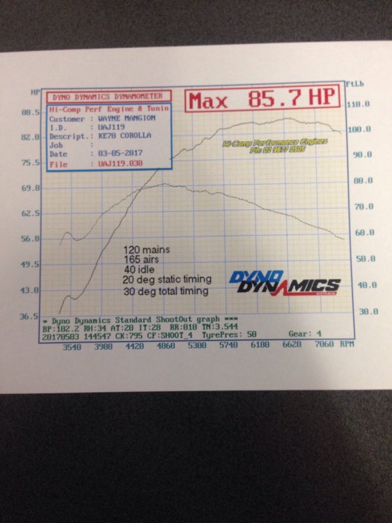

I just built a 4k for the track that is still streetable. Using a 3k big port head, it makes 84hp at the wheels and holds power to 7200rpm.
In hindsight, I should have built a 5k as the extra torque comes hassle free. For hillclimbs, you are going to want the low down torque. I would build a 5k or 7k. Just be mindful that the k series gearbox and diff might not like the torque of the 7k after a period of time, pending how you drive it.
By the way nice setup car mate, looks like a good buy
Edited by 7000rpm
244 degrees duration at .050" (288 advertised)
.453" valve lift.
nah, twin 45mm webers. 32/36 is too small for a track engine chasing power
