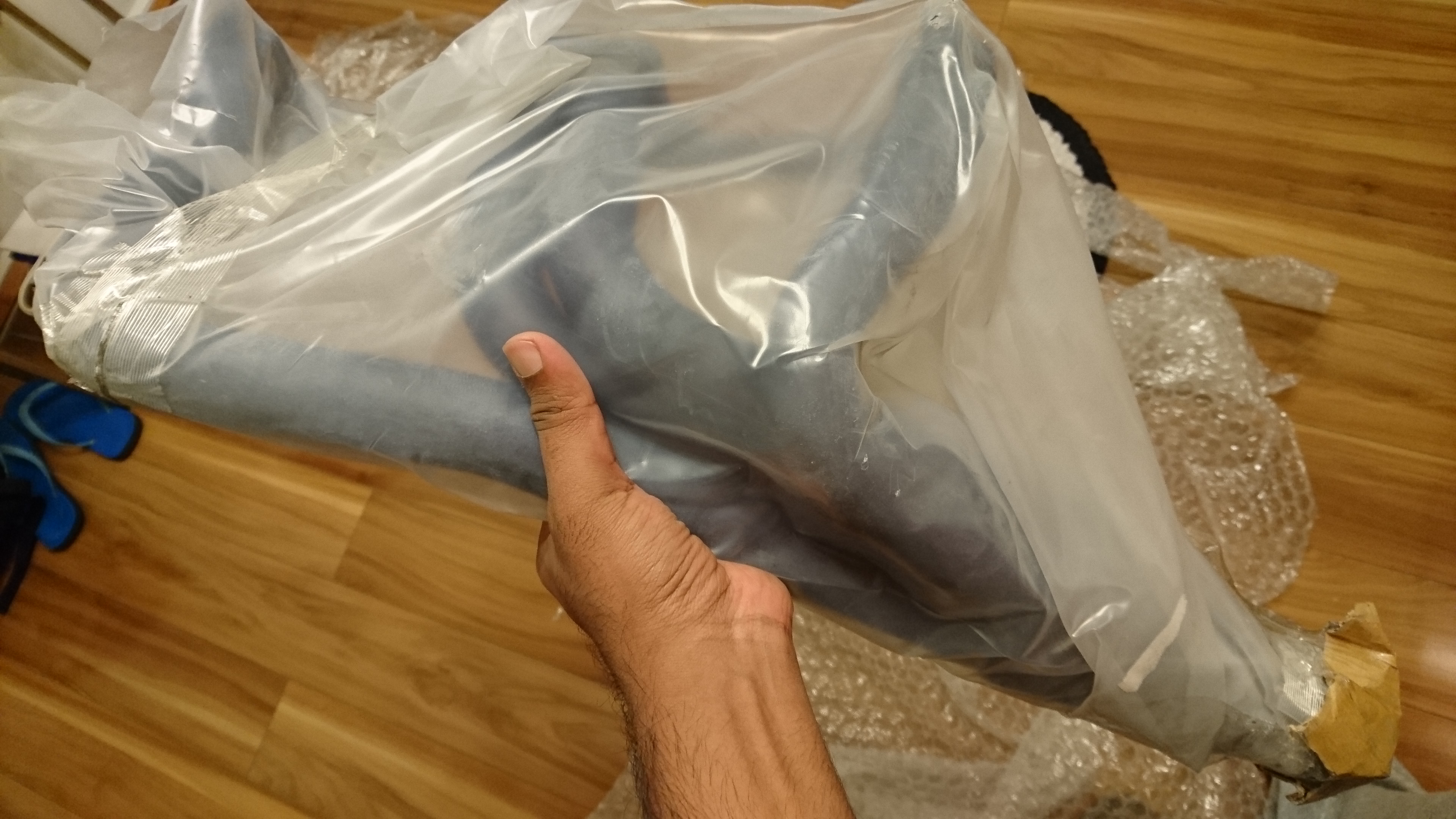

7000rpm Posted May 17, 2017 Report Posted May 17, 2017 Can you please post up a pic of the hurricanes? Have you measured the size of the primaries? Quote

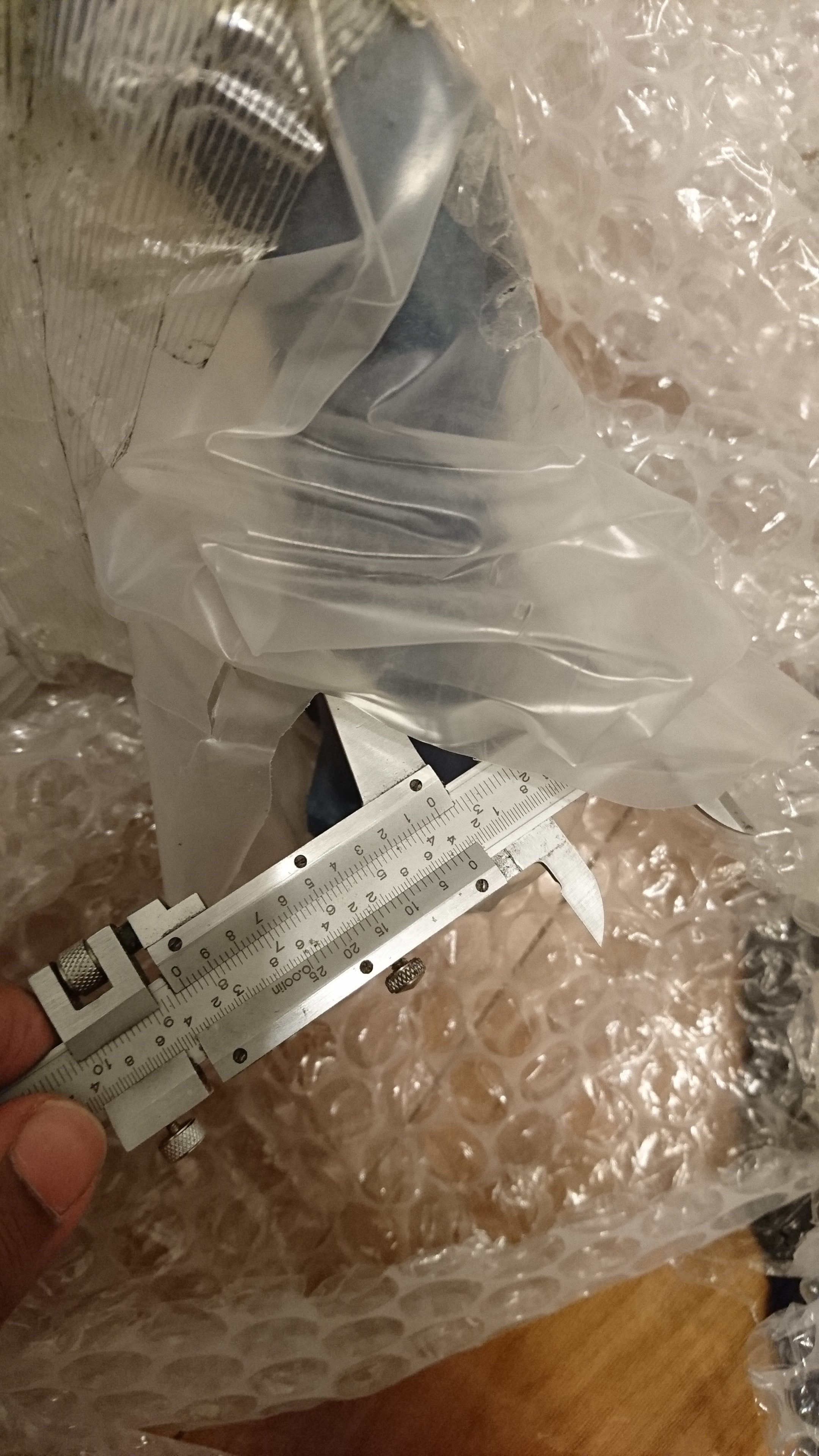

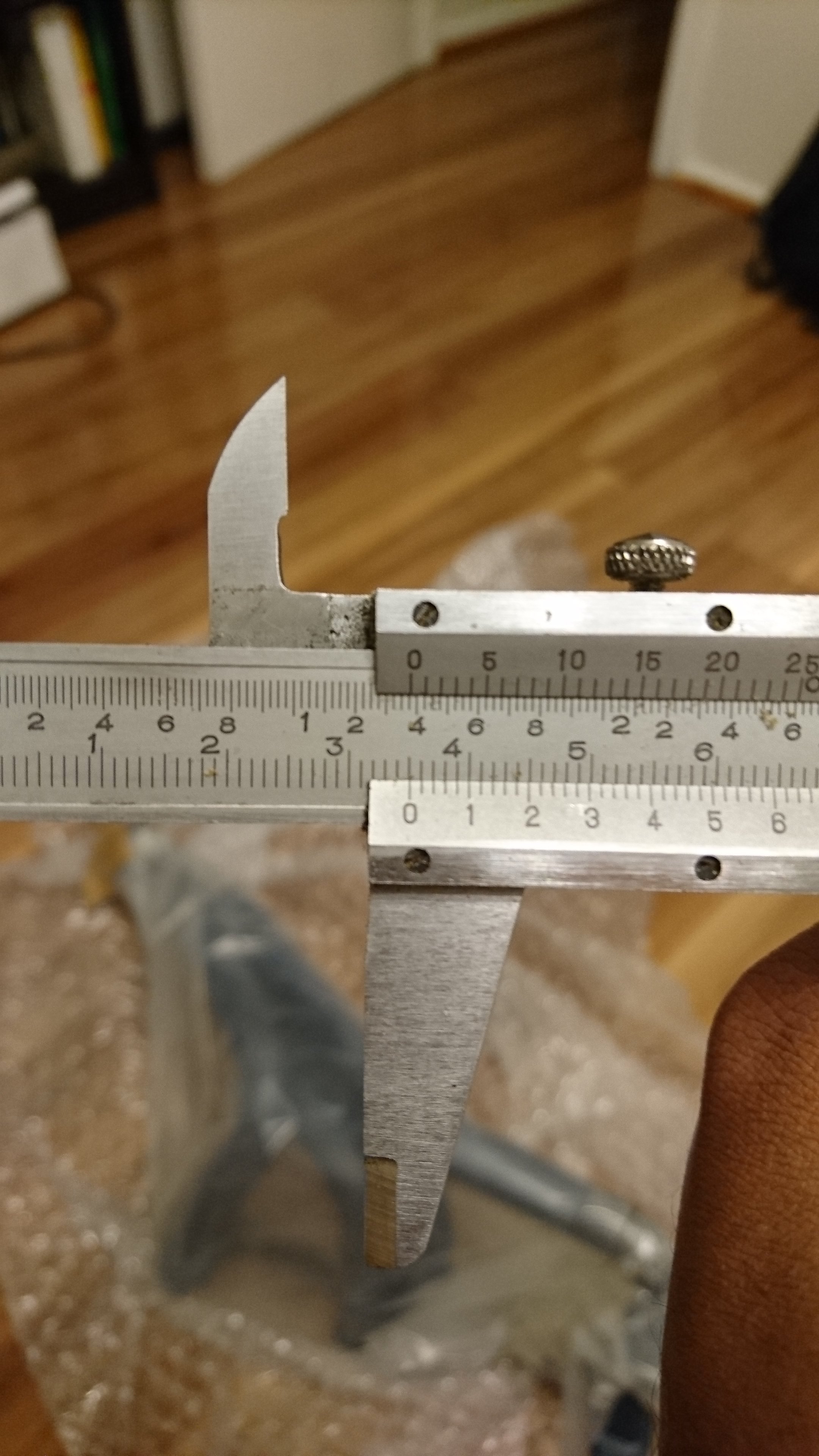

KaboomJohn111 Posted May 18, 2017 Author Report Posted May 18, 2017 (edited) 23 hours ago, 7000rpm said: Can you please post up a pic of the hurricanes? Have you measured the size of the primaries? Here are the headers...they won't be blue for long, taking them to modern plating in oakleigh to high temp stirling (chrome) coat them I measured the primaries where it just goes from square to round, so might no be best measurement, but was 35mm with the vernier calipers Actual listing (and assuming measured at around where my thumb is) states 38mm Here is a link to specshttp://www.hurricane.com.au/hurricane/products_main.php?txt1=Headers / Manifolds / Turbo Exhausts&txt2=Headers / Extractors&txt3=TOYOTA&txt4=COROLLA &txt5=4 CYL&lvl1=1&lvl2=5&lvl3=29&lvl4=169&lvl5=1694# and its part no. HU077ST Edited May 18, 2017 by KaboomJohn111 Quote
7000rpm Posted May 18, 2017 Report Posted May 18, 2017 (edited) Thanks John. Its a shame that most of these header supplier make uneven length 4 into 1 units for the k series. Due to the small capacity, I'm after 421 headers, same size primaries as the port. Looks like I am going to need to get a custom set made Edited May 18, 2017 by 7000rpm Quote
