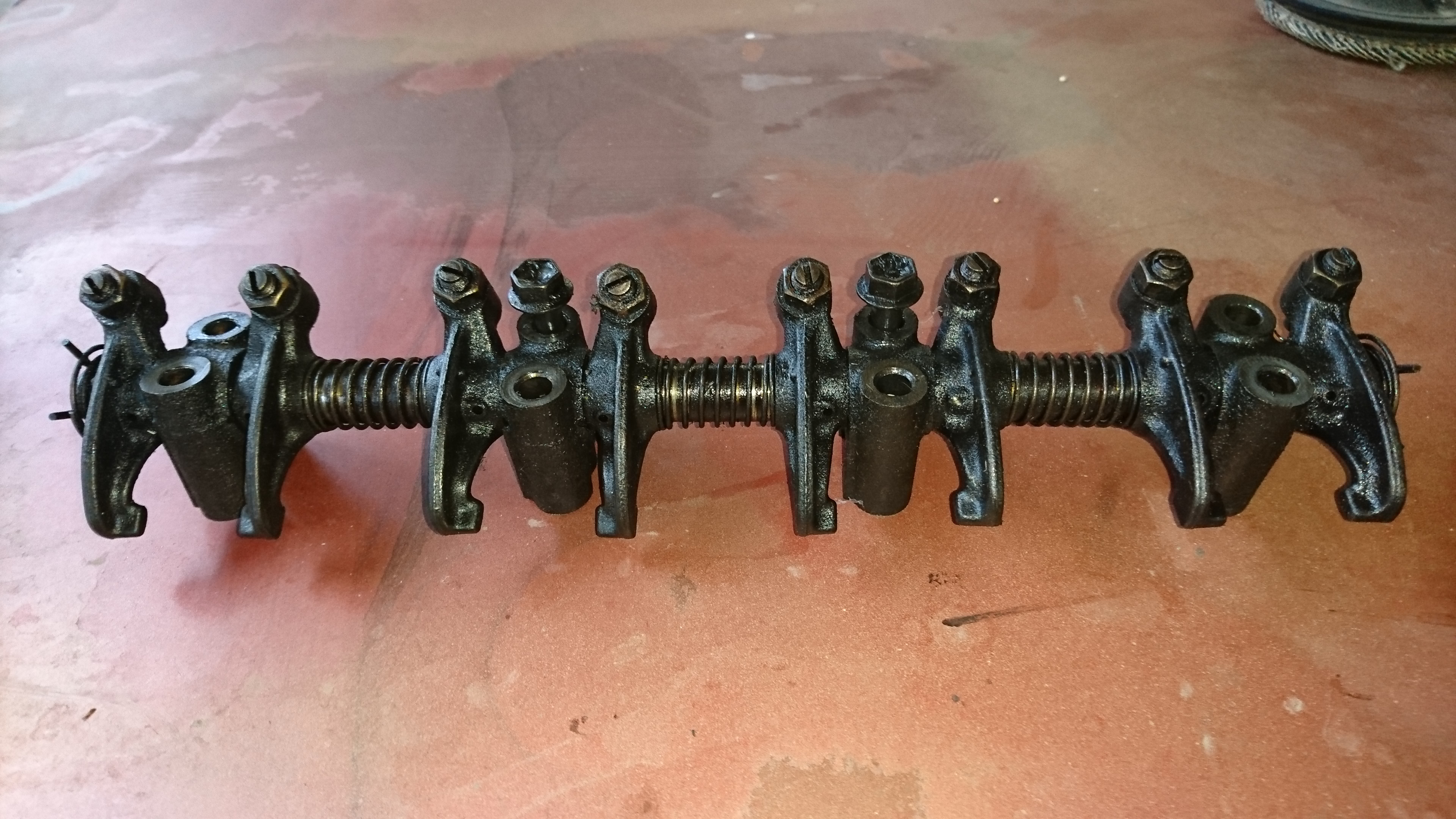

KaboomJohn111 Posted April 20, 2017 Author Report Posted April 20, 2017 (edited) I'll try upload some pictures of the rockers (I did notice adjusters on them) and (since I've never done it) couldn't the A15 series valves be cut/trimmed down I'll put pictures of the head and valve as my reason why i'm replacing them...I did expect something such as this when I paid $50 for a pulled down 5k on a pallet Edited May 7, 2017 by KaboomJohn111 add picture Quote
7000rpm Posted April 20, 2017 Report Posted April 20, 2017 (edited) When I was looking into this with Stewart wilkins and my machine shop, shortening the a15 valve didn't seem to be a good option. That's why we looked at the L Series. In the end, I was working to a budget and worked with of the stock ones. In hindsight, I should have just bought the a15 ones and chanced it. If your 5k has adjustment screws on the rockers, your in business Edited April 20, 2017 by 7000rpm Quote
KaboomJohn111 Posted April 21, 2017 Author Report Posted April 21, 2017 (edited) Well looks like i'm in luck with the rockers but I'm left wondering a few things because of it (I'll put up photos when I figure how to...stopped working since update) https://drive.google.com/file/d/0B098mboUw_dHRzJTVmkzTEl5WVk/view (should be a pic of rockers let me know if it works) Edited April 21, 2017 by KaboomJohn111 Quote

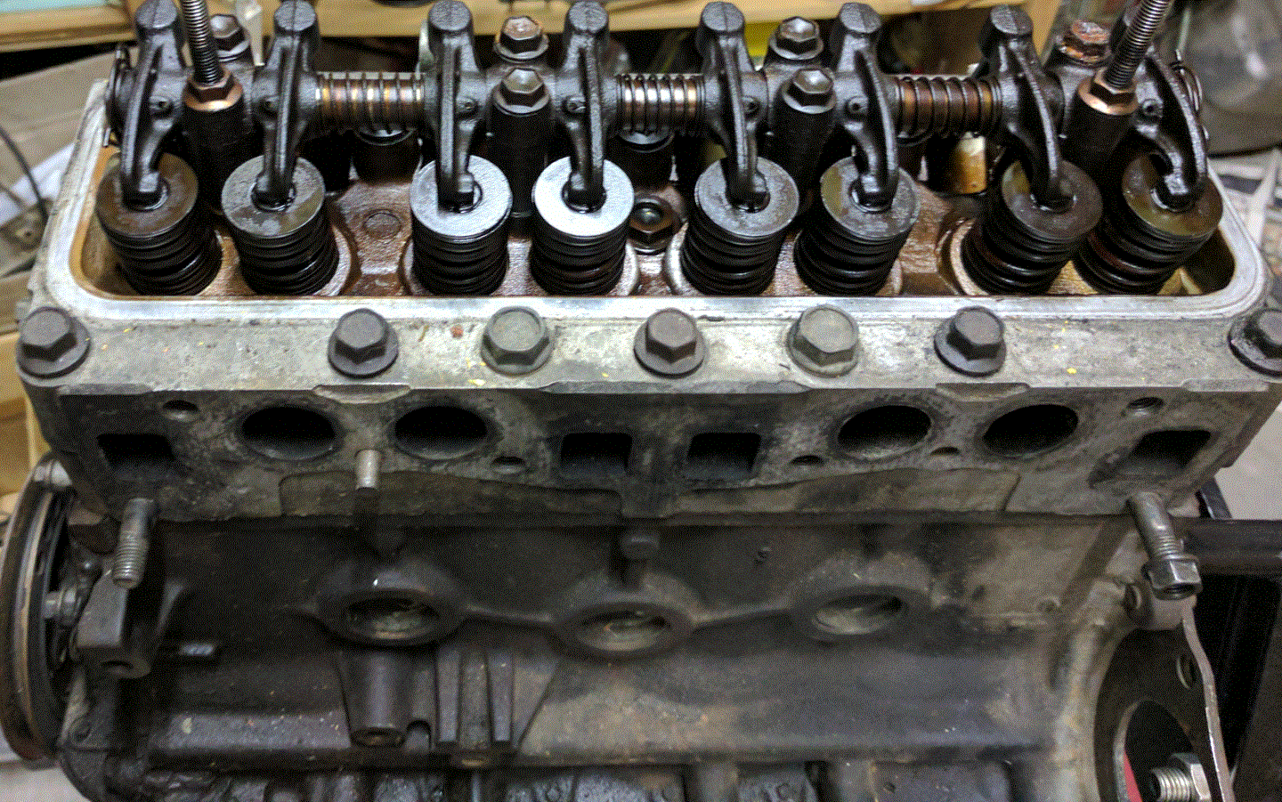

Ryan272 Posted April 25, 2017 Report Posted April 25, 2017 Hey mate, Re adding images, you should be able to select "choose files" at the bottom of the reply box - might be easier to do on a computer if you were trying to do it on your phone? I had trouble uploading a jpeg but it worked when I saved it as a .gif Perfect time for this thread to come up actually - I've just pulled apart my 5K to rebuild and was looking to do a lot of the stuff you've already been inquiring about. Have you sent your head off to Head 2 Head yet? and have you had any luck sourcing a good electronic dizzy and the timing chain from Romac? Would be keen to hear your findings as I'm looking to get work underway on mine ASAP. Here's a pic of my head, which doesn't have the adjustable rockers, FWIW. Quote

Ryan272 Posted April 26, 2017 Report Posted April 26, 2017 Did you resave the files in paint or something? Save as > .Gif ? Then "click to choose files" rather than drag and drop. So if you're going to go electronic dizzy are you going to get it recurved? Keen to hear the outcome of your chat to romac. I currently already have an em30 gasket so that's all good :) You can use washers on your bolts to pack them out to hold the engine on the stand if that's what you mean? Bolt --- washers --- engine stand/brace --- engine Quote
