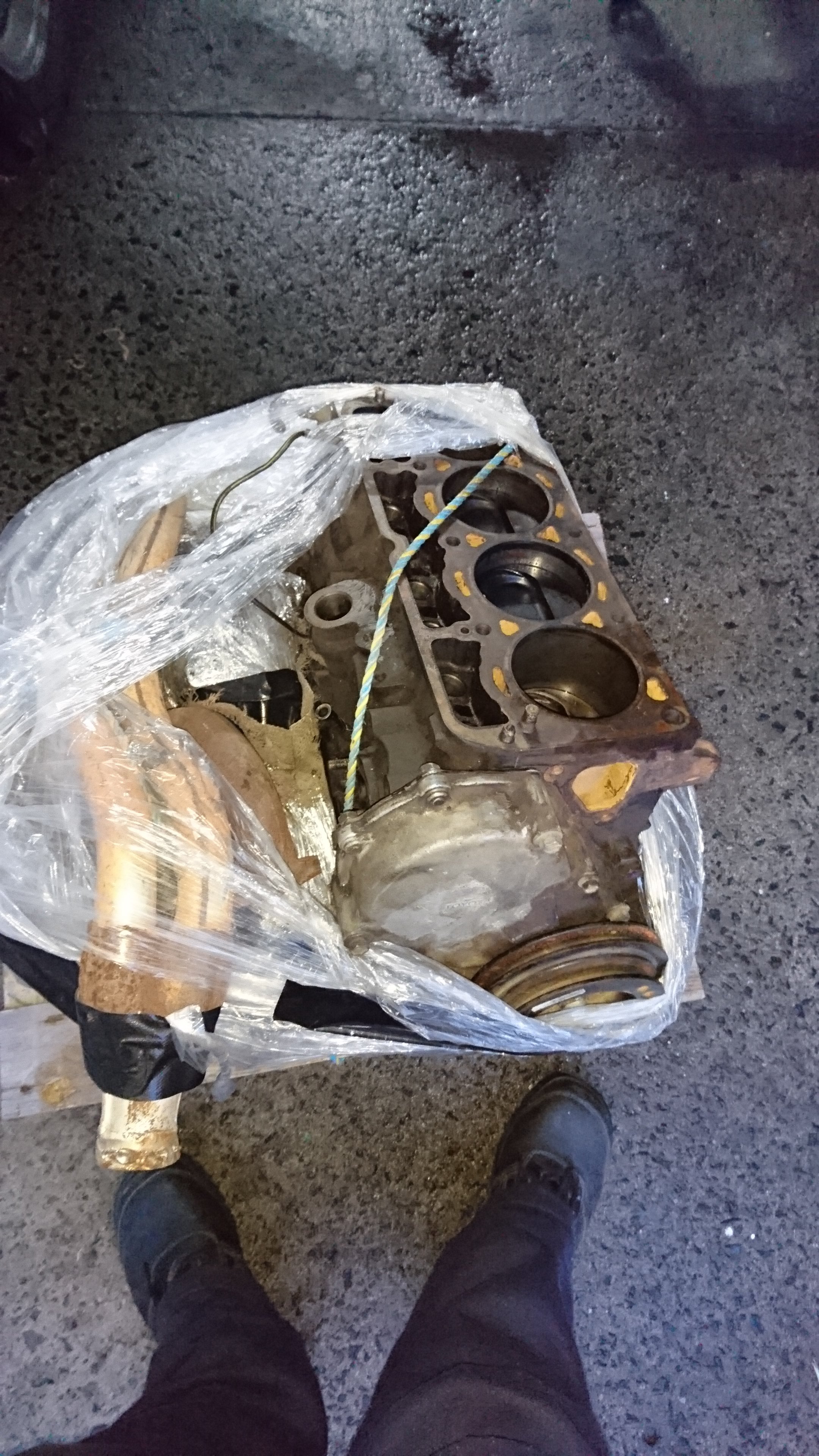

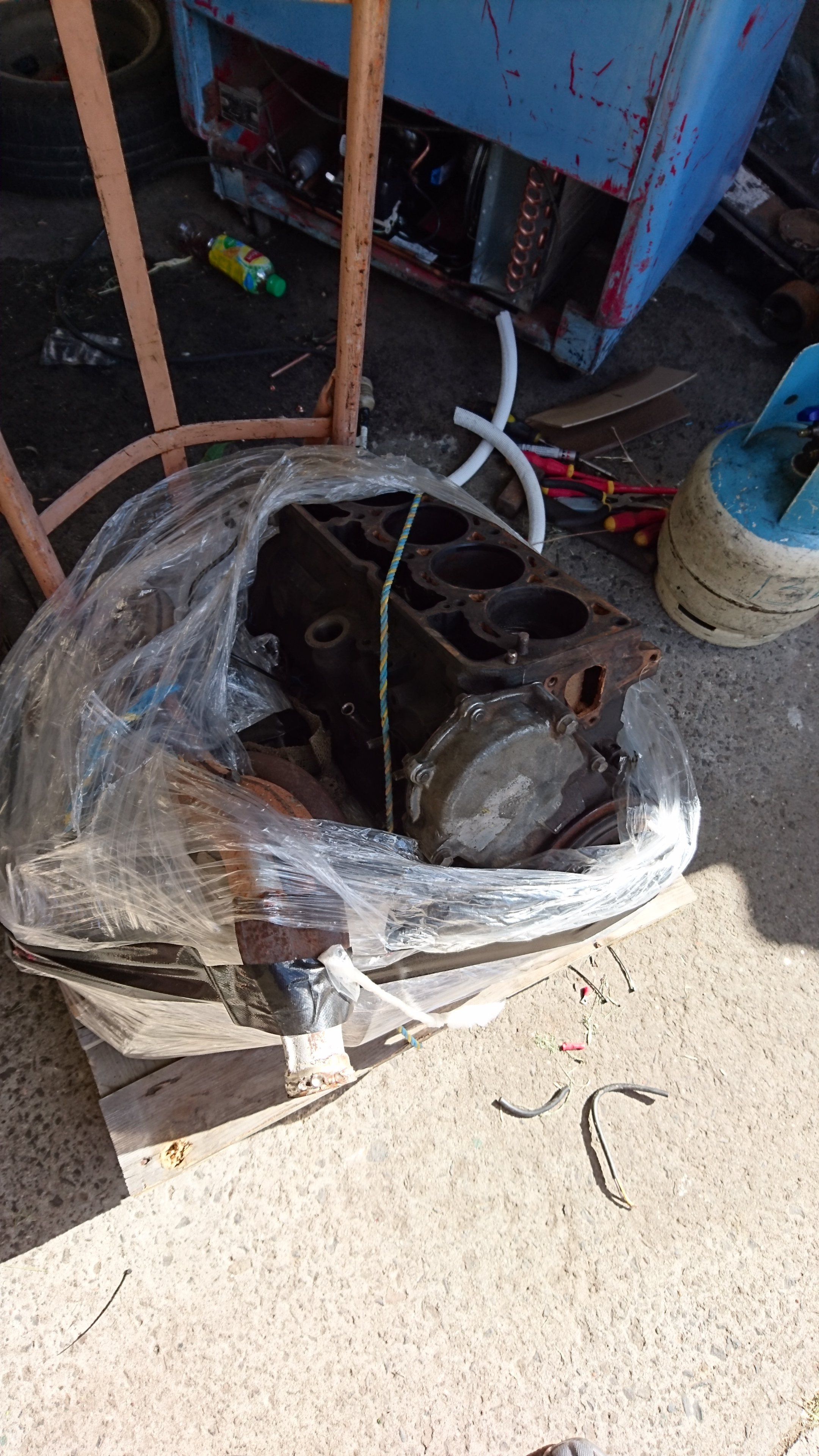

KaboomJohn111 Posted April 13, 2017 Author Report Posted April 13, 2017 (edited) Thanks 7000; for where to get some parts, But I did not find 40 thou oversize pistons, and ACL pistons are damn nearly impossible to find since (if I remember) they went out of business about 4-5 years ago I just asked about shot peening and knife edging because my own curiosity, I've been to car shows and I hear these term but being honest never knew what they meant so thanks for a bit of education Here is picture of the motor on pallet EDIT: Here is a picture of motor on pallet Edited May 7, 2017 by KaboomJohn111 Quote
