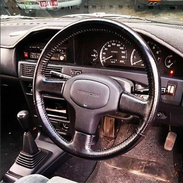

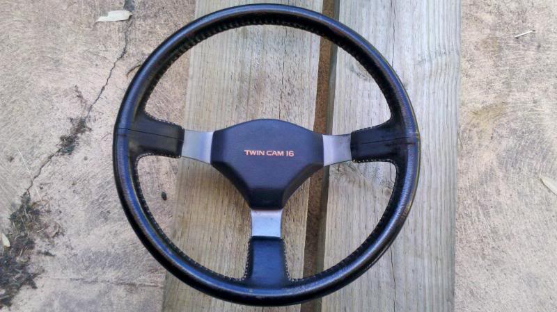

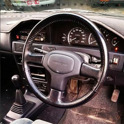

parrot Posted January 5, 2017 Report Posted January 5, 2017 Your best bet is probably an AE82 twin cam wheel. They are getting a little bit old now, but you can still find good ones without worn leather. Of course, you could always get a worn one recovered as long as the underlying rubber grip hasn't been damaged. Make sure it doesn't have any broken pins on the horn pad. This pulls off and is pushed back on. They come up for sale often enough, sometimes at ridiculous prices. Personally, I wouldn't pay more than say $150 for a good one with minimal wear. Quote

Hiro Protagonist Posted January 7, 2017 Report Posted January 7, 2017 Your best bet is probably an AE82 twin cam wheel. They are getting a little bit old now, but you can still find good ones without worn leather. Of course, you could always get a worn one recovered as long as the underlying rubber grip hasn't been damaged. Make sure it doesn't have any broken pins on the horn pad. This pulls off and is pushed back on. Got a mate who actually 3D-printed new horn-pad clips, seem to work well. He got my old ratty Twinky wheel that I had sitting around for ages, leather is completely gone though so that will get re-trimmed eventually. Quote
