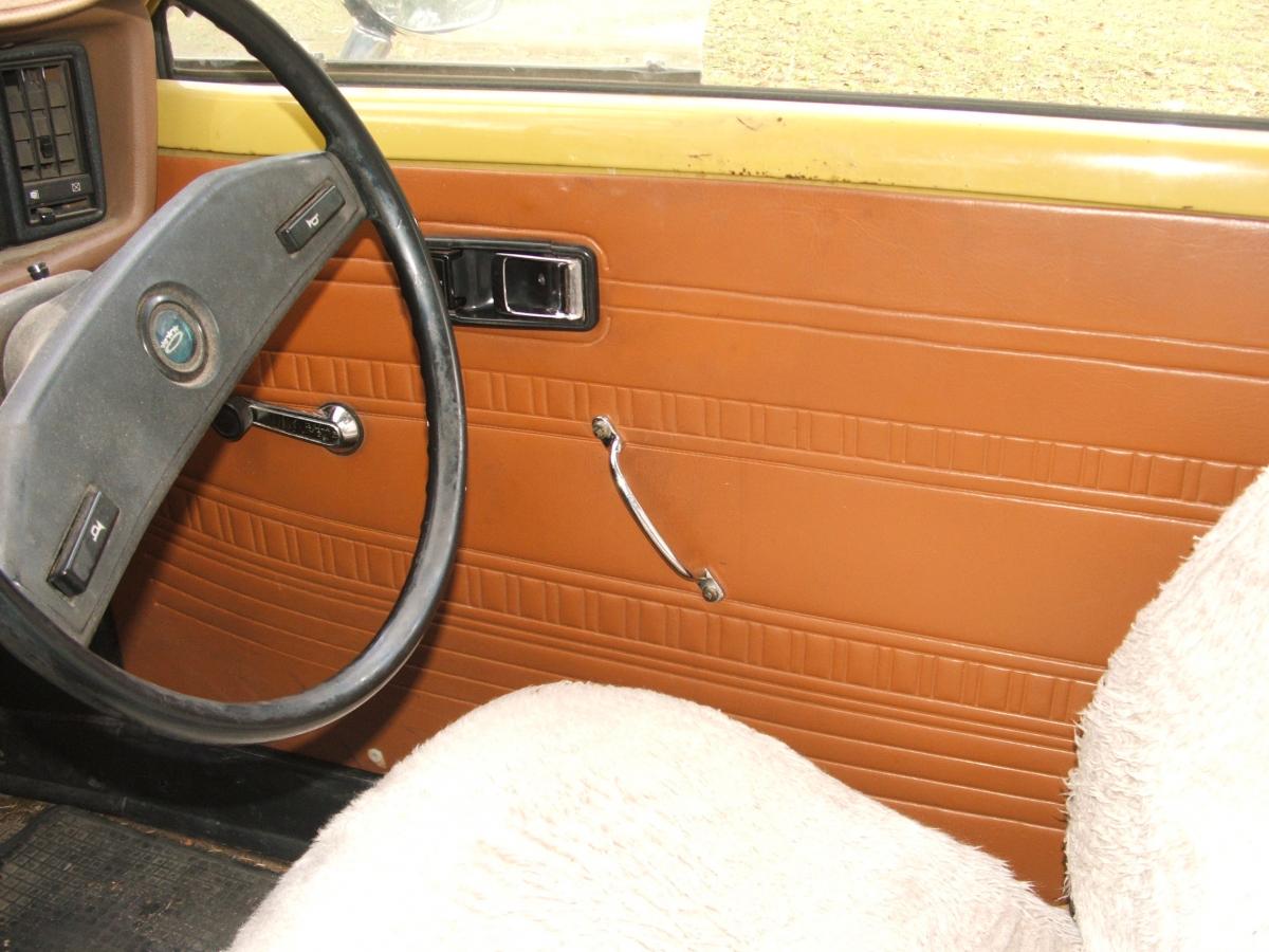

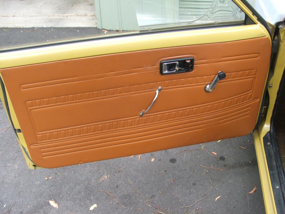

Welcome aboard ! Thanks for the pictures of your car. Lovely daily drive. They were pretty much a disaster, those early model Corolla door pulls. Plastic & just broke, specially on the 2 door Corollas. Mine was do different. The later model KE55s had an arm rest/door pull, which was much more substantial, and I even considered at fitting the KE55 arm rests to the KE30, but the mounting points were no where near the same.
I purchased a couple of reproduction/aftermarket door pulls, off ebay a couple of years ago, which were beige in colour, but they were ever worse that the original Toyota ones, & only lasted a couple of months.
Eventually, I found a couple of chromed metal door "kitchen" type door handles at the local hardware store, (Bunnings) with the exact same mounting point centres as the original door pulls.
I fitted these, and they are perfect, for this application, being strong, and look good.

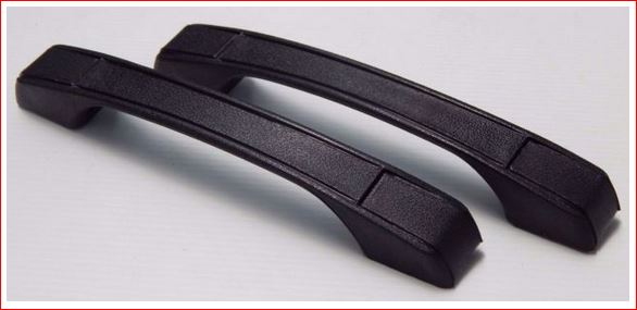

The original part number is 74811-12020-01 The last two numbers (01) signify the colour black.
A quick look on the parts buying service Amayama (google it - exceptionally good parts ordering service) suggests they MAY still be available genuine for about $USD11 plus shipping which through Amayama is generally modest.
https://www.amayama.com/en/search?region=152&q=74811-12020-01
I strongly recommend them. They can get parts (if still available) when your Toyota dealer is completely uninterested and doesn't even keep the part books anymore.
Give it a try, and let us know how you get on. If you need any other part numbers, let me know.
If you don't wish to use Amayama for some reason, googling the part number throws up many possible (and possibly useless) leads also.
