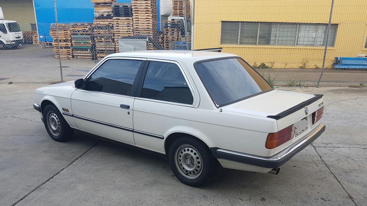

ke70dave Posted December 20, 2016 Author Report Posted December 20, 2016 Well another 3 weeks goes by! Up to almost 160,000kms. Record fuel economy of 10.8L/100km the other week. Not too bad for 100% suburban driving. Have put my old engine back together sort of and started laying out the engine loom. Plan is to get it done over the holidays. Ive been forces to take leave up to the 9th and the wife only has till the 2nd, so a whole week of free time to play video games, i mean work on the car! Been doing 12hr days for the lst 2 weeks which is gettig old, but still loads of fun driving to and from work. Heres a quick snap at 530am this morning in the work yard for fun. Being white you can't really tell how dirty it is! Quote
