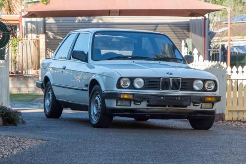

ke70dave Posted August 1, 2016 Author Report Posted August 1, 2016 (edited) Thanks mate I'll check it out. Got some number plates today!!! So I'll put them on when I get home and will take it for it's maiden voyage. Complete with holy exhaust. Edited August 1, 2016 by ke70dave Quote
ke70dave Posted August 1, 2016 Author Report Posted August 1, 2016 Success! Drives super nice. But man does it need the exhaust fixed! Quote
ke70dave Posted August 3, 2016 Author Report Posted August 3, 2016 Day 1 of driving started well, ended very poorly. At kilometer 51 of my journey, which was less than 2km from home. My timing belt snapped. Yes it is an interference engine. My nightmares will now be filled with the sounds of bending valves. Anyone got an engine crane I can borrow? Quote
