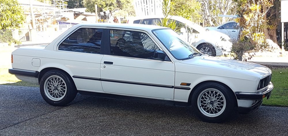

altezzaclub Posted January 6, 2021 Report Posted January 6, 2021 That last photo looks great! I'd say that's a perfect ride height. Quote
ke70dave Posted January 6, 2021 Author Report Posted January 6, 2021 (edited) Thanks! photo is just taken on the phone of all things. but bit of christmas lights there makes it look pretty good. I bought a new Mic for the DSLR and did a bit of night testing a few months back. Not the most exciting video but gives an idea of the sound of the mighty 2.3L 6cr but perhaps i should make some more videos.... https://youtu.be/EdDi6myfYfk And For the first time in a while i have another update only 1 day after my last one. took the bonnet off last night to fix some dents that i have been meaning to fix for approximately......3 years. got a can of color matched paint done up and i sprayed some on the paper there and it looks close enough to me. Better than dents anyway.... I started bashing the dents last night but got in trouble for waking the kids. So ill see if i can get some bashing in before they go to bed tonight.... One of these days id like to get the whole car painted professionally, but that's going to have to until i have a spare $5k or so...so might be some time. Edited January 6, 2021 by ke70dave Quote
