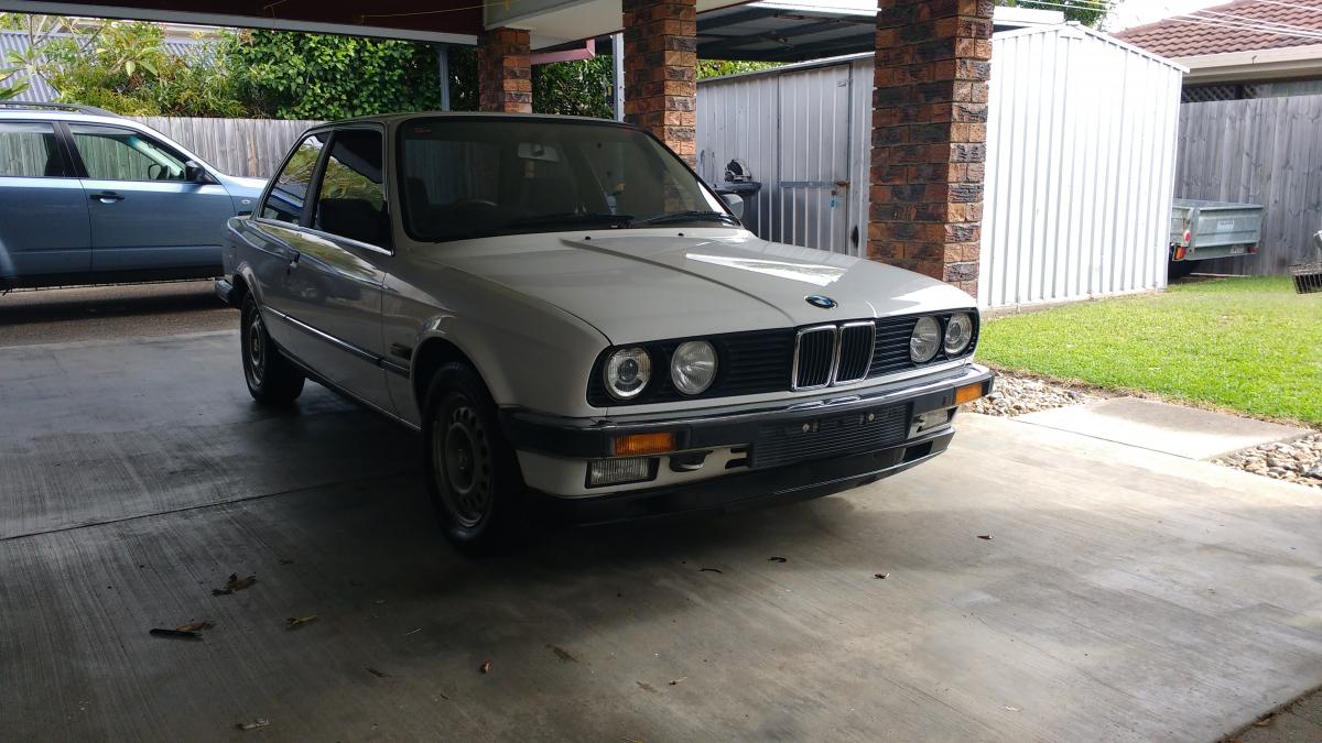

Well after coming back from Canada a few months ago i was on the hunt for a new project car.
After i sold my ke70 in about 2011 (damn that is like 5yrs ago...) I had a WRX, and S15 and a suzuki sierra.
I really wanted the ke70 feeling again, small car RWD, old school cool.
But i wanted a more modern version perhaps, and something with a bit of power out of the box...
So last weekend i bought a 1985 323i e30 coupe with 156,000kms on the clock. I think the kms are real based on exterior condition but everything is still 31yrs old so it needs some work thats for sure.
I chose this particular car because it has no rust, paint is pretty good, body is very straight and the interior is very nice for the age. It has been sitting for around 12mths unregistered so i got it for quite a good price.
Unfortunately the car was not running great when i got it. Dizzy cap, rotor, spark plugs and draining the fuel tank seems to have made a significant improvement, but it still idles a bit funny. I have driven it up the street a bit and it seems to drive ok.
The BMW of this era run a fairly crude efi system. It has a regular distributor with vacuum advance and then an airflow meter and a few sensors that run an analogue (!!!) ecu to run the injectors. Idle control is taken care of by a sophisticated mess of vacuum lines and actuators.
Unfortunately it seems that someone has made a fairly poor attempt at repairing the vacuum lines and i am currently studying diagrams in order to put it back to how it is supposed to be, with hopefully some simplification along the way.
The car is auto but i have purchased complete manual conversion "kit" from a guy parting out a car. I just need to buy a new clutch, machine flywheel and some bushes before fitting it.
As for plans for the car, I aim to clean it up, convert it to manual before registering it. Then track down an LSD, some shocks and springs and some sticky tyres.
I'll see how the oem electronics goes but i have a haltech e8 here that i will probably install to control the fuel. I just need to buy a wideband. I don't put too much faith in the fuel economy of this thing and the cost of replacing sensors is probably higher than getting the haltech running.
I have purchased some oem tail lights as well as some series 2 projector headlights. I just need to sort out the wiring plugs for the headlights.
Oh and it has AC that is pretty cold!
Anyway let me know what you think. Apologies the interior shot didn't turn out great.

That's cool mate. :2thumbs: One thing about e30s, they usually have had a better class of owner over the years and compared to a ke70 of the same age it would generally be better condition. Two door 323 not super common either. Most 2 doors you see are 318 and most 323s are 4 doors. Its super clean I really like it.
Big aftermarket for these, you can get brake kits, aero lots of motor options, nice interiors from Is models and factory aero bits from the Is as well, but its so clean, its great as it is.

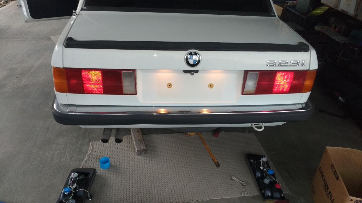

OEM tail lights!
