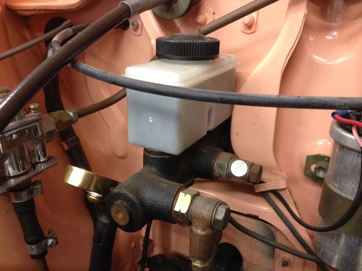

This is a Mazda rx4 cylinder on my 10.
The cylinder bore hole in the firewall needed to be enlarged, the mounting bolt hole on the cylinder
needed to be elongated and new brake lines were made to suit the dual circuit set up.
The pushrod from memory was long enough to get adjustment.
Overall a fairly easy swap and excellent upgrade, I do run a disc brake front though.
